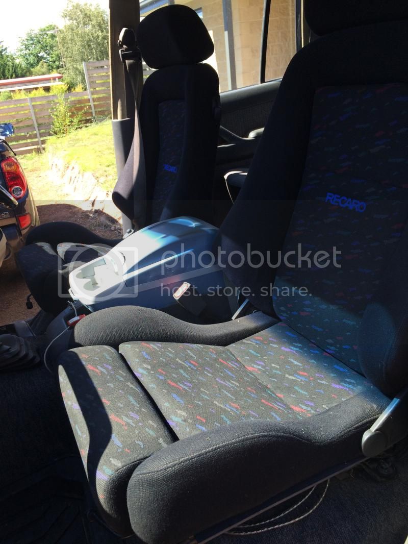

I modified my standard base and put these recaros in
Which Recaros are those? Where did you find them? Any other details?
Thanks for sharing. Tho a bit hard to see the seat under all the bags and machete : )
Here you go
They also fit a booster seat for my kids

That's it.
nice - thanks for the photos! so do you feel they are much more comfortable than stock? I'm looking for comfort / ergo. used Recaros are at the top of the list, but I'd consider these if they survive the road trip test
Yes more ergonomic but can't say much for the comfort level as My stock seats had seen better days.
My trip was 8 hrs going and 8 hrs back all done in 24hrs. Was fine and firm. But solid. I'm about 170 cm short and around 75 kg. they fit me like a glove.
