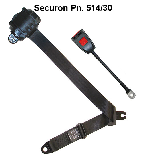

I bought from Securon. I liked that I could adjust the angle of the retractor and still have it lock in the event of a roll over. The retractor is angle as well as inertia sensitive and there are 2 dials on the retractor which are used to set the angle at which the retractor freely spools out which is a great feature if you want to mount the retractor at an odd angle. Any combination of cable stalk/ loop end etc as well as various lengths are available. In my case I bought 4 point belts for the kids in the rear but measure your stock units and compare (all specs available on the following link) also all new hardware including angle brackets was included. ]I liked how professional the company seemed in terms of their focus on safety and when I had an issue they took care of it right away at their expense. Worth the shipping costs!
