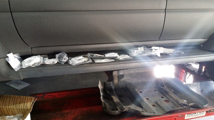

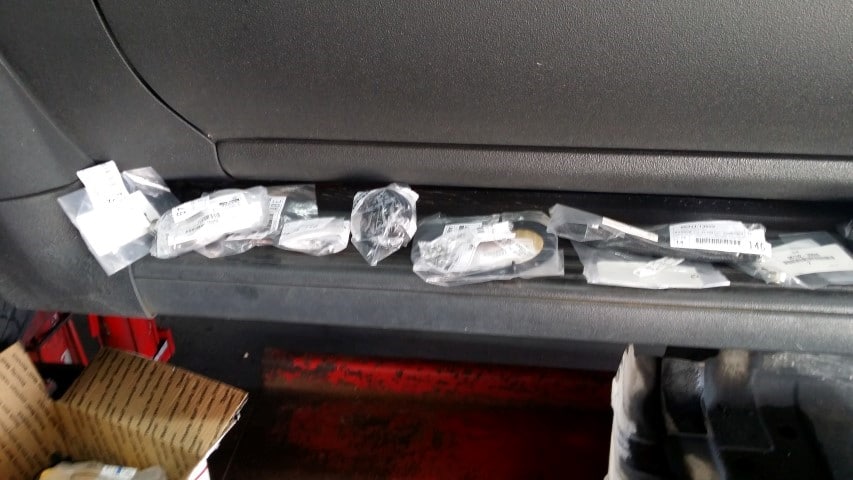

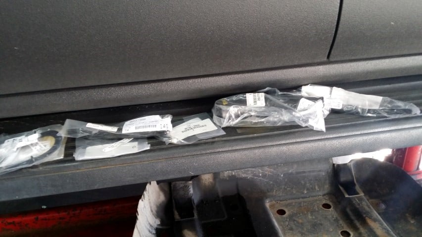

BEFORE I changed my tank, I also changed my vapor canister and hoses. Then when I got the replacement tank ready, I coated it with POR15, installed all new gaskets (buy new hoses from Toyota too....the straight hose does NOT work...it kinks (fuel fill hose) and also buy the replacement high pressure hoses.
Then spray the INSIDE of the hoses and the OUTSIDE of the hard pipes with White Lithium grease (it won't degrade rubber like PB blaster)

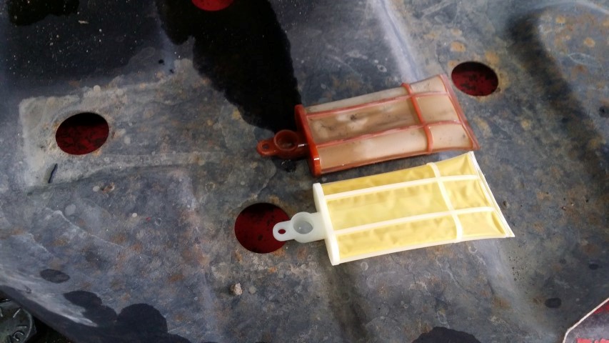

Install a new pump screen, hose, and clip at the same time. Mine turned out to be clean as a whistle when I took it out, so I reused it as-is.

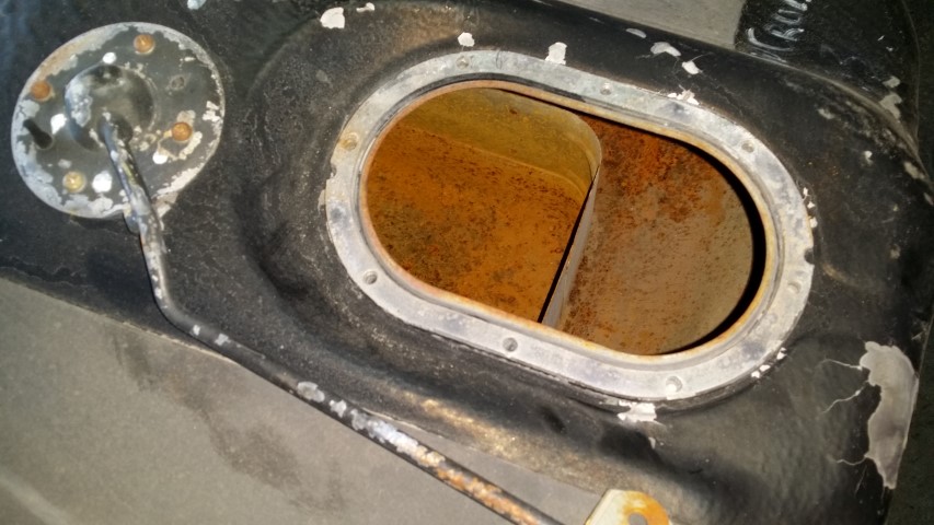

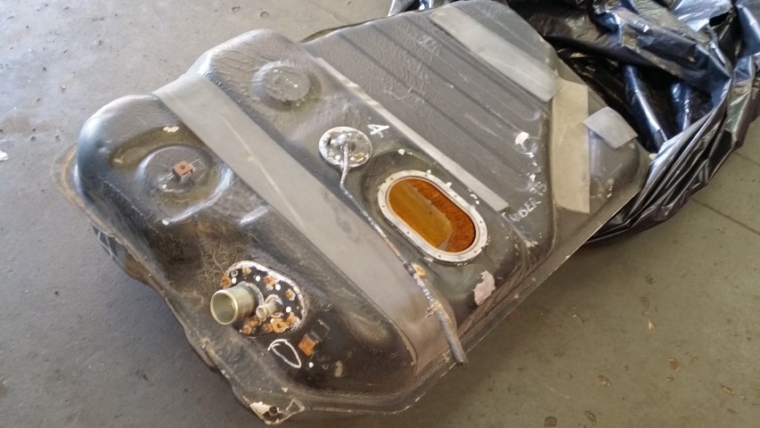

The inside, however, was filled with rusty dust (so much for being A grade) :rolleyes:
I took it anyways and figured I can just send it out to my local radiator shop and have it boiled :idea:
They suggested lining it with Red-Kote after a thorough cleaning :oops:
Now, I've used similar liners on motorcycle tanks and racing fuel cells with good results, but I've never done it to a tank with internal baffles :hmm:
Kinda worried about the coating getting to all the nooks and crannies :doh:

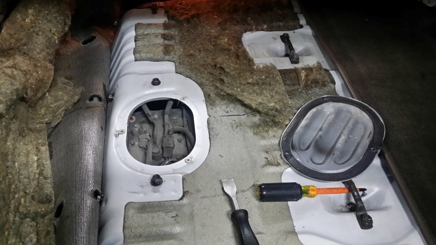

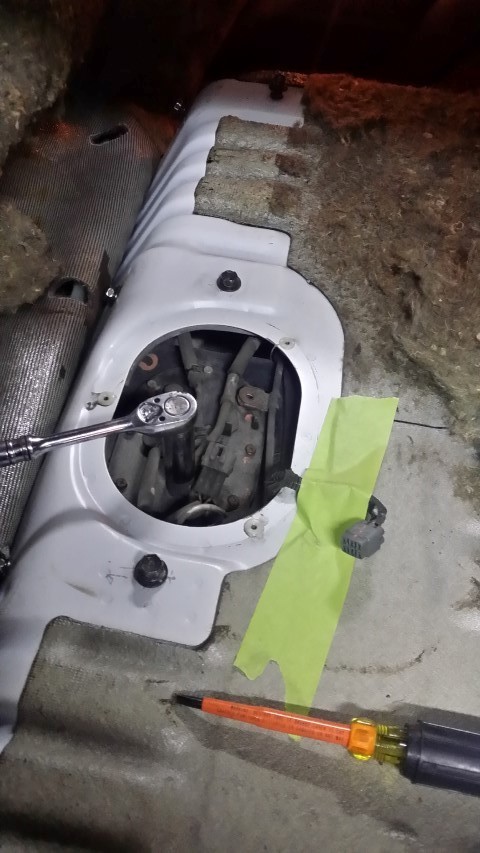

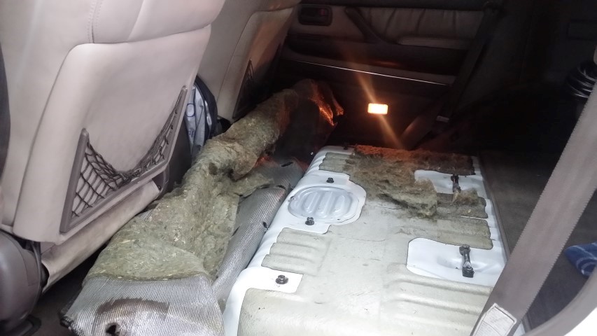

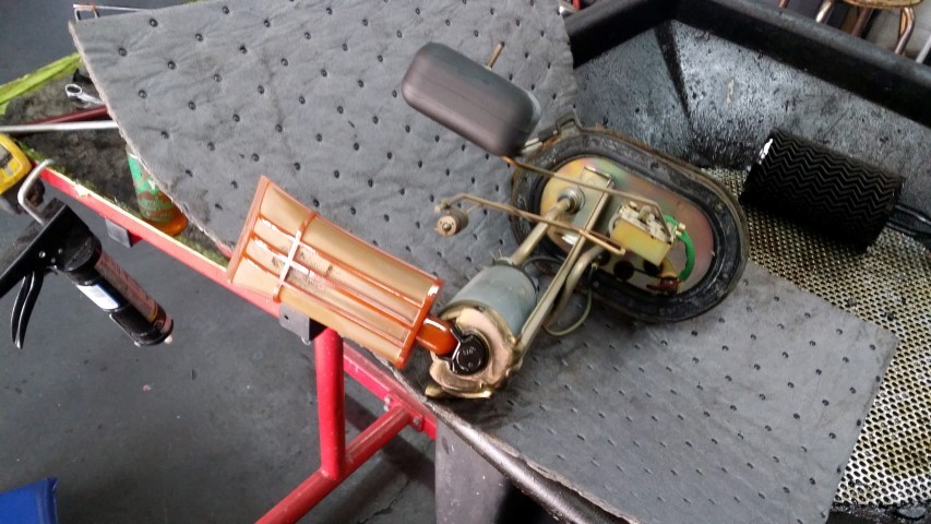

Anyhoo, I finally got a chance to throw it in today :cool:
(Rusty junkyard tank before)
I actually took a sh!t ton of photos, but my stupid phone only saved these :bang:
No more leaks, no more smell :)
