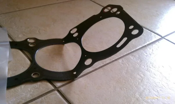

Parts made it here!
Of course FedEx screwed up the headgasket!

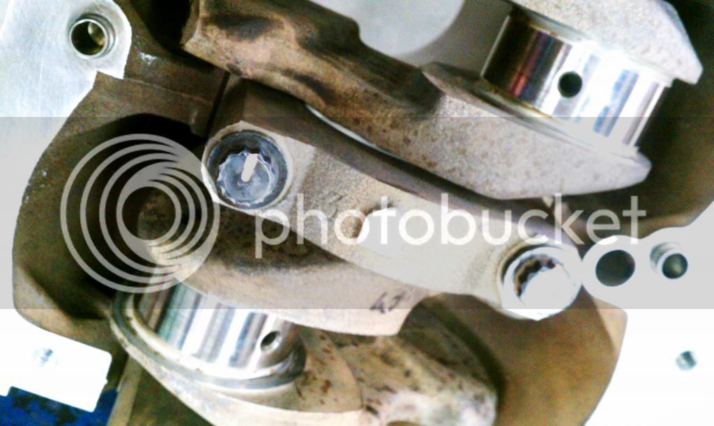

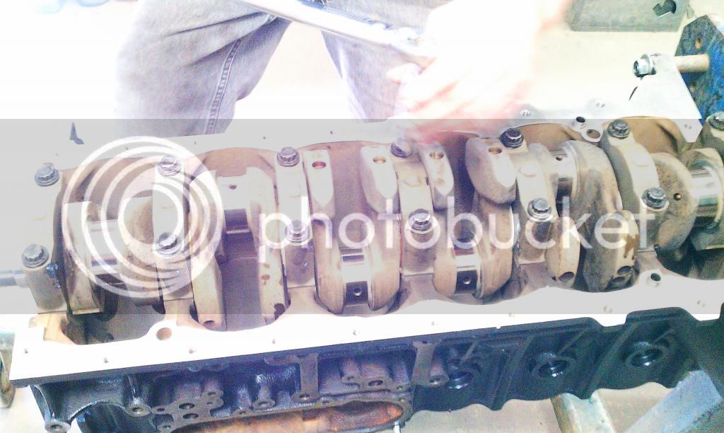

Made a little progress. Ordered the wrong rings so that slowed us down. The ones listed on Beno's list stated 1mm oversized and since we didn't have to bore the block I ordered what I had found as the stock size rings. Wrong, ordered 3FE rings. Anyway, we got the block honed, plateau honed and cleaned REALLY good. Assembled the crank bearings and installed all the caps.
Torqued them down and turned them 90 degees

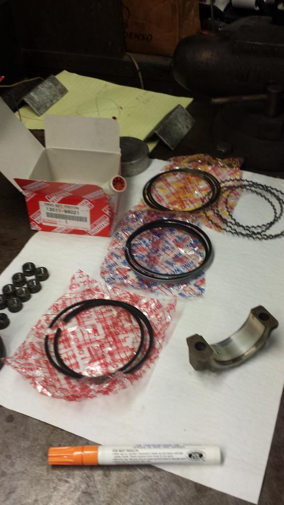

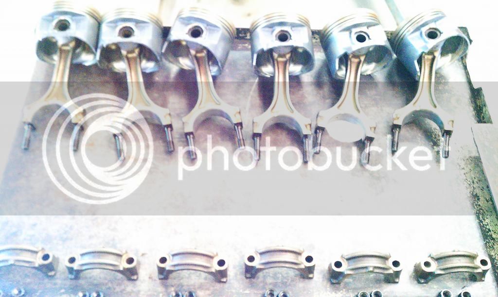

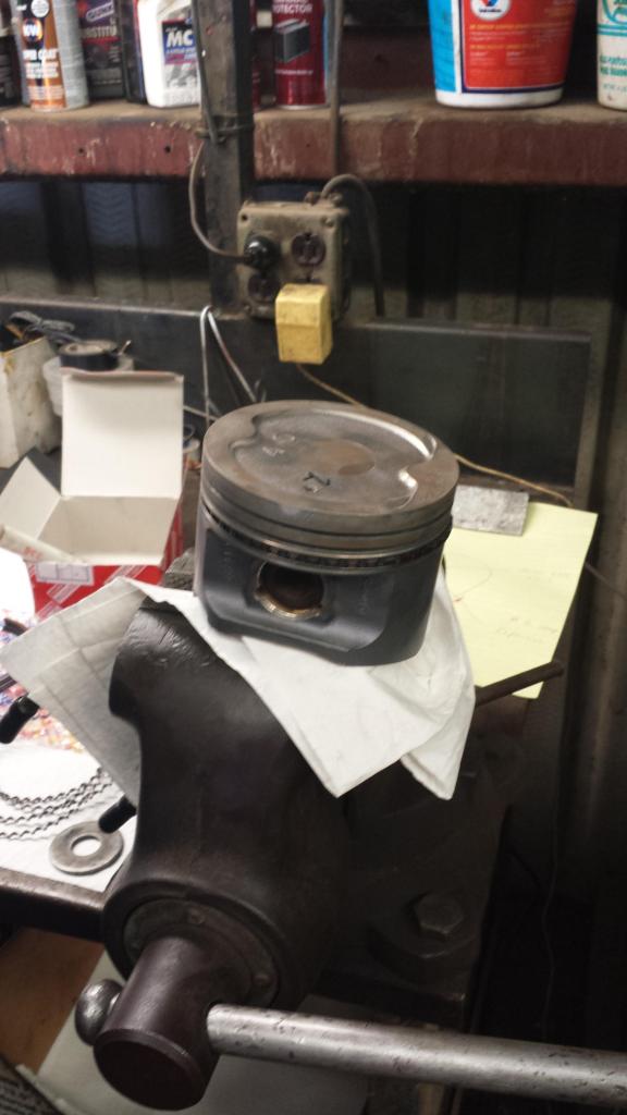

Got the pistons all ready to put the rings on after a quick text to Delancy for a link to the FSM since I had left mine at home. . Notice the handy piston holder!

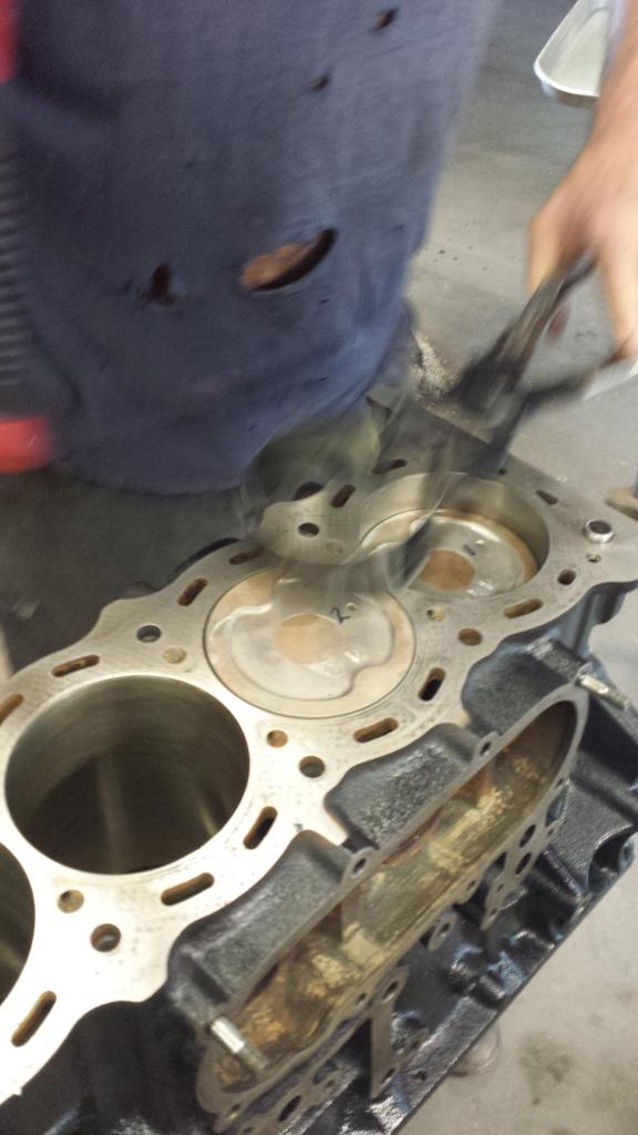

And Stuart started popping them in

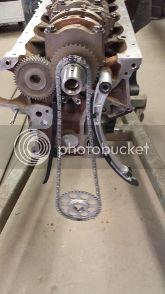

Timing chain, gears, CSP ring, damper, and guide went on next

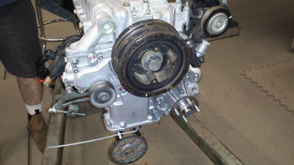

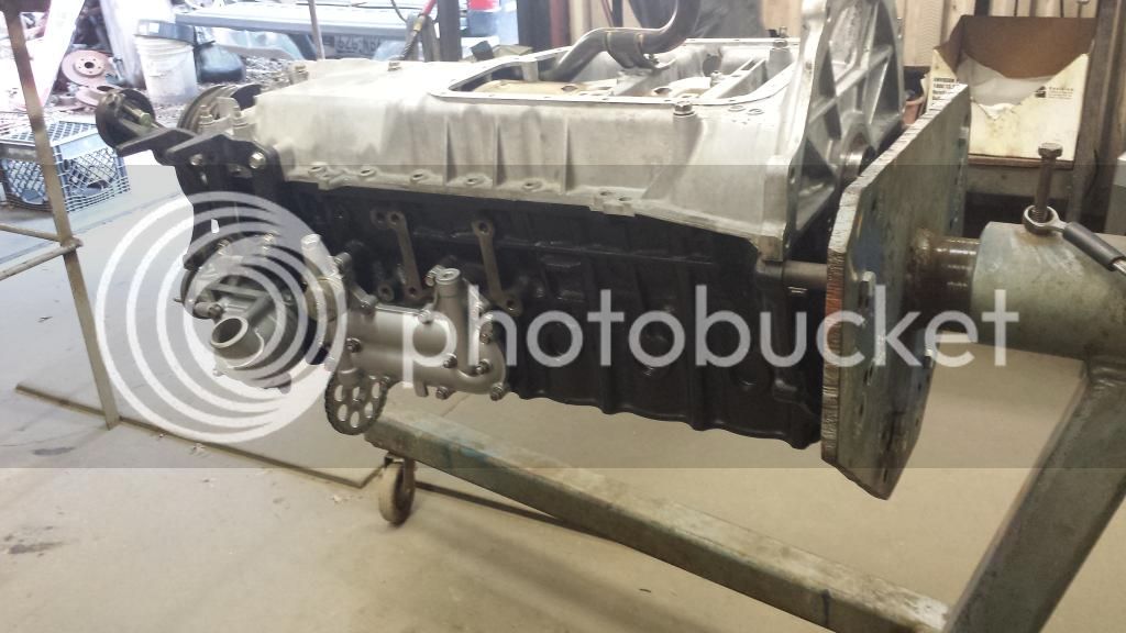

Front timing cover, balancer, and some of the brackets, water pump and oil pump and cooler next

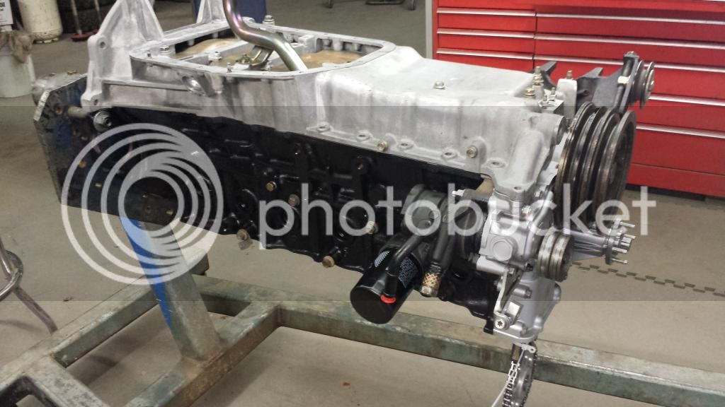

And here's where we ended up
