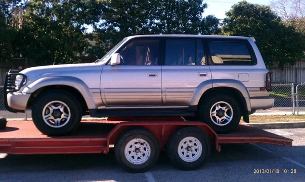

After looking it over really well at the fire station today I have come up with a list of things to fix:
7 pin mod and Add CDL switch - will order Monday
Wiper fluid diverter - will order Monday
Passenger seat fore and aft not working - ordered parts from Gamivivti
Need replacement center console - talking to a guy in Tulsa about one. Maybe someone (cough: Delancy: cough) can help out .
Other than these few things and a good cleaning of the headliner and a detail job, that's it. Well, and then there's that whole engine swap thing. Will retrieve it sometime this month.
Oh, and I found the factory tool tray with tools and the first aid kit. Does the tool tray have some type of cover?
Console and a hazard switch are on the way thanks to Andhop72 and Delancy. You guys rock!! Going to steam clean the engine and engine compartment this afternoon in prep for pulling the engine. ( and work on the zipline for my 10 yoa Bailey!
Are you guys talking about me? I thought I heard "some guy in Tulsa" it will be good to finally meet you Delancy looks like I should have taken that trip to Clayton and I would have met all you guys.
It was a fun trip. Lexie (as the girls have named her) got a very thorough steam cleaning under the hood this afternoon and is now prepped for pulling the engine. On all of the cars that I have worked on in the past, I have found that steam cleaning before I pull a head or engine makes it so much nicer to work on. I'll pull the engine and then steam clean the bay and the engine again while it is out and before I start swapping parts onto the 94 engine. Also cleaned the knuckles while I had the steam cleaner out! Thanks for all the help and info guys!
