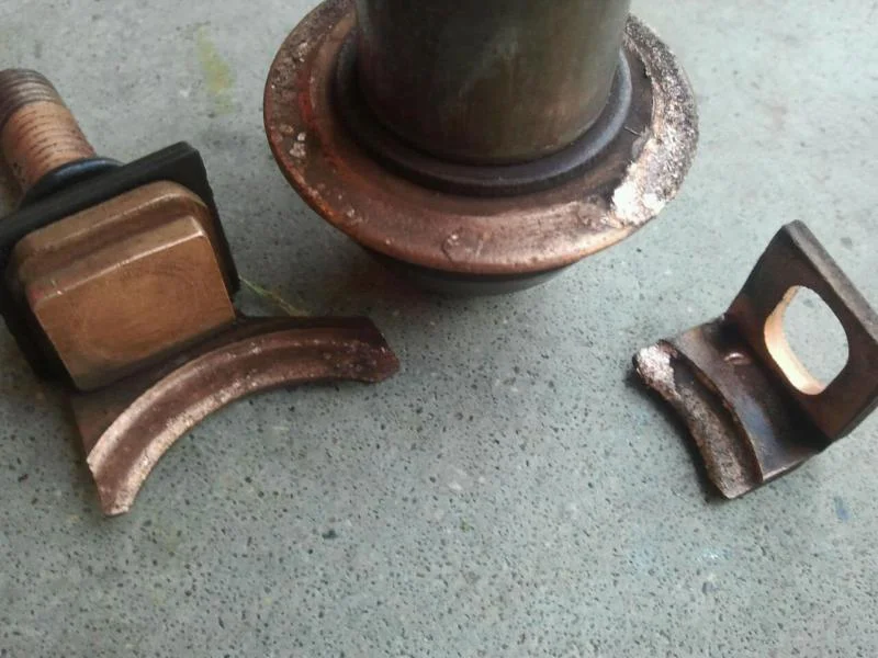

Starter Contacts & Plunger are the working parts of the solenoid that is attached to the body of the starter. All Series 80 have basically the same setup but there are three different models of starters, 1.4KW, 2.0KW or 2.2 KW. Most likely yours is a 2.0 KW. You can search the forum for pictures.
@FredZ
Have you removed it and looked inside?
I replaced my plunger and contacts very easily for about 60 bucks.
Works like a champ.
Pic is of the old plunger and contacts. Pretty worn.
