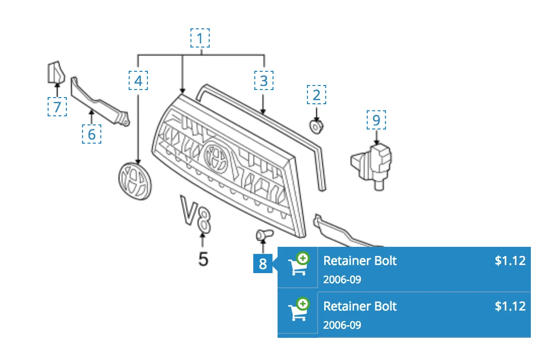

These bolts come in many lengths, anywhere from 16mm to 60mm. To narrow down the common ones, I visited a Toyota dealer website to get the specifics on the bolt length, but when visiting the specific bolt page there is no information on the bolt itself (top shape, thread or length). Just a cryptic part number.
Does any website have both the part and the bolt specifics?
