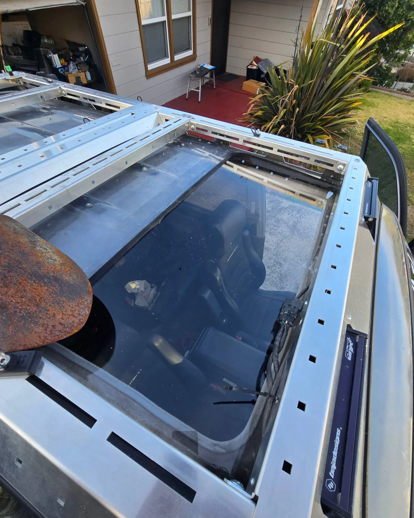

So it looks like you have a sun roof, but when you pull the cover back, you can keep stuff up there. Maybe it's a dumb idea lol
In theory it’s a sound idea. Just have to figure out how to keep it all from falling down on you when you open the cover.

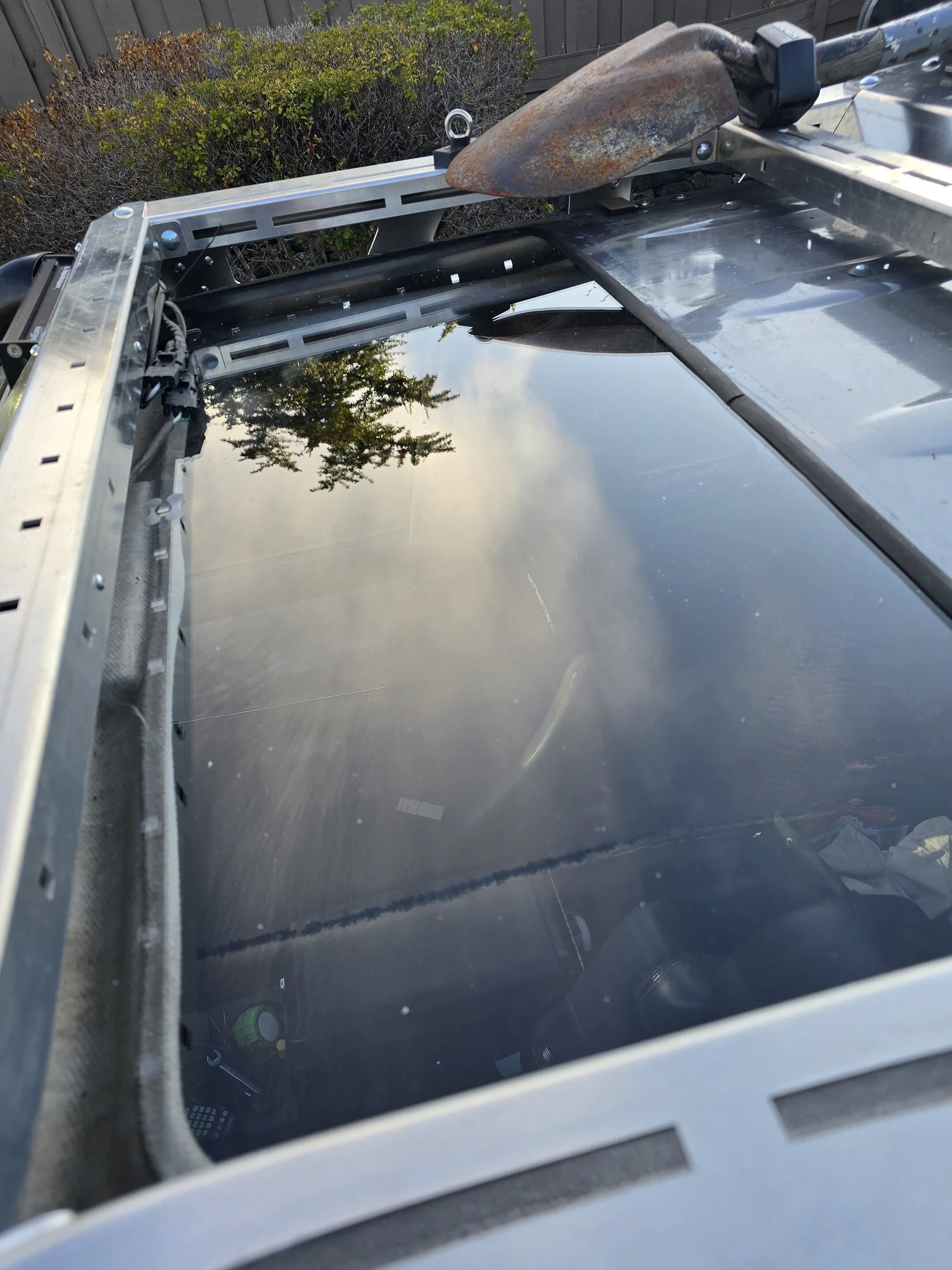

Not a bad idea at all. I did just that but I still have the oem sunroof. The problem is condensation between the glass and whatever panel you put up there.
I don't notice a problem with the stock sliding cover but maybe touching the glass makes it an issue? dunno. If you did a glass delete, maybe not an issue.
There is a surprising amount of depth. You could do a molle panel, there is plenty of space for for packs up to 6" deep (first aid kits, mesh net for glasses or whatever)
Another bonus is anything you put there acts as insulation because on those hot days, it would block a large amount of heat from radiating onto the sliding cover.

Nice that's good to hear, yeah I'd just plan on doing a glass delete most likely. I don't want any reason for the roof to leak or have issues in the future. Thanks for the insight!

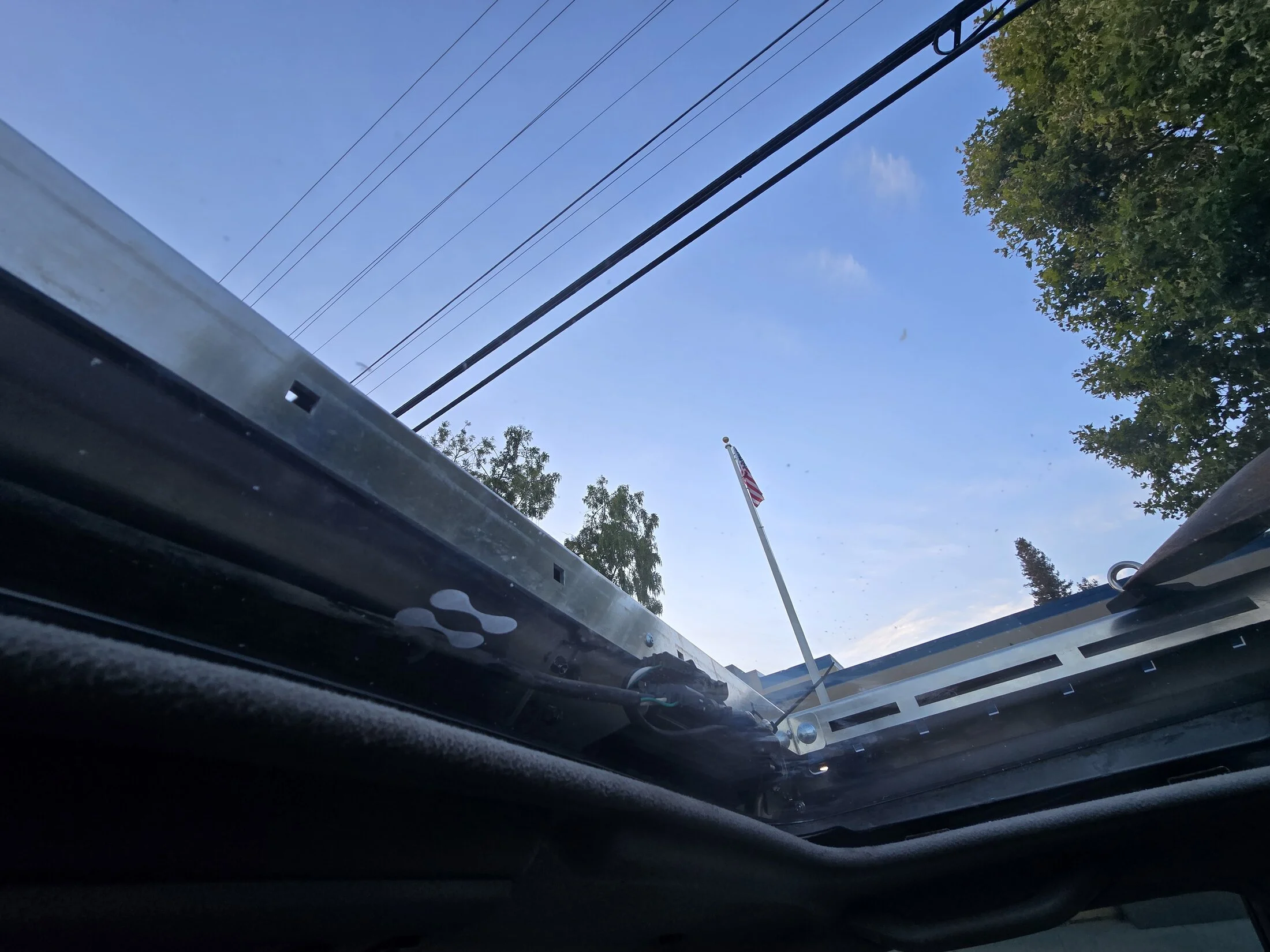

I made an acrylic plug.
kept the sliding cover and stuffed a hood liner into the space just for sound deadening.
I have been expermenting with seals.
Happy to make more plugs if anyone wants them. Acrylic or metal.
