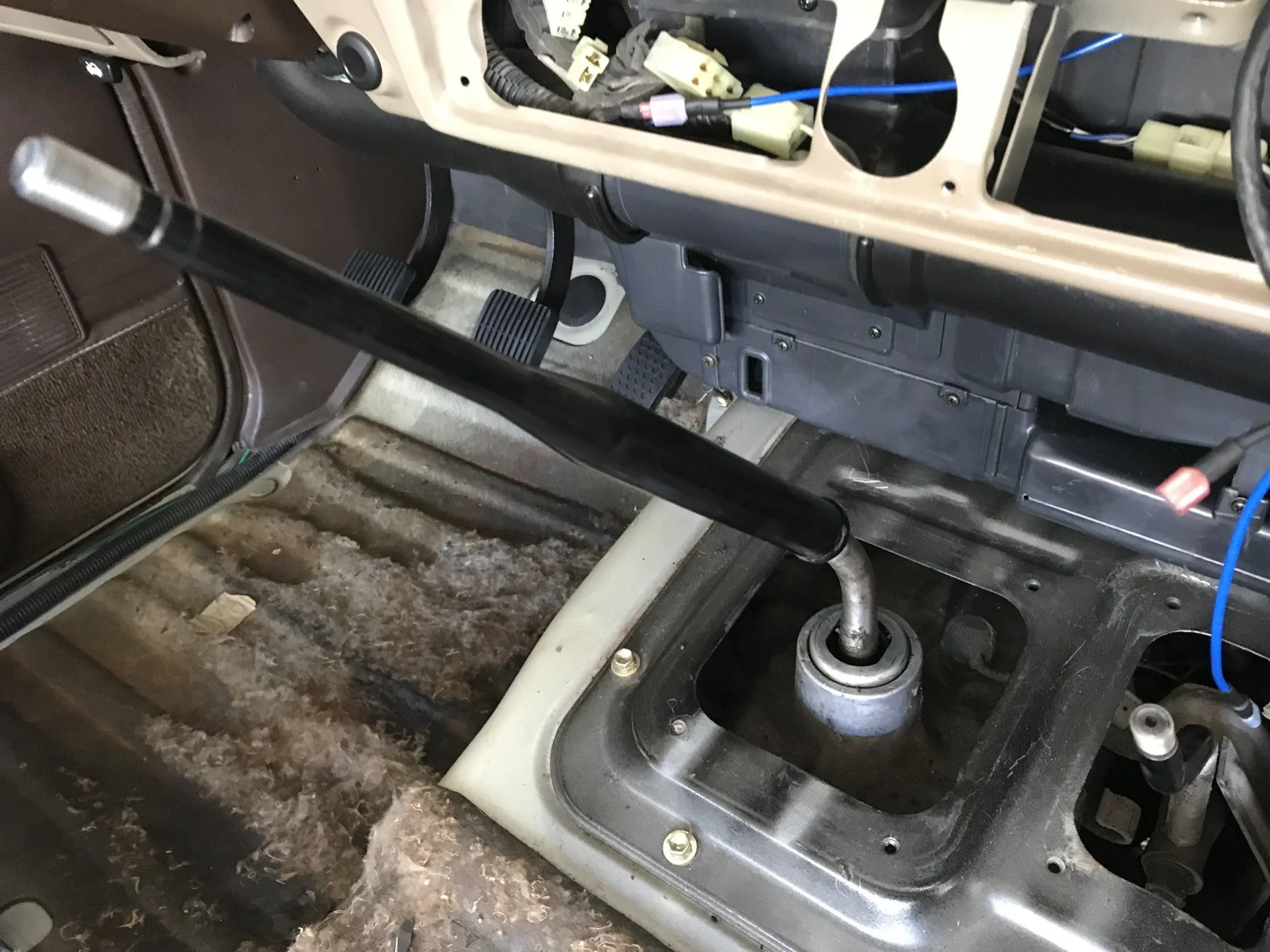

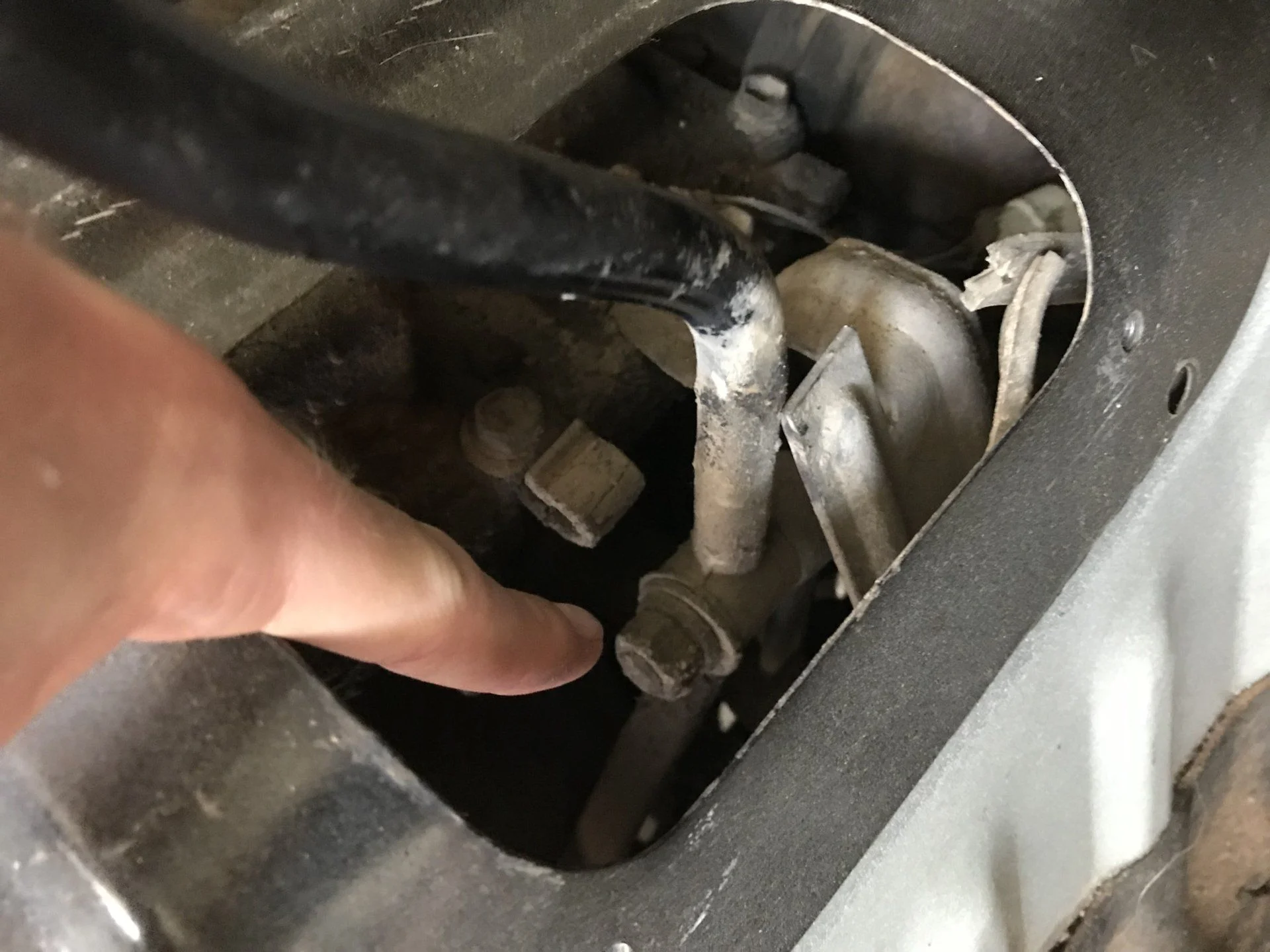

I’m about to tackle my carpet install and I am having trouble removing the shifter lever and the T case lever. I have read that all you do is push down and turn but it won’t budge. Also for the tcase seems like there is a nut holding it on? Here’s what I am dealing with. Any advice or tips would be awesome. Thanks!
Pics
i just wrapped up an H55 swap in my FJ62 - for the main shift lever it is indeed just a push down and twist counter-clockwise to release. takes a fair bit of muscle to depress the spring..and the metal collar shown in this persons fingers has sharp edges...i wore rubber coated garden gloves.
the 4-lo linkage is just bolted onto that pivot arm...unbolt and it should slide off. there's a couple plastic bushings that it pivots on...don't lose them....i thought i lost one - found it in the driveway where i'd been working for 3 weeks.
On the trans put a rag over the round piece and push down and 1/4 turn and it pops out. On the t-case forget that first nut your pointing at. Go under the truck and unbolt it down lower. Pull a small cotter pin out where it hooks to the shift shaft on the t/case. Remove the nut where it is pinned to the transmission, I think you have to remove the shift gate too.
Ahhhh nice! Very helpful. Got the TCASE Lever out. Now time for the transmission lever. Turns out my TCASE lever wasn’t even connected to the linkage and is missing the cotterpin. LAME. Ordered a new pin from specter...along with 3 bolts that were missing from the boots.
Put the cap from a spray paint can over the shifter hole to keep debris from ruining your day.

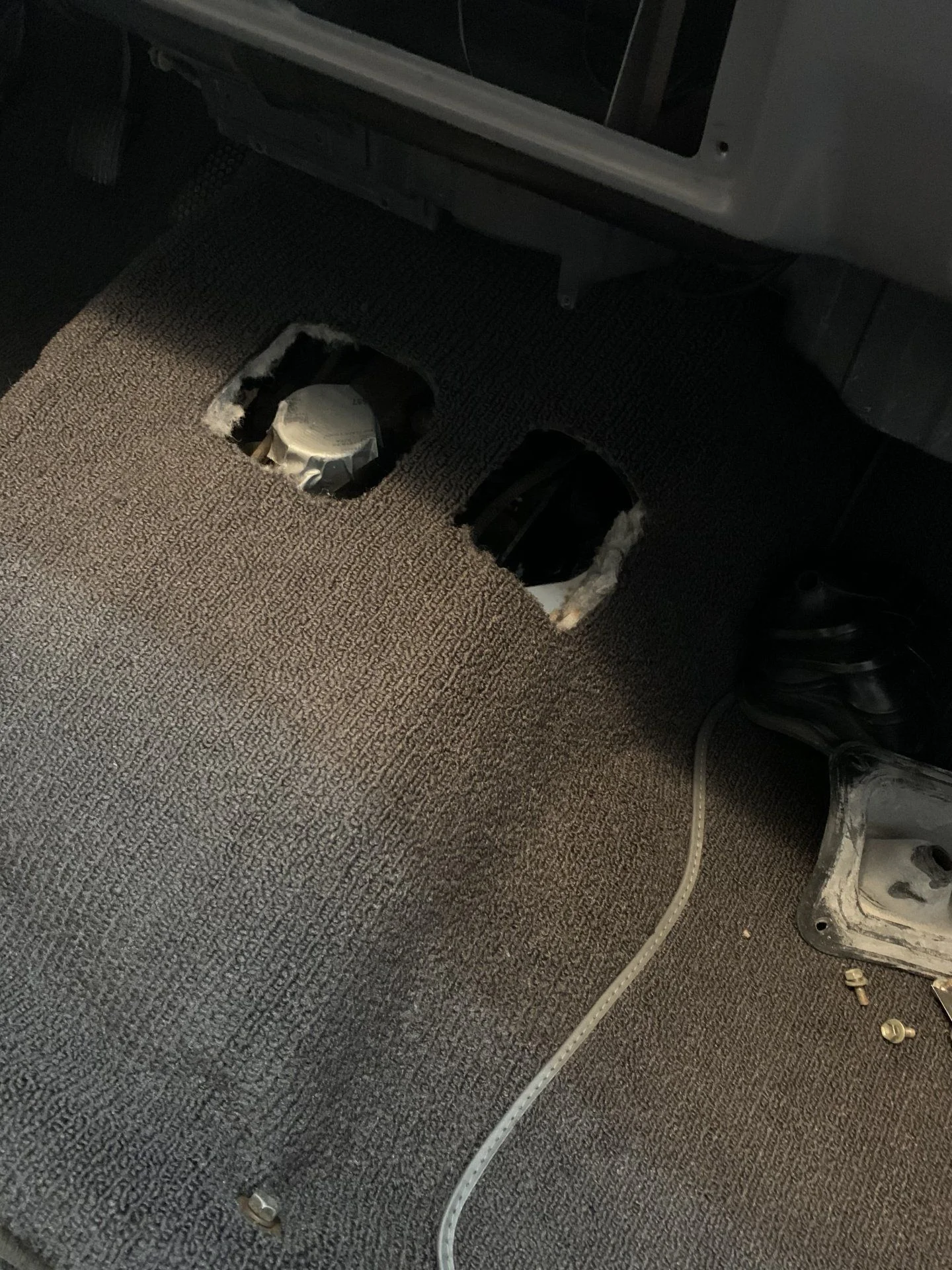

But getting them just right around both shifters is one item that had me anxious. Around the shift boots, I really want to have the carpet on top of metal surrounds, not metal surrounds on top of carpet as some have done.
So I removed both the shifter (from above, easy push down and quarter twist) and t-case lever from below. Easy enough. One bolt and a cotter pin.
As a result I was able to get carpets perfectly flat and fitted. If there is too much carpet up front by the fire wall it will not lay flat on the transmission hump.

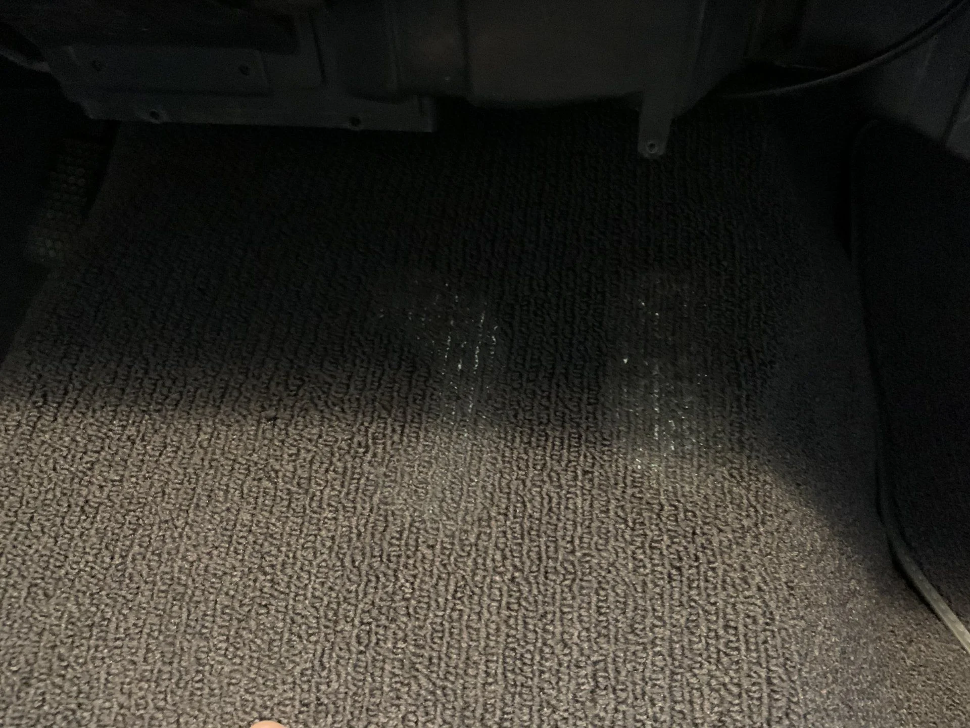

Then, by complete accident, I noticed I could see my shop light under the truck through the carpet inside the cab where the shifters should be.
This made it very easy to be super precise with the cuts. I’m sure you could just poke through with a knife, but it was more fun with the light guiding me. You can also see the bolt holes that need to be melted open in carpet for the final install of the shifter surrojnds
Pics show before cutting and after.

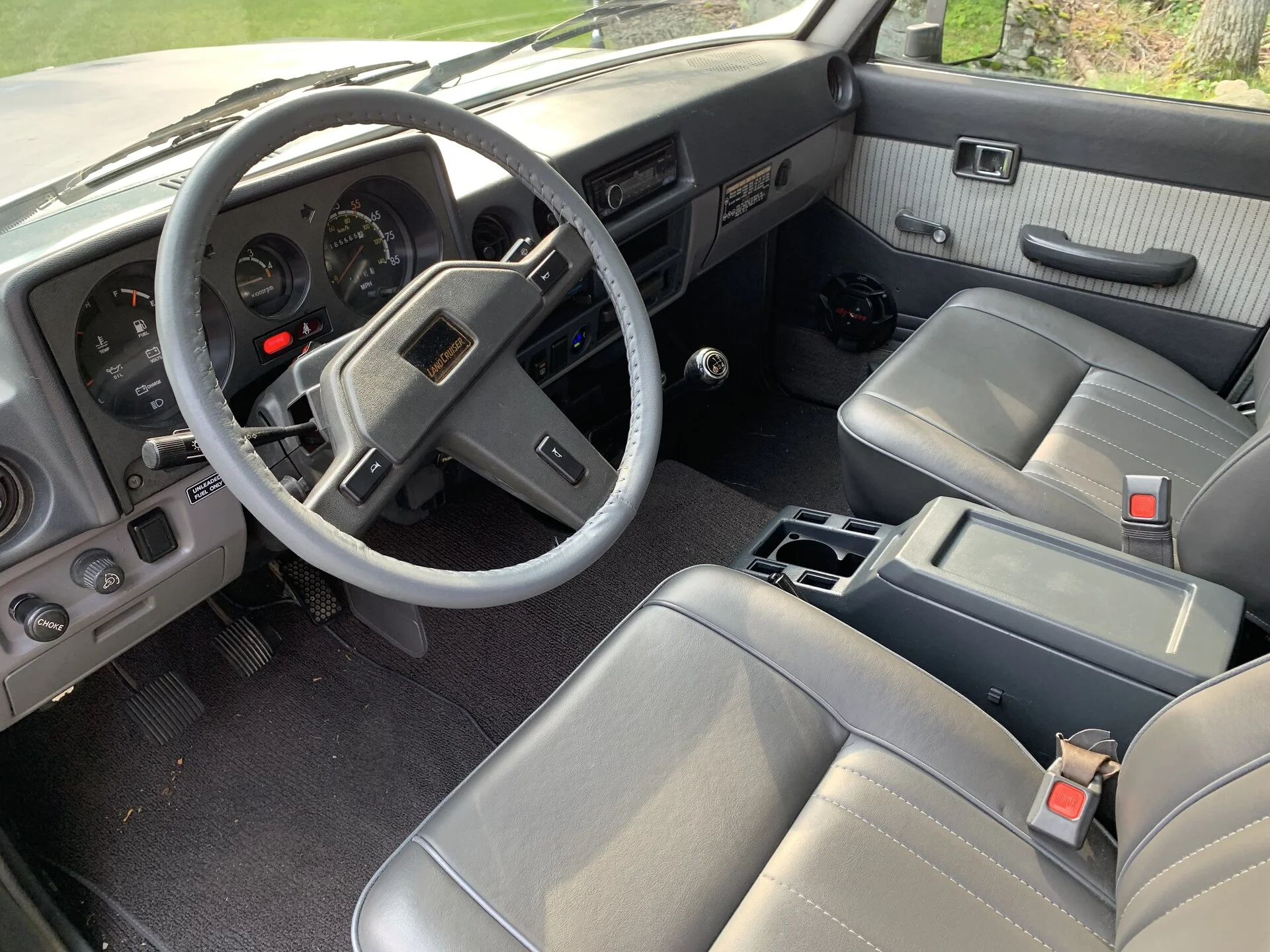

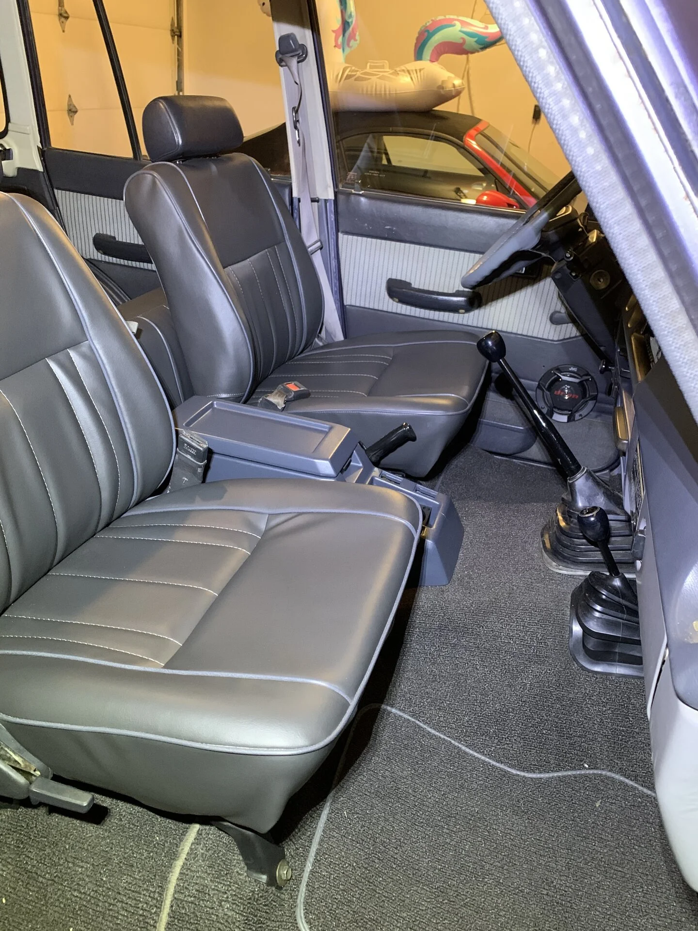

Here’s an after picture - though I did manage to get the shifter boot to cover the metal plate a bit better.

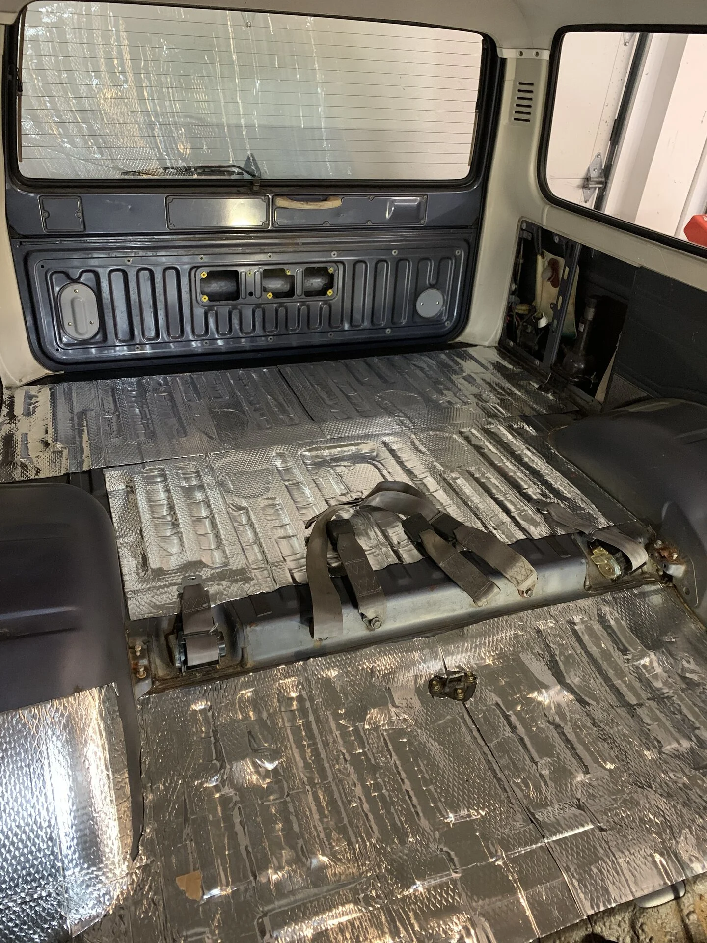

I also took the chance to soundproof the entire floor of the cruiser. Made a world of difference.
Great. Have fun. The reward to effort ratio is quite high on this one. It just looks, smells and feels so good when done, you’ll never look back.
Might have to do the same! have some noico left over from another project that could be put to good use. Your 60 looks clean! Super cool

What brand sound proof did you use, thickness and approximate sq footage do you need?
