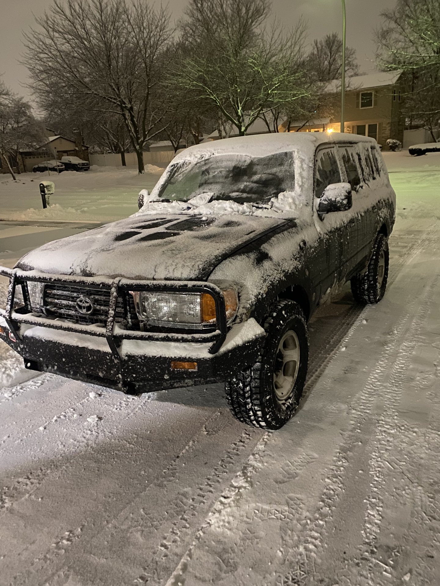

Thoughts?

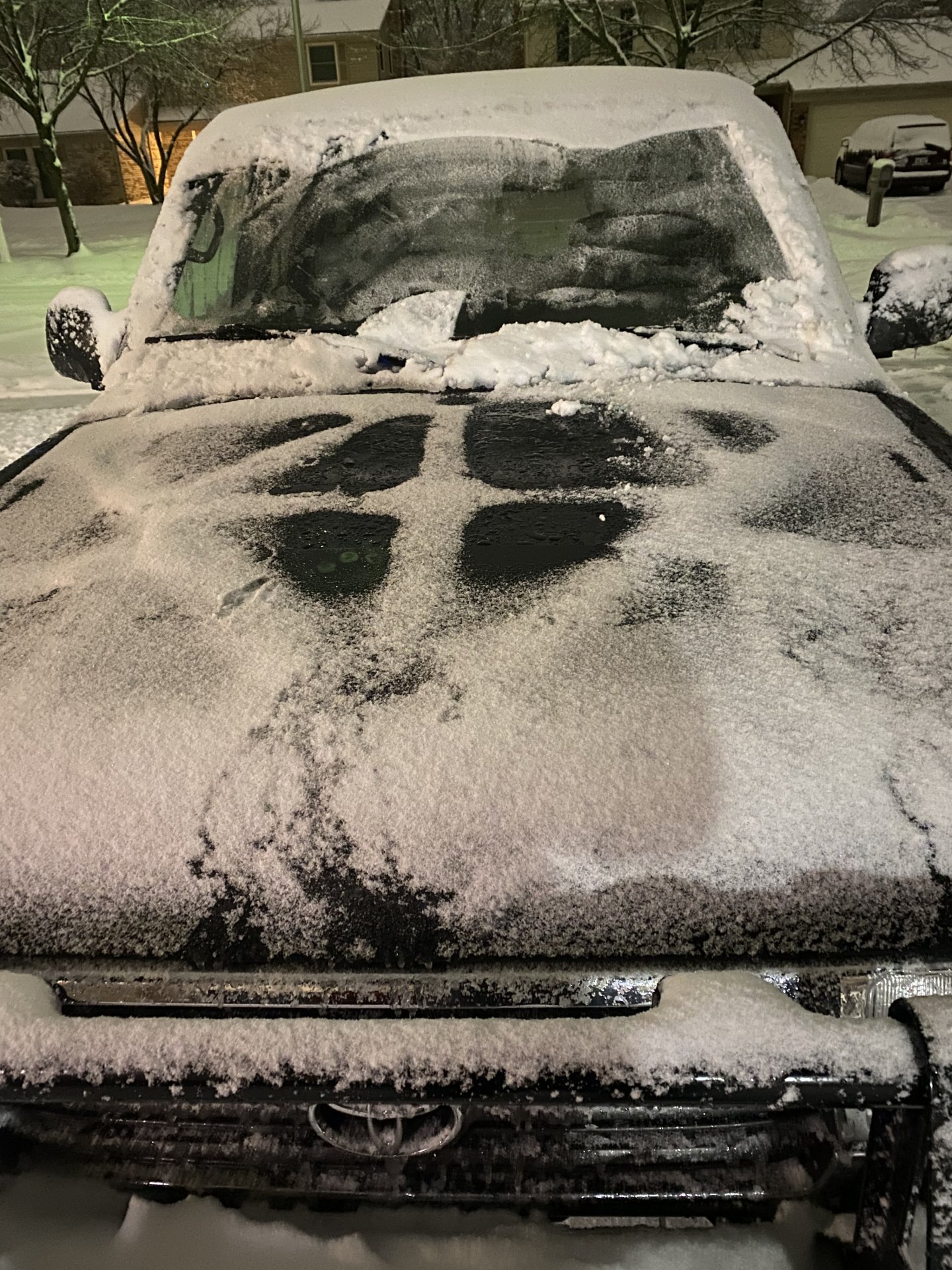

I think your hood stayed warmer there and melted the snow.
Are you concerned the heat will damage the paint?
Take an ir thermometer and see the temp of the hood after driving a while.
Remember the top side of the hood gets extremely hot in summer in some areas.
There is a debate as to whether removing the liner would leave your paint at risk. It was 15 degrees tonight and the entire rest of car was frozen iced over…
Again, when the hoods warm get a temp reading. Then estimate the temp of a hood that sits in the sun. I bet theyre similar.
My truck has the liner in it and the clear and paint still come off in sheets on the hood and roof, but my truck came from Arizona according to the old papers in it. So I think the sun is a huge factor.
