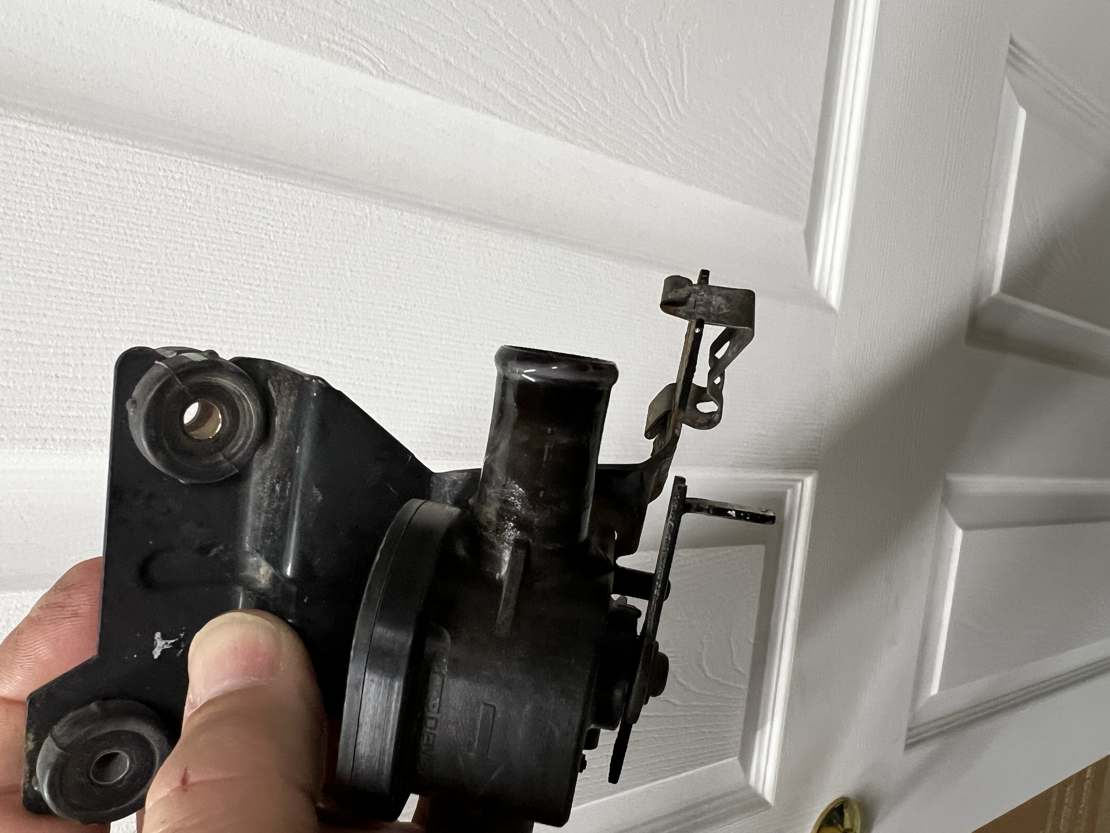

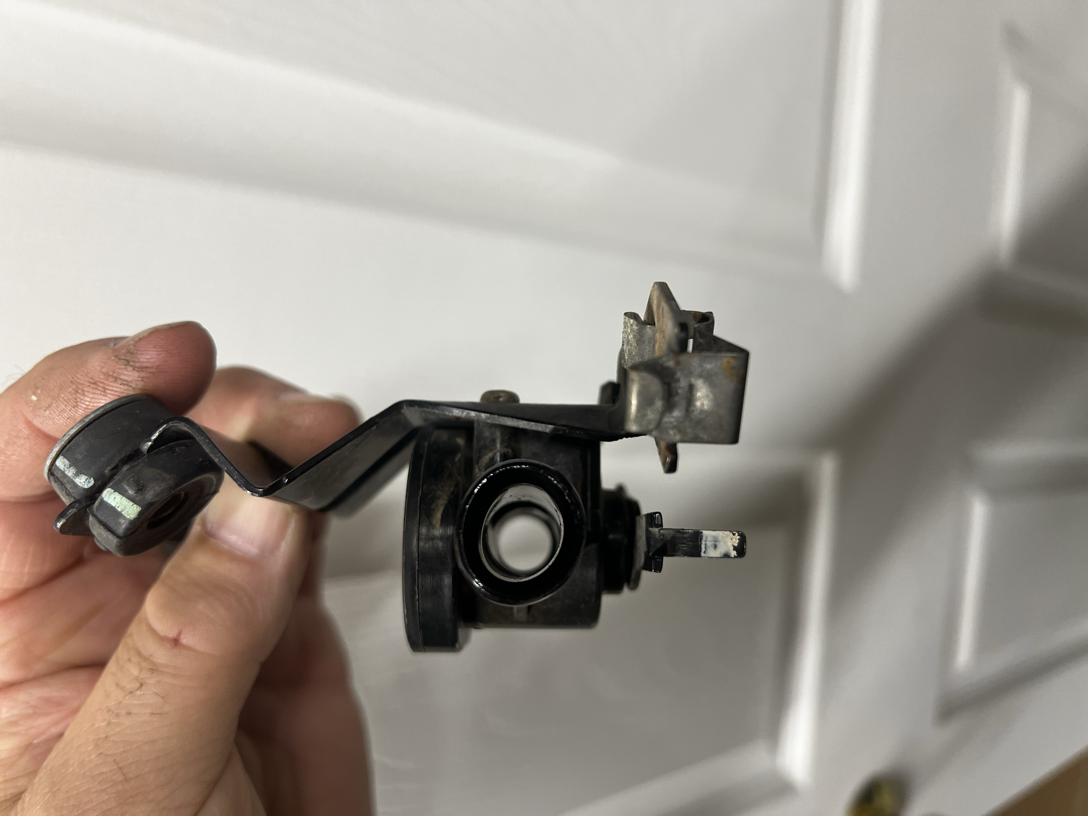

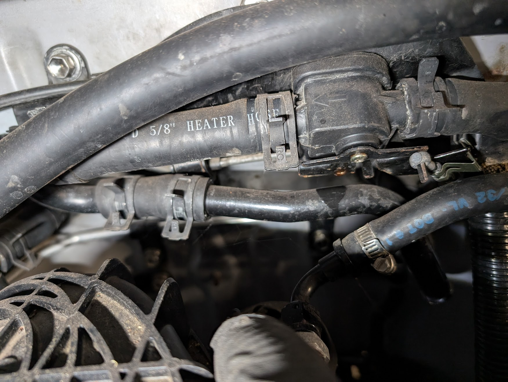

Is this right? Also is the valve in this position on cold?

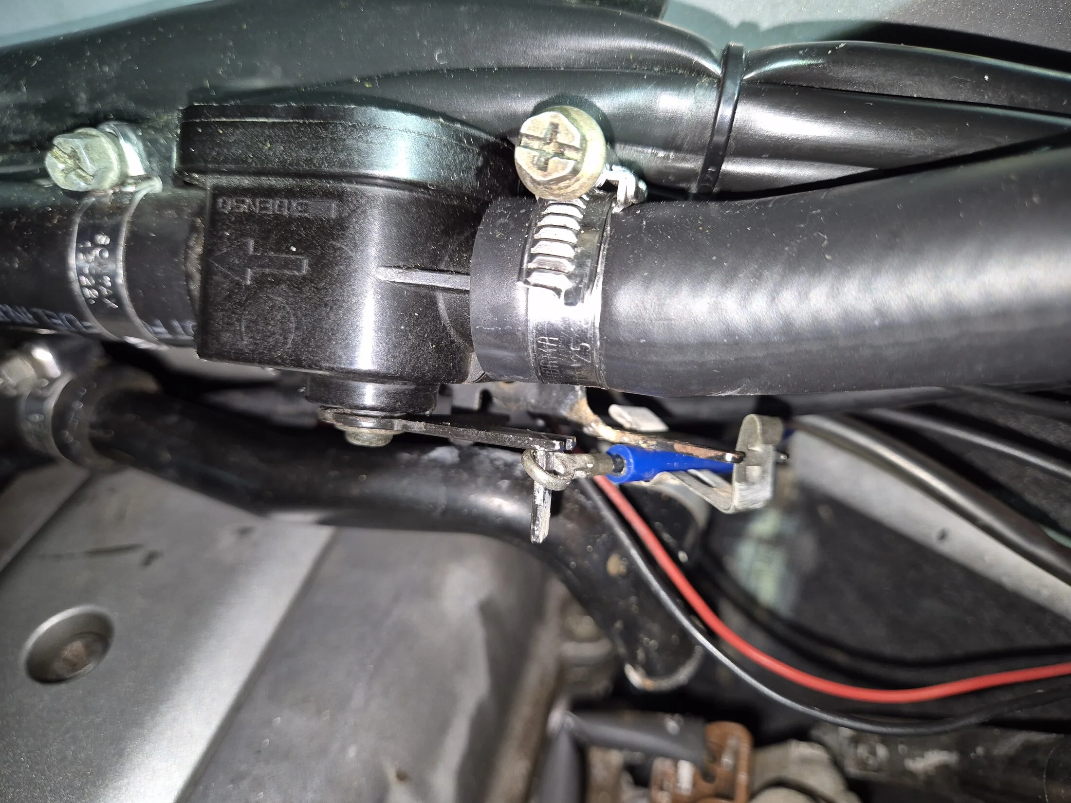

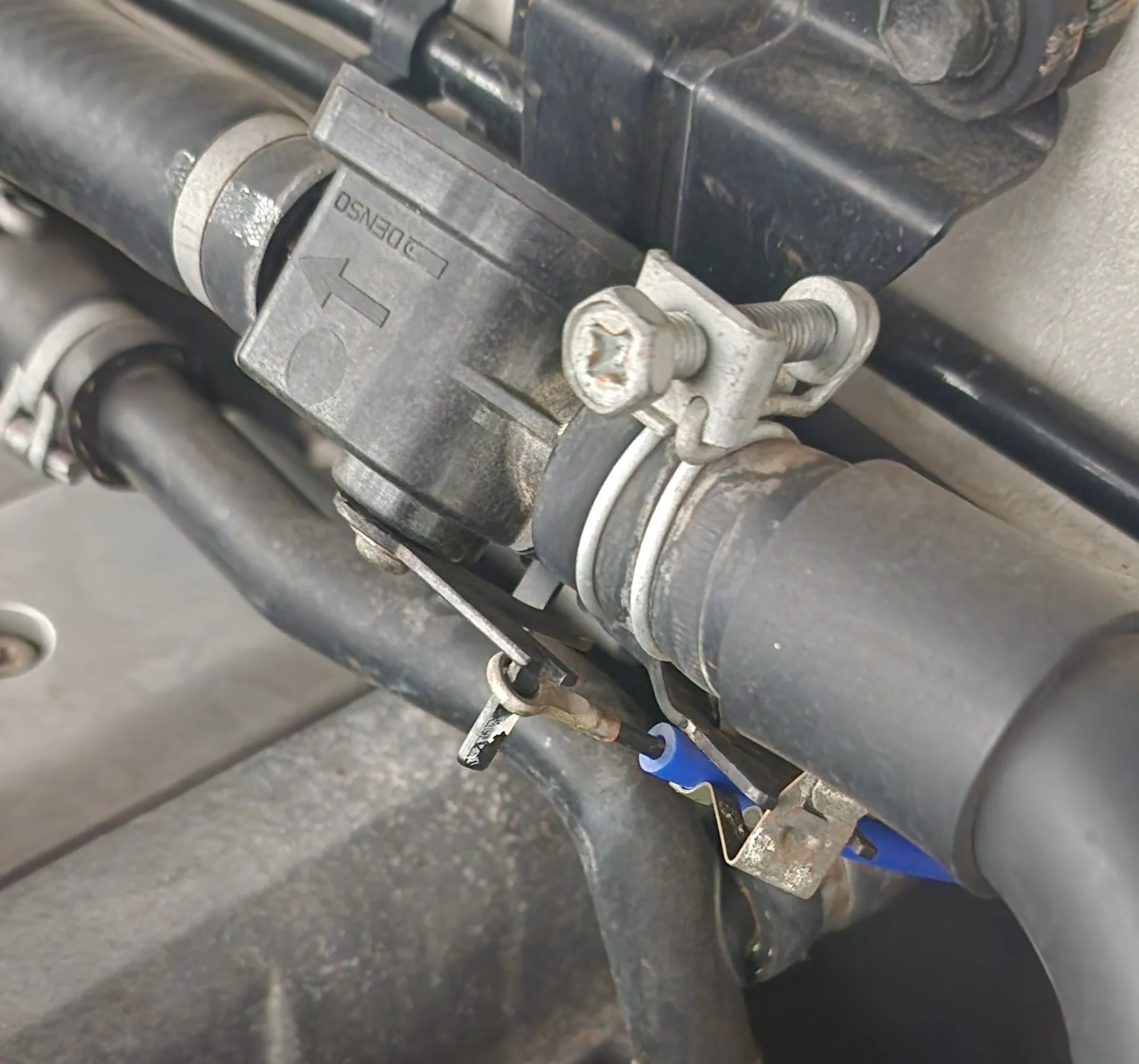

Connection to the wire looks correct...here's my recent take off...
Wire back towards firewall = valve open
Wire forward towards engine = valve closed

I would say that it is open to flow as shown in your 2nd pic.
Very weird. My cabin controls are on cold and recirculate. I don't think the cable would reach otherwise.. if I move to heat the cable pushes out toward the engine. On cool it retracts back into the firewall.

So this morning I turned the fan on and its not hot... hit the A/C and it's cold.. so I'm guessing the valve is closed in that position on mine..
Thank you to @Ribz0 for providing the below pic of his vehicle. It appears as though mine is in the correct position while on cool and recirc. Thanks all!
