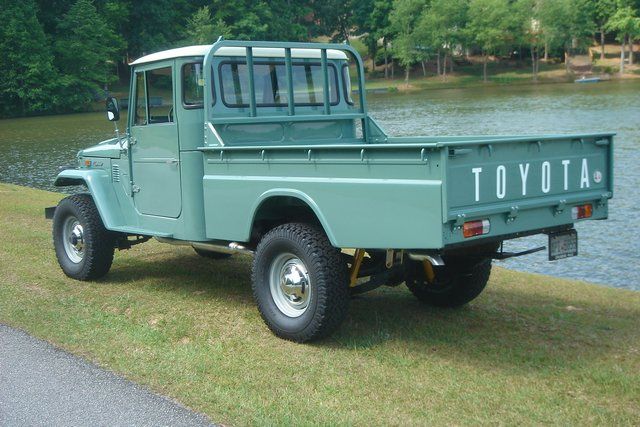

Brings up a question I have wanted answered for a long time. I have a HJ45 pickup with OME springs. I assume the springs are heavy duty so the truck can haul heavy things. I will not be hauling anything. I would like to have a better ride as well as even out the stance. If I read correctly remove the third spring down in the back?
Thanks..
Fj45 springs (at least those on my '65) were so stout and thick that I think the only way to get a better ride would be to put an old 2F in the bed and leave it there.
