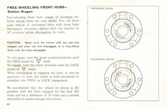

I don't know how to remove them but here's more evidence that they are original equipment:
This is from an Owners Manual published in 1974,
:beer:
wow! I would of bet that they were aftermarket, but that sure makes it look like they are original. Maybe a non-USA market item? I thought all of the ones here were Asco/Aisin. Either way, I would figure they are worth replacing, as they are probably really hard to get parts for. I think the weld in the center of the cap does not look factory for anybody, so I would grind that off and see if you can pull the control cap off and get a clue on the internals. I would still expect an external snap ring on the end of the birf to retain it on the end. John

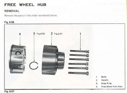

1975 Chassis & Body FSM:
and finally ....
:beer:
Dude! You are the man. Is your manual market specific? I wonder if they were only available in certain locations. So, for 75 PIG, I would bump that cap that you are holdilng in pic #2 around till of lifts off. You already have the 6 retailing bolts off, so go for it. You may have to pry around the bottom edge also to get it up. It may have been on there for a long, long time. Good luck, and keep us posted. John
So with those 6 bolts out, the HANDLE (and only someone who does not have English as their principal language could call it that) should apparently just pull off..
:beer:
PS. I think Toyota themselves made these hubs. And this poor early design is probably why they later left this job to other manufacturers..

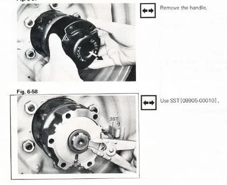

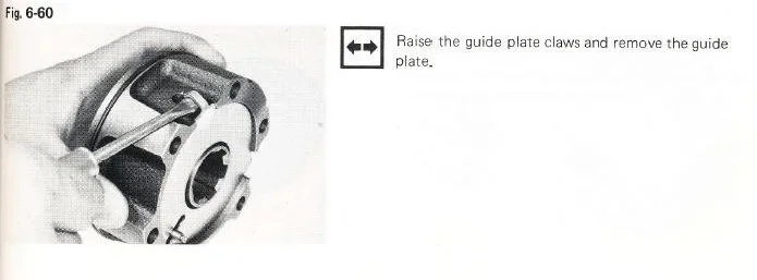

We were able to pry off the "handle" (such a n-e-a-t word to describe this cover) of the locking hub but it took more than just pulling it off. We used a combination of a small screwdriver inserted into the front holes and prying it; alternating 180 degrees to another hole on front cover to get some movement of the "handle" off the locking mechanism. After this process created a bit of space, we used a larger screwdriver and mallet on the back of the "handle" and tapped the "handle" back and forth (wobble effect described above) until it became loose and could be pulled off (like the instructions show.... with ease).
The pictures should show the process we took at getting the handle off.

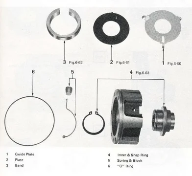

Notice there is an "O" ring that I did not notice in the schematic/instructions. Did not "bugger" it up.
Now, the snap ring has no holes so will give it a whirl and hope it does not "fling" across the garage when it comes loose.

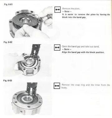

BTW.. The O-ring is shown in Fig 6.59. Errr. Well 6.59 is between 6.58 and 6.60 funnily enough. (I thought I'd better tell you this because I cut off the figure number on that one when preparing it for posting.)

more pics
The O ring shows up as item #6 in the third pic of post #5. Good job getting it all apart so far. There are special snap ring pliers for those rings without holes. The pliers have flat paddles on the ends. A bit tricky, but they do work well. John
Appropriately called "duckbill snap ring pliers" John
