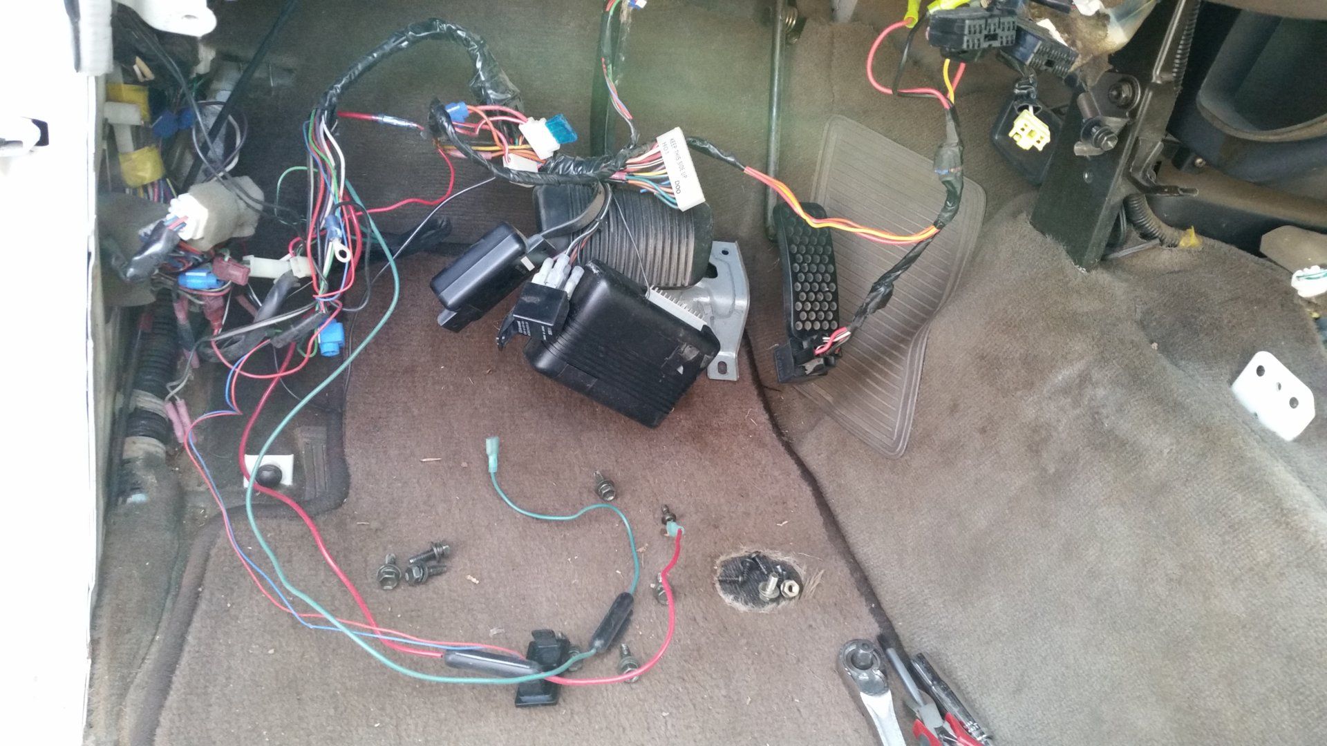

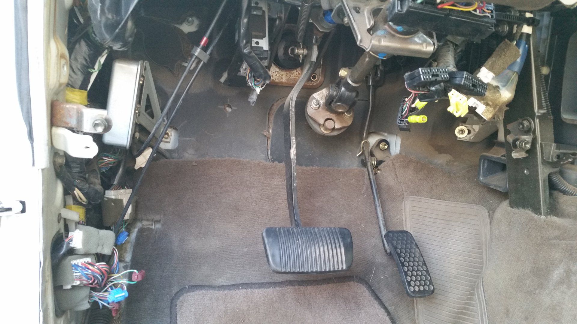

No, but I can tell you how it looks after I ripped mine out by the roots:
Looks (and makes me feel) much better!
