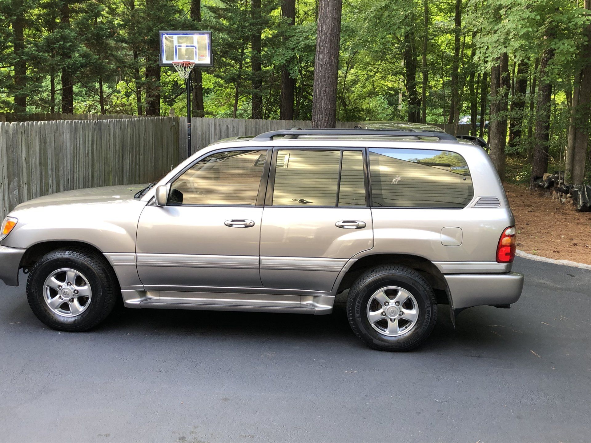

I purchased this vehicle back in 2006 and now it has 115K miles. It is still running strong and aged really well.
However, I am concerned about its potential reliability issues and find myself stranger if it breaks down. Whats your recommendation?
If I am to replace this vehicle, I will consider either 2013-2015, open to 2010/2011 lx570 if there isnt much difference between 2011 and 2013 version, lx570 or relatively newer gx460/prado. How do you compare these two?
