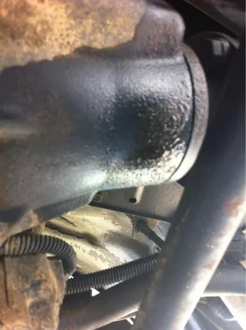

I crawled underneath and began an inspection clouded by frustration over what had just happened, and that my father-in-law/GM Master Tech was looming over my shoulder undoubtedly thinking this wouldn't have happened in his Tahoe or either of his Impalas. The first place my mind went is that something went wrong during my front axle rebuild about 1,000 miles ago and was just now rearing it's ugly head. There were no worrisome noises and everything looked dry. The front pinion seal leaks, but not nearly enough to have drained the diff dry.
