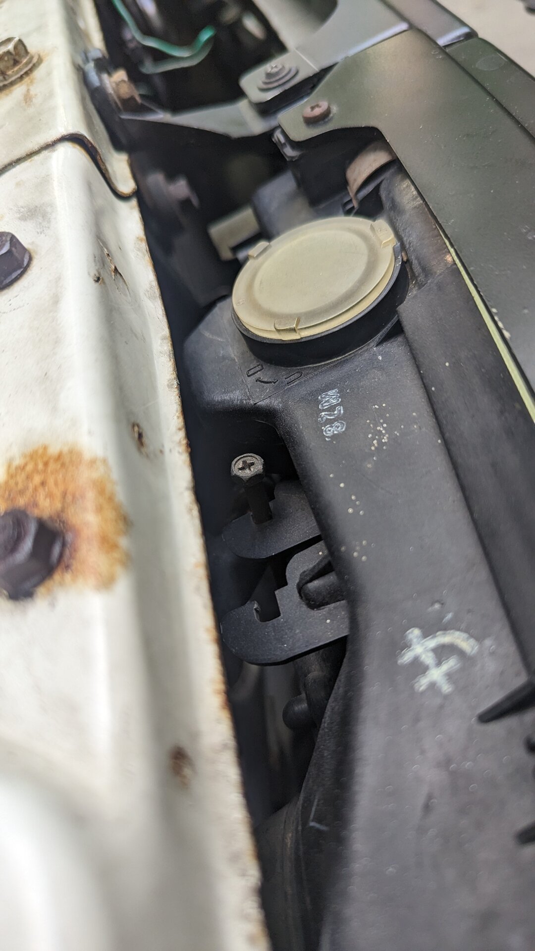

3) My headlight adjustment screws appear to be way out of whack, anyone know what is up with them. Turning them does nothing. Below is the passengers side while the driver side has the plastic arm all the way at the top of the bolt.

The adjustment screws easily strip out if they are adjusted to the end of travel and you torque them past it. I learned this because I did it to my depo housings. If I remember correctly I took the adjusters off my oem lights and swapped them onto the depos after that. So pretty sure they can be replaced.
