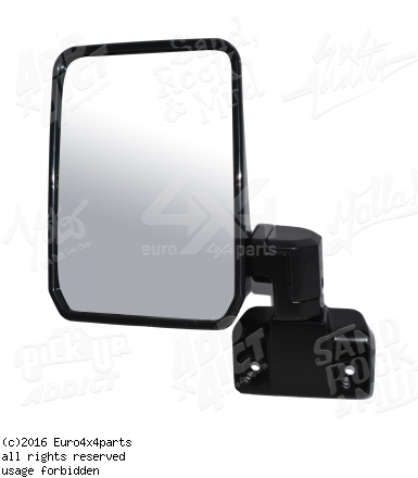

A new side/rearview mirror. The other one was loose and while I was driving home, it decided to peace out, so I installed a new OE one. Looks awesome :)

Where did you get the rear mirrors?
The easiest way is to get the part number and put it into google and you will find a few dealers who sell them. You can compare prices
I’ve looked around but can’t seem to find anyone who has them new.
Are you using the part numbers off later models like post 99? I think its the same mirror but as an upgraded part number.
From an 05 FZJ79 GGC LH 87940-60371 RH 87910-60141 Euro4x4Parts says they have them in stock (138 euro) if Beno cant help you.
You ll find a lot interior parts are available with upgraded part numbers, but they can be different colors.
These long mirrors are probably still being fitted in some markets
