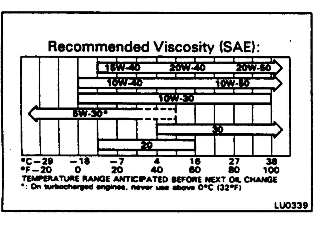

I see from the Toyota 3b service manual that for summer I can choose from 10W-30, 10W-40, and 20W-40. 5W-30 for winter is recommended. No mention is made for the use of synthetic oil.

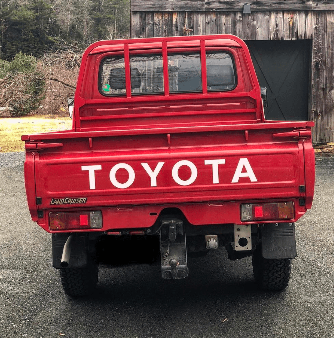

A photo to give you a sense of what I am dealing with

I was just looking at the FSM for the 3B on this and it appears they are reccomending 10w-30 as having a good wide temperature range. My weather is fairly temperate here - highs in the 90Fs and lows rarely below the 20Fs.
Does anyone disagree with that?

I follow the oil guide you posted above.
Spring/Summer/part of Fall: Rotella 30w
Winter: 5w40
When the temps hit 90f, that oil will be like water. I would at least go for the 10/40 or 10/50
