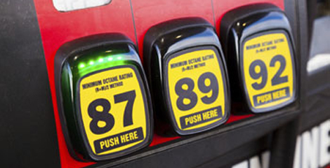

Here's my $.02 between Premium and Plus
When living at 5000 ft in Utah I noticed a difference in performance. At 1000 ft in Phoenix I don't really notice.
I tracked my fuel mileage between premium and plus; the fuel mileage difference was worth the extra cost and actually saved me money. As my Cruiser has aged and fuel mileage has overall gotten worse (if anybody knows of a normal issue besides the MAF please let me know) the gap has decreased and the savings are not that noticeable.
NOTE: A few years ago I found that Costco Premium was about the same as Plus at other Top Tier vendors. I haven't checked recently.
If you believe you're gaining between 5% - 10% in mpg by using premium over regular then you're still losing. How? Well, in my area 87 is $1.99/gallon, and 92 is $2.45. That's a 23% increase in cost. So, by this logic you would be spending 23% more to save 7.5%. I'm no math wizard, but...you lose.
Our engine is not a high compression engine that requires the higher octane. All the higher octane does is that it allows for greater piston compression before allowing the fuel to ignite. It prevents pre ignition combustion. That's it. Also keep in mind that the 87 is the minimum octane rating at that pump.
Here are some links about octane ratings, and no, we do not gain actual benefits from running premium.
I have a fairly heavy build (6500lbs running weight) compared to a stock truck so I'm constantly toting a load. I've been using Top Tier Premium primarily for the additional detergency and additives it contains. I may be misguided but my thought is that it burns slower, cleaner and reduces deposit build up in intake and top end. Makes for a cooler running, cleaner burning engine. I'm going to experiment with lower octane up at higher altitude (9k-12k feet) in the next couple of weeks and see how does and if it helps reduce excess vapor pressure in the tank.

So turbo cars would never be able to run on anything less than 93 because their compression is too high? Meh.
Octane correlates to timing, advance/retard...to prevent knock...that's it. A lot of V8 NA cars run lower compression. The ECU will adjust to the fuel. The fact that these 4.7's live under 3k rpms and weigh 65 million lbs will limit the butt dyno calibration sensors. Meaning you'll never feel the difference but there is one.
Actually, I have to say the 2UZ is the only engine I've ever had in a vehicle in which I can feel a perceptible difference in acceleration and overall performance when using 93 octane premium. I assume the knock sensors Denso provided must be hyper-sensitive, because overall driveability is noticeably better in my 2UZs that allow regular unleaded (2000 Land Cruiser requires premium, but my 2004 GX and 2005 Sequoia do not). Again, I've not been able to tell a difference in any other vehicle I've owned, but in anything 2UZ powered, there's absolutely a difference.
I'd be curious on what that difference is. Is it 20%+? Now a 23% increase in MPG on the low end would be 2 mpg, and the high 4 mpg. These are best case scenarios. Assuming on the low end with 87 you're getting 10mpg city, and 17 hwy. Very generous MPG. Now if premium, costing 23% more than regular, would increase performance by the same 23% then I would see a benefit, but otherwise I do not see an "ROI". I do not see the gained utility.
Let's average the difference to make it a 3 mpg increase. At 3 mpg additional average then, let's say we use 20 gallons of fuel, then we would gain an additional 60 miles out of that 20 gallons. With the new average mpg of 16.5 (average of 10 mpg and 17, and adding the 3 additional mpg), we in theory saved a hair over 3.63 gallons of fuel. 20 gallons of fuel at $2.45 = $49, and 20 @ $1.99 = $39.80. We spent $9.20 to go an additional 60 miles. Keep in mind we still were going those extra 60 miles, but we would have filled up sooner; however, those additional 60 miles would have cost us $8.84 using 87.
Sure we are discussing pennies here, but I seriously doubt it's an increase in performance over 20%. I don't care about feels. I can't trade on feels. Well, I guess I could, but they would be bad trades. Real world, do the math, pencil it out, and let us know when the costs equal the benefits. I guess I could make a spreadsheet running multiple scenarios, but I'm not because I do not see the numbers adding up.
