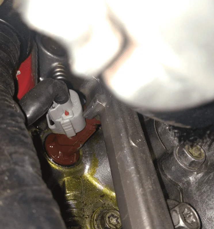

Yes. I have a very bad experience to report with counterfeit injectors from Amazon. I see the same counterfeits being sold on eBay. Lookout. It a deal is too good to be true, it probably it. Now, this was on a Toyota 5VZ after less than 1000 miles. The injector pintle caps literally started to melt from regular engine heat. I kept smelling fuel from around the engine compartment. The new counterfeit injectors were melting and fuel was being sprayed in the intake manifold.
The counterfeits look like originals except for a few small details that a regular person would not pick up on.
If you have healthy injectors, I would get them serviced that includes (cleaning, o-rings, screens, and pintle caps). There is nothing magic or difficult about servicing injectors. I often do my own, then send them out for cleaning and flow testing afterward for $7 each.

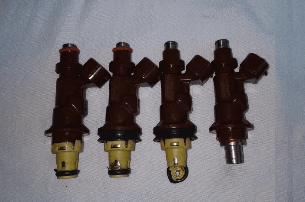

BRB with some horror pictures.
Horror Pictures. New OEM (counterfeit) injectors from Amazon.
The pintle caps started melting and became deformed.

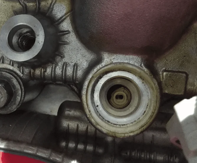

One had actually melted into the intake manifold. I had to pick it out and use tiny vacuum to suction parts of it out of the intake mainfold.
This was after less than 1,000 miles.
I'm lucky the whole thing didn't go up in flames.
Also note, if an injector servicer does not use quality components, more problems to start later on.
Fuel leaking on the intake manifold.
Pintle cap after it melted into the intake manifold. This was a real pain to get out.
Pictures of counterfeit injectors.
I would get my old injectors serviced by a company that I trust before I would buy any injectors new or used from eBay or Amazon. With Amazon, you can easily return the injectors if they appear to be counterfeit. How to spot counterfeit injectors?

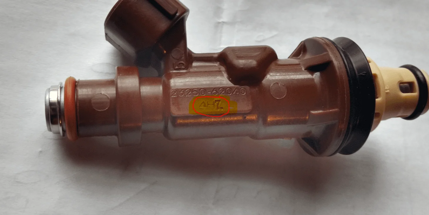

Here's another genuine injector with the quality lot number stamped into the injector body. Once you get the knack of looking for the quality lot numbers on parts, you can reduce the risk of being burned by counterfeits.
Counterfeits will not have the quality lot number code etched or stamped into the part body.
Here's a counterfeit example below.

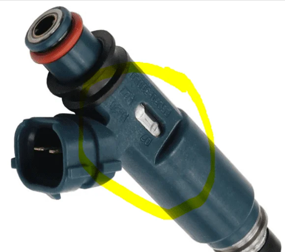

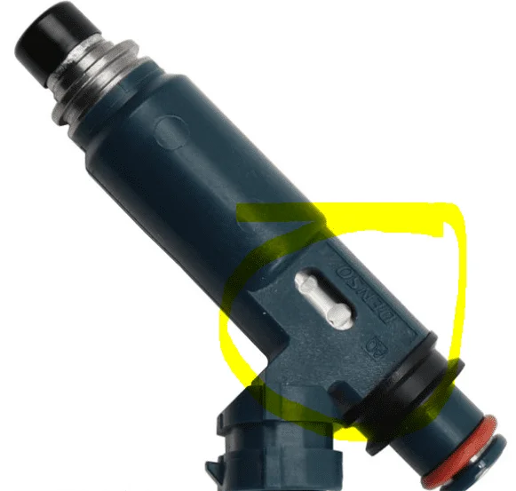

If looking to buy new Denso injectors, I would be looking for some quality lot numbers in these areas.
If the quality lot number codes are not there, the injectors are most likely counterfeits from China.
And this area.
