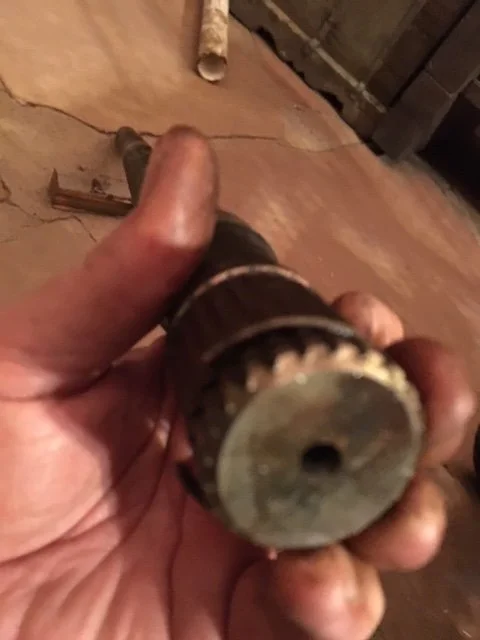

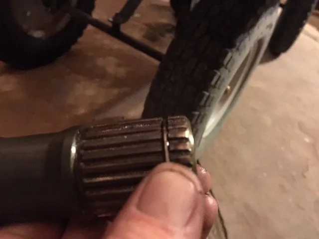

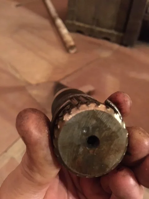

New to this all, so I suppose it is the way it's supposed to be, but seems like it's worn into the axle groove quite a bit. The first and last show how when you push down on it, the other ends of the ring stick out, and the second shows how it's below the splines.
Looks mostly normal, but maybe a bit stretched by pulling it apart.

Okay, thanks! Just seemed like it should be a tighter fit.
