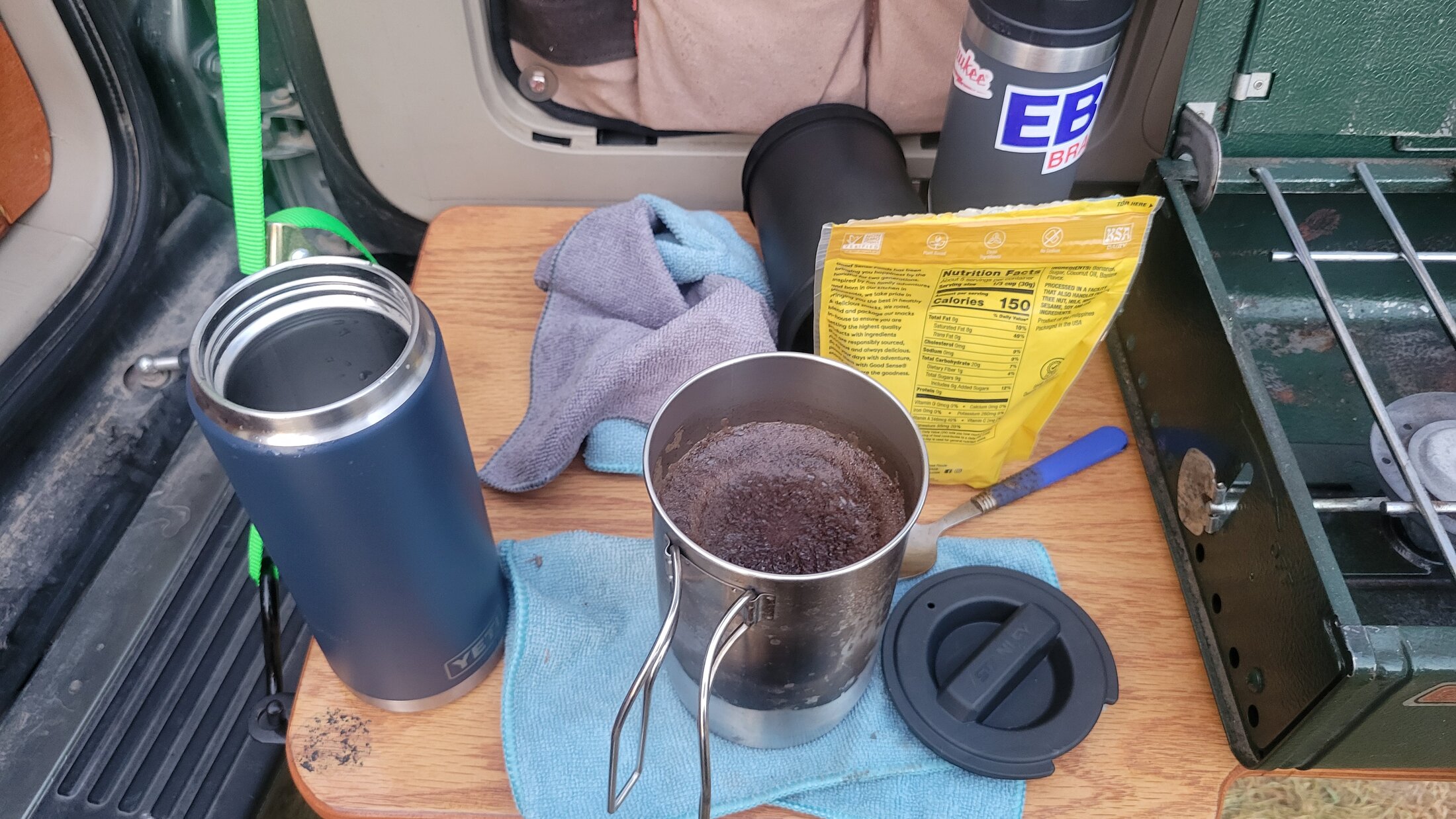

One great thing about sleeping in the rig is that it's super easy to run out for an evening, get some camp time, then wake up, have camp coffee, and be home by 8 AM the next day. Especially if you live in an area with tons of public land within 35 minutes like I do.

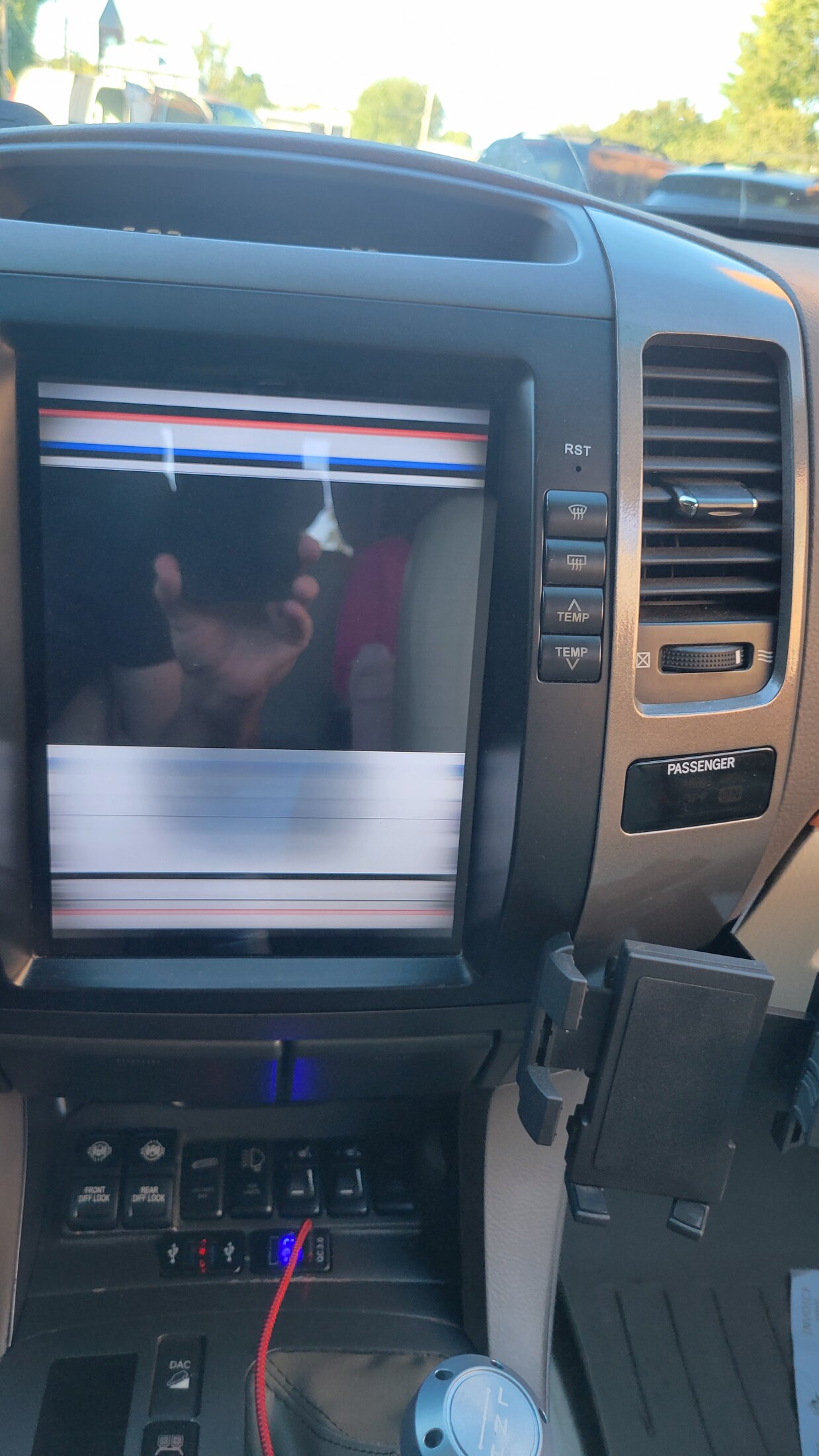

It finally happened. Display started acting funky last night, and is either weird lines or totally black today. Multiple attempts at the reset button and a battery disconnect have not rectified it. I'm betting the digitizer is toast. Luckily, the HVAC still works, and Android Auto works too! I went ahead and ordered a new PX6. I'm betting my old one is around 5 years old.
That’s sucks that it only lasted 5 years.
Not unexpected for a Chineseium tablet. It was useful enough that I'm replacing it, but there also aren't any other options for nav rigs that provide Android Auto, GPS mapping apps for wheeling, and OBD2 monitoring.
