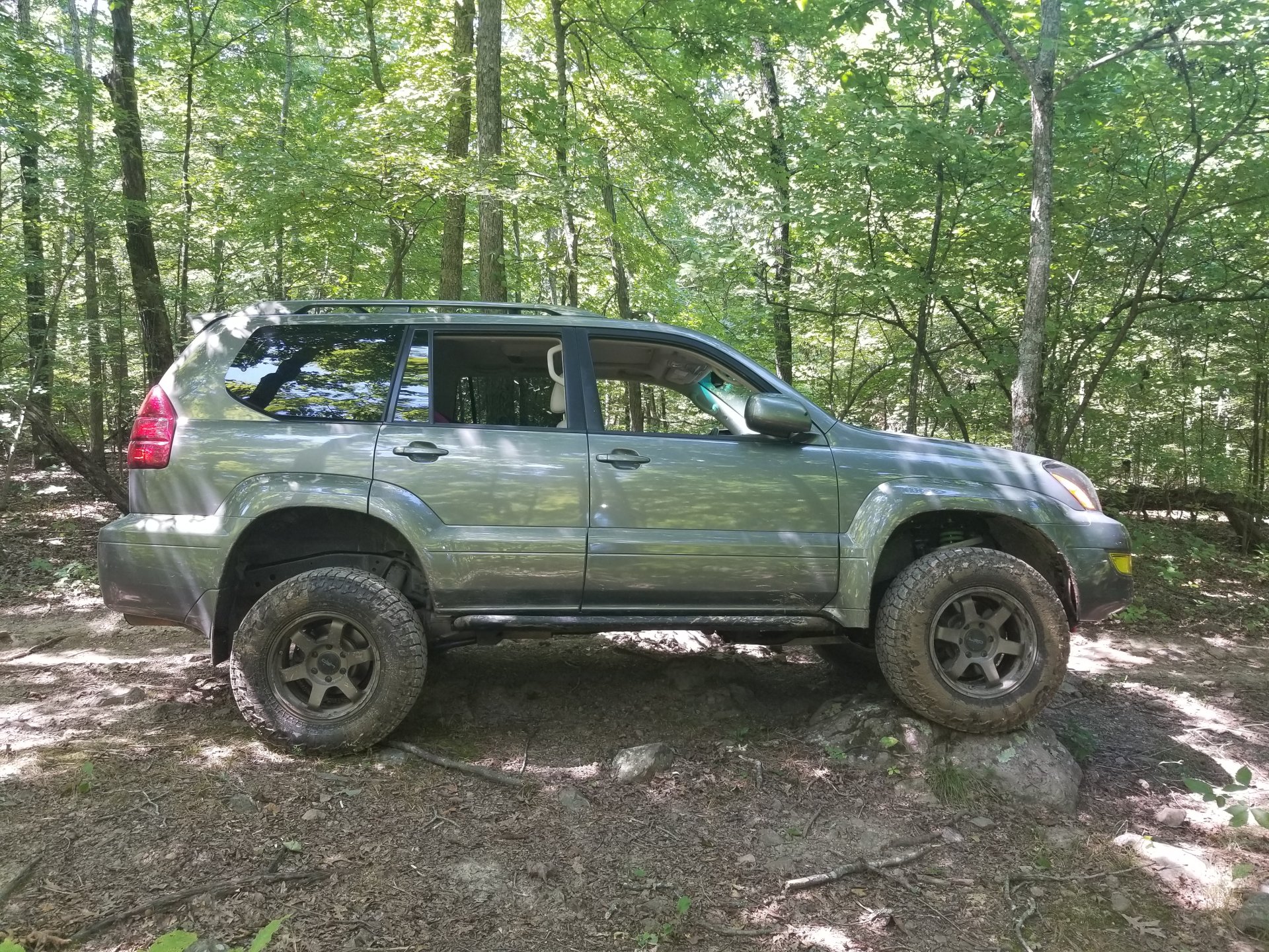

Took a break from house stuff today (we are over the hump on a number of things) and engaged in my #1 hobby - even surpassing my Lexus - hiking! Went to the tallest (not the highest) mountain in MO and stretched my legs for a bit. Just shy of 1,000 ft of climbing in a bit over a mile.

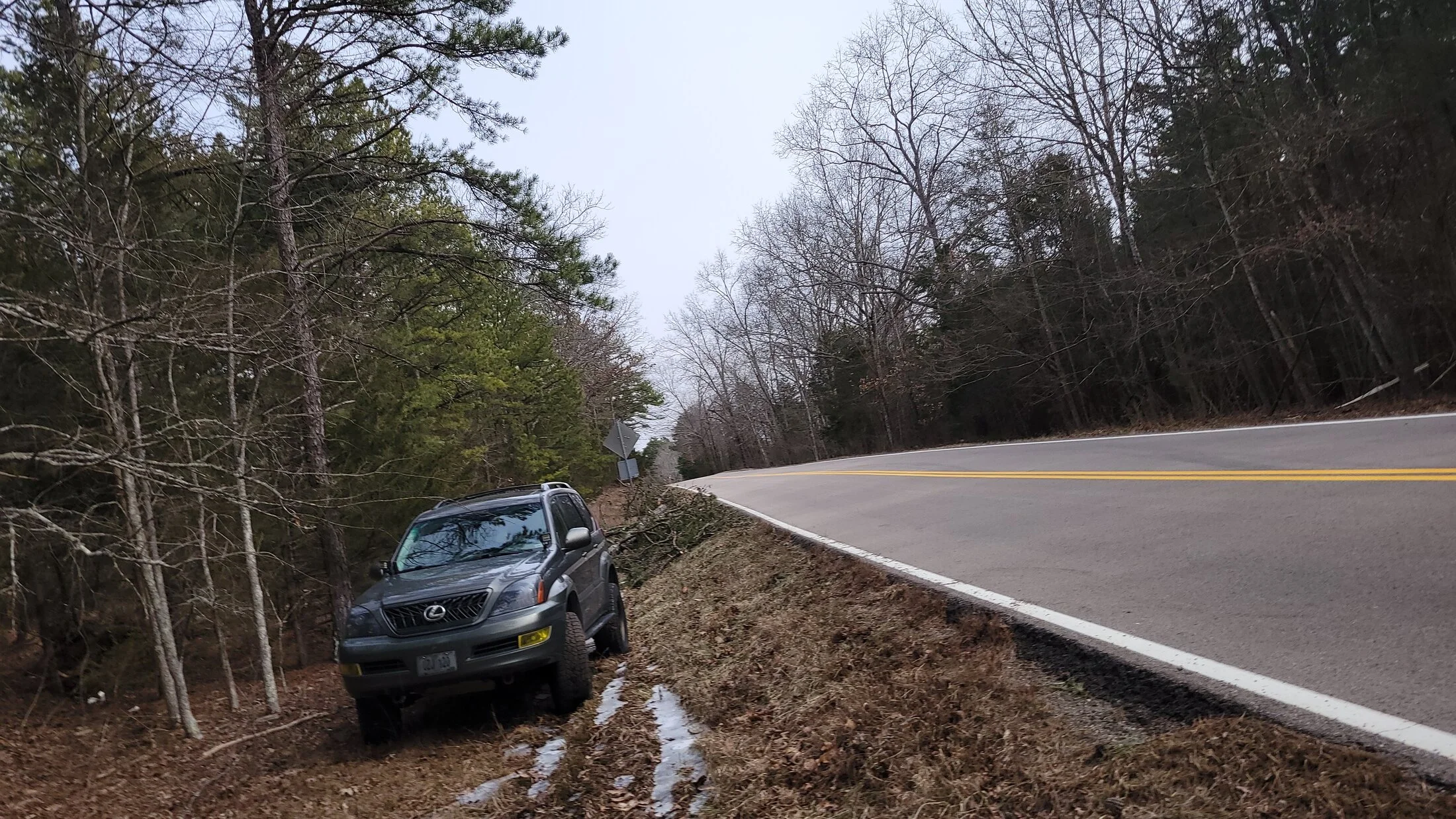

One nice thing about have a "real" 4x4 like a GX is the ability to pull off and park safely on just about any stretch of two-lane letter highway to catch the one sliver of public, non-posted land that gives you legal access to your off-trail destination. Dunno if my old Forester or even our Outback cold have made it back up this. The GX didn't even spin a tire.

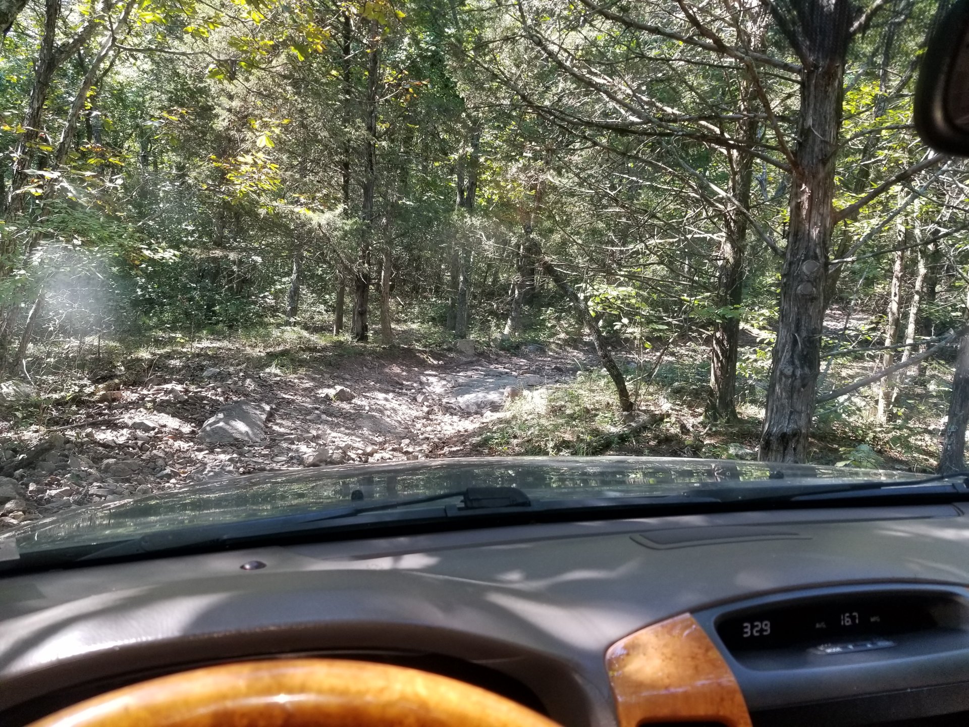

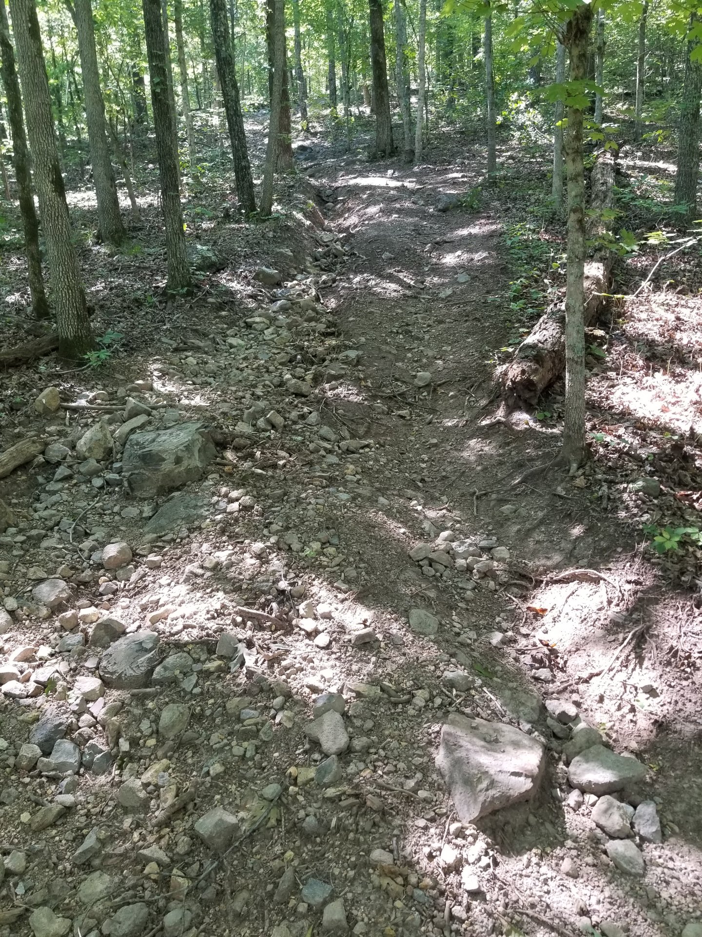

I took today as a wheeling day and checked out a trail in the Mark Twain National Forest that I hadn't been down in almost a decade. It starts as a 12-mile long, dead-end gravel road through the woods before necks down to a very tight side-by-side trail and ending at a river. I brought a pair of loppers and a M18 sawzall and cut quite a few branches, saplings, and small trees to avoid body damage and pinstripes. I made it as far as I was willing to go solo without a winch or lockers. The pictures don't do this trail justice. It's around a 30% slope and the rocks are super-loose. I'll return this fall with a buddy who has a WJ with a winch and we'll try to do the whole thing.
Beautiful gx and sweet trIls

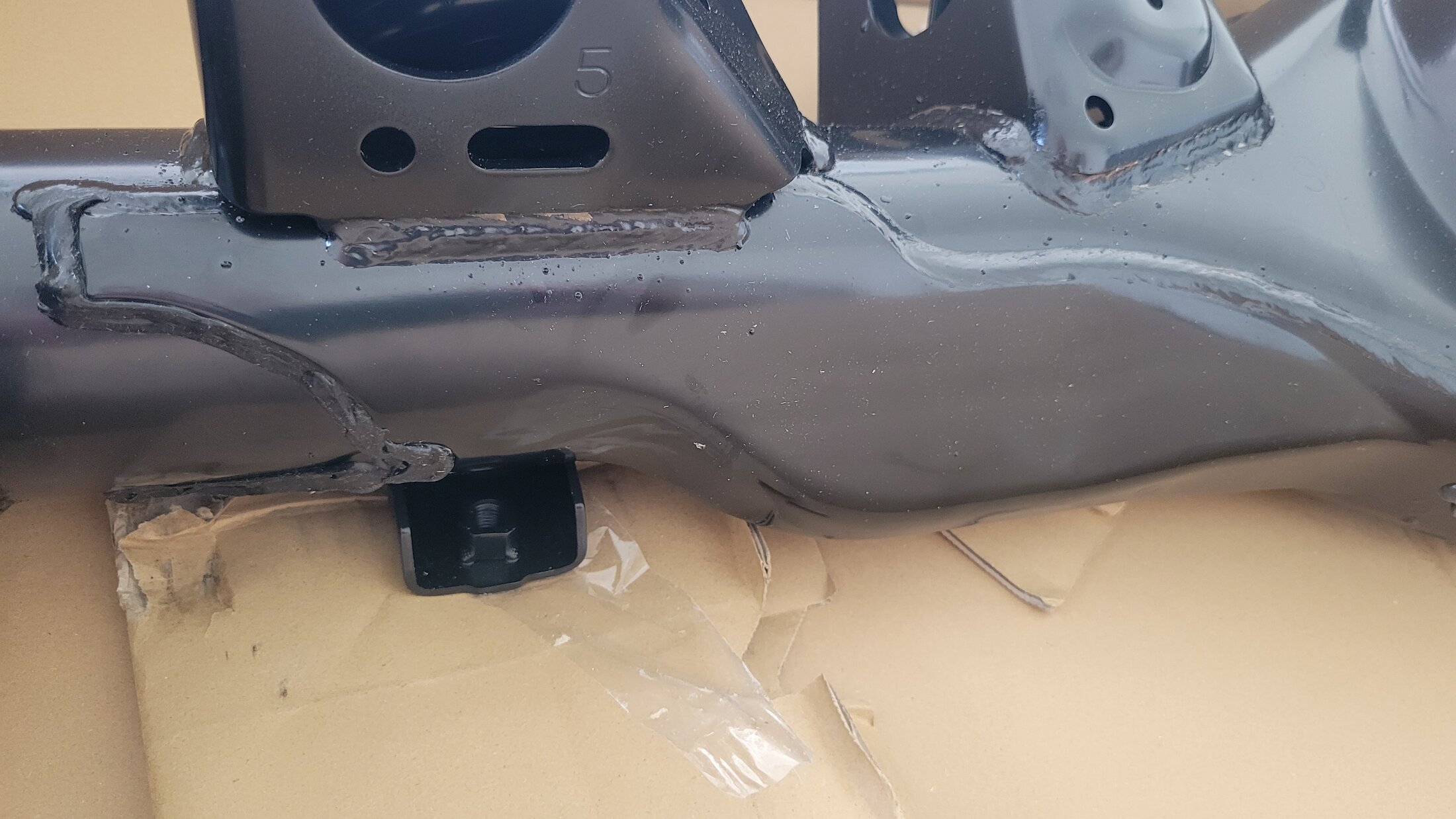

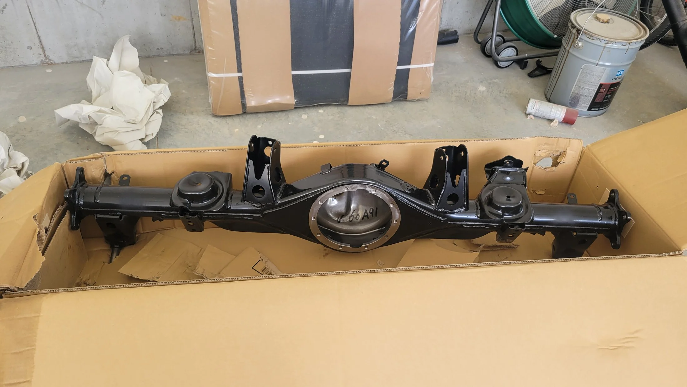

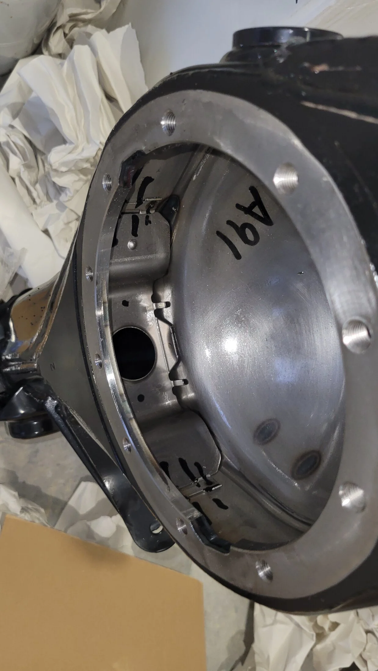

Christmas in January! The OEM trussed 8.2 housing arrived this afternoon (Toyota 42110-60A91). It had a Castaway-in-reverse journey from Japan to Memphis via FedEx air freight, but luckily it didn't end up in the ocean. And the shipping cost more than the part, but it was only around $150 more than getting a non-trussed new housing from my local Toyota dealer (who said there were no trussed housings available in the US Toyota parts stock). This was ordered the first week of January from Megazip. They must have just produced a new batch, as they are now back in stock on Parsouq, and actually a bit cheaper with UAE shipping than I paid from Japan (earlier this month Partsouq had them as "0 in stock" with no ETA).
I'm kind of curious on if anyone knows of one of these actually being installed in a USDM GX470, FJ Cruiser, or even a 4Runner before. There are some forum posts acknowledging it's existence, I have not found a documented install. Perhaps this will be the only GX470 in the USA with this housing in it. Regardless, it's barely more expensive than a junkyard 8.2, so this seems to be the way to go if you are upgrading from an 8".
Didn't know this existed! Sweet! What's the OEM application?
Mexico-spec FJ Cruiser, and some Gulf, Australian, and JDM-spec Prado 150s. They also make a OEM elocker version, but I'll be using a Harrop elocker so I got the non-locker version.
I'm thinking the truss will really limit housing flex and make this the "ultimate" 8.2. I'm not wanting to mess the cost that comes with a Dana 60 or 9.5, so this seemed like a nice option that's still stronger than a USDM 8.2. I'm also not ever planning on running more than 35s.

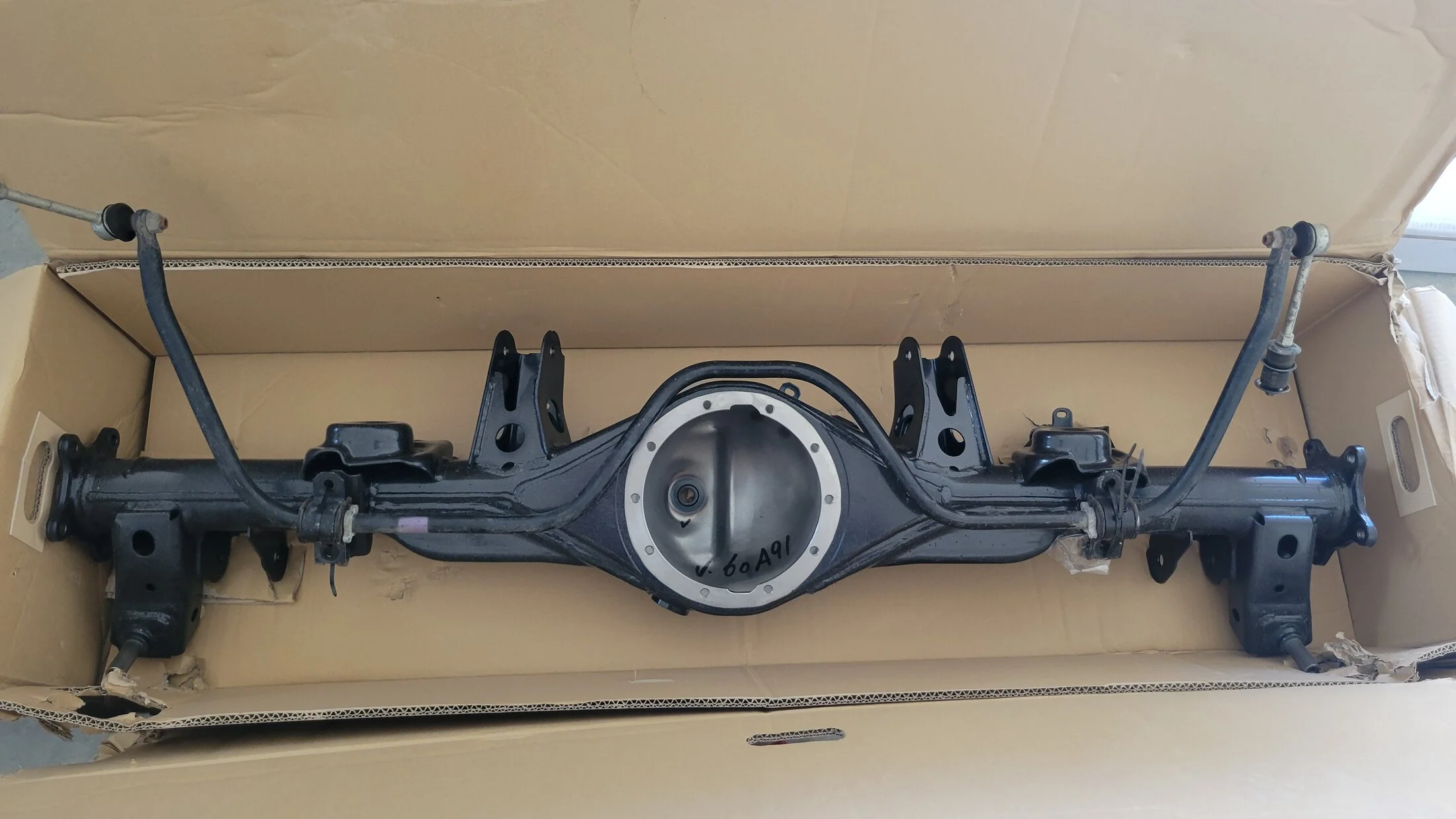

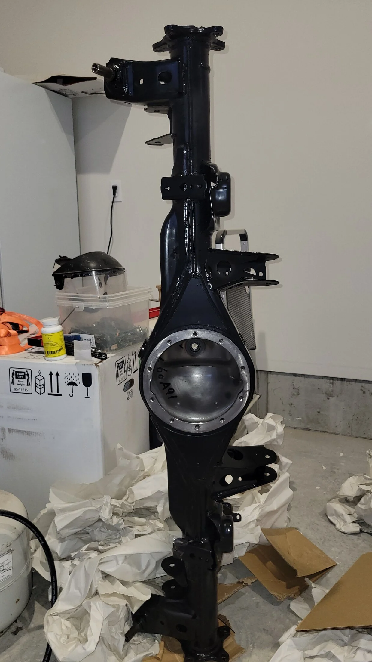

Few more pics of the housing and truss.
Parts are continuing to trickle in. Got a 2023 T4R takeoff sway bar with links for $125 on eBay. It fits the AUDM housing perfectly. I'll extend the links and make them adjustable like I did with with the cheap Moog links I have now.
I figured this route would be a lot easier than modifying the new mounts on the new housing to fit my narrower 120 bar.

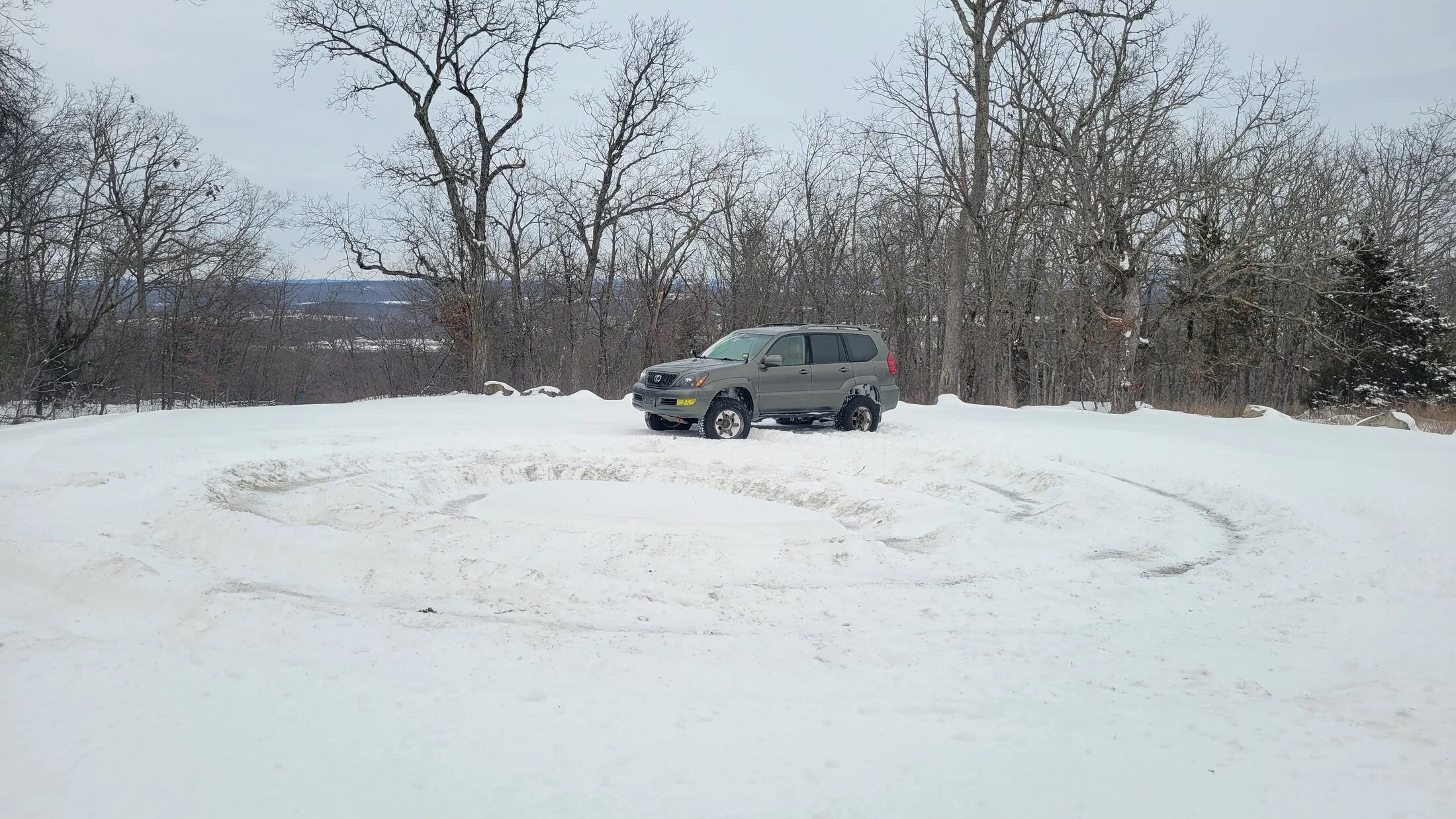

Here is why we should all install a nanny-off buttons in our rigs :).
I've never had a 4x4/AWD vehicle do donuts like a GX will! Must be the combination of SWB plus a V8.

With my ABS and traction control disabled with my warning light issue I'm able to do spectacular donuts in the snow.

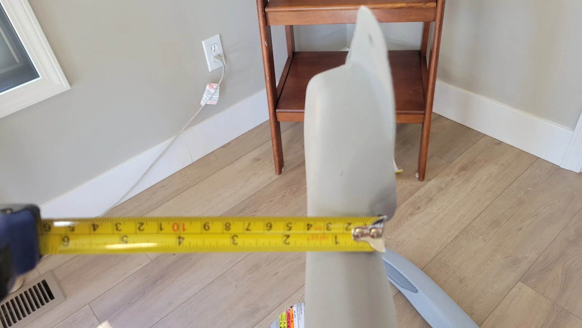

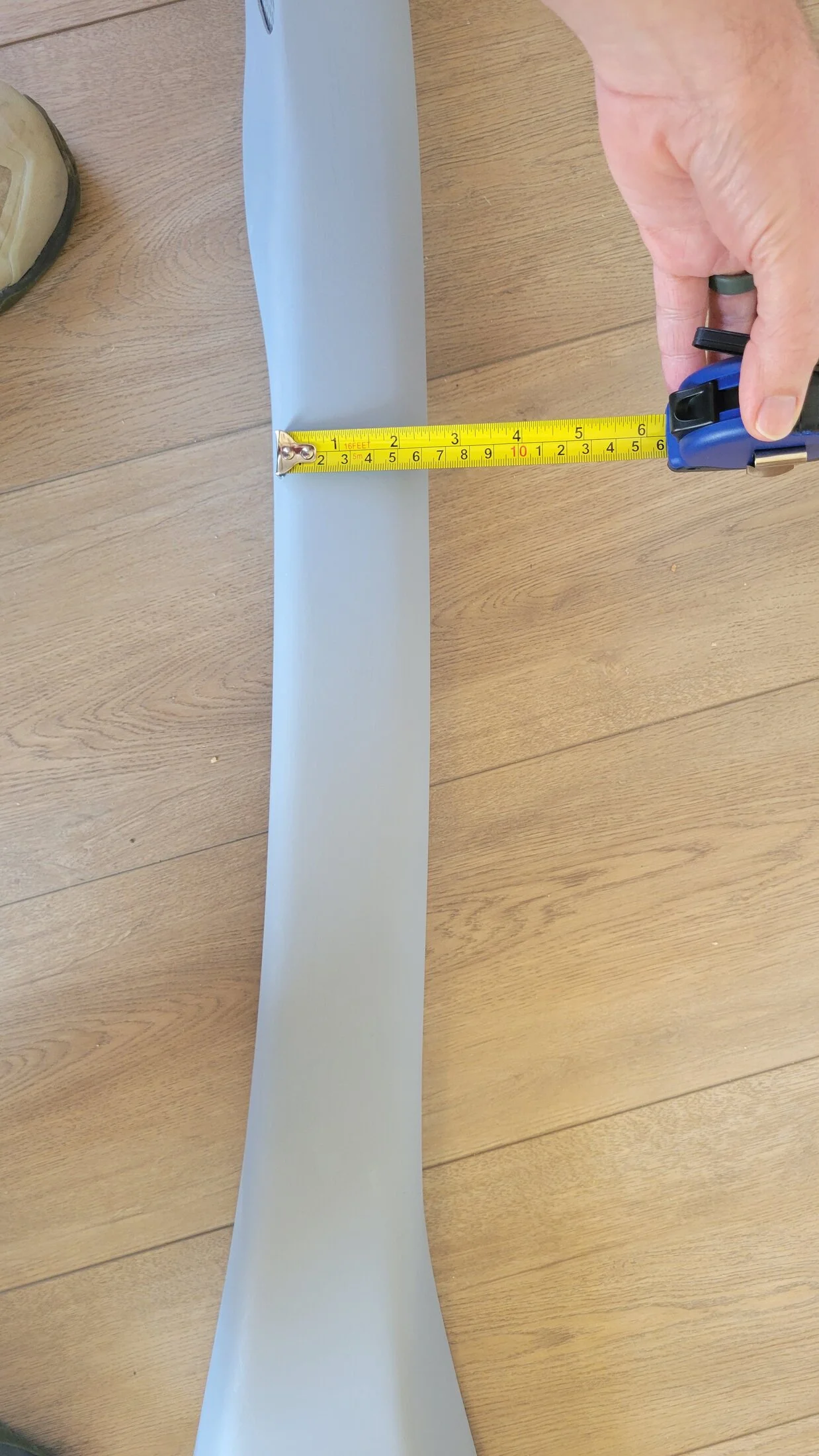

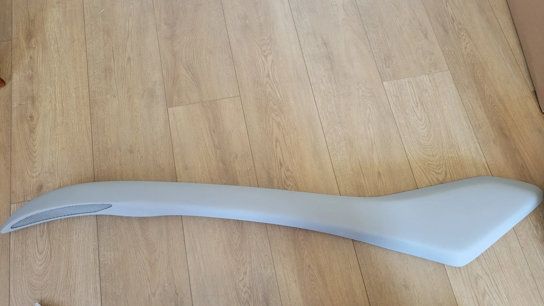

So the Lenz snorkel finally came in. I actually did not find the quality to be that bad - considering it is handmade and the price was OK.
BUT, there is absolutely no way I'm putting this on my GX. After taking the measuring tape to it. the cross-sectional area is about 25% less than the engine's air intake tube in the neck up the A-pillar (where it is about 2.5" square) and a whopping 40" less where the outside tube goes into the fender (where it is about 1.5" thick and 4" wide). With the inside of the tube being rough fiberglass, I don't see how this isn't going to restrict air to my 2UZ-FE. I've spent too much time on headers/exhaust/tune/etc to choke the engine. So, this will be going on eBay for a US-buyer to get at cost without needing to order from Israel.
