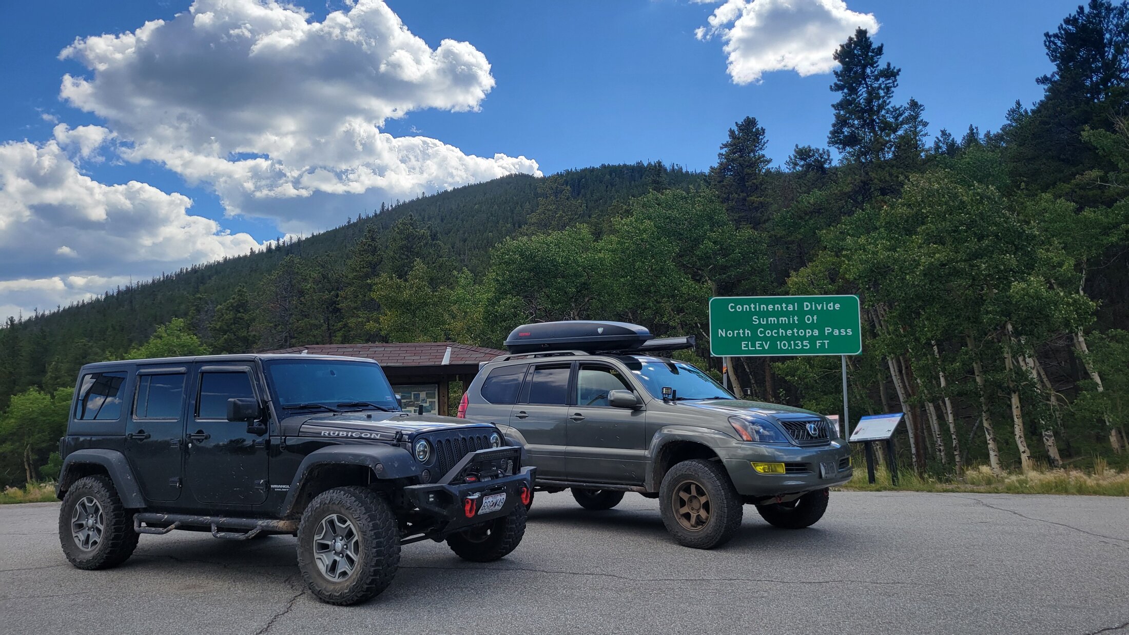

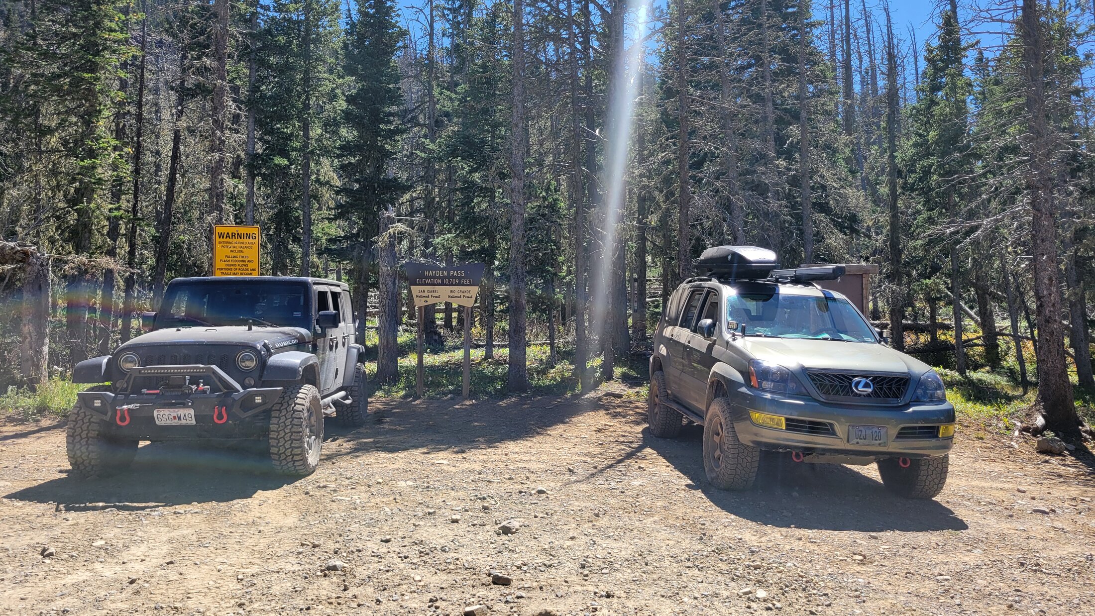

And all done. Crossing the plains tomorrow and heading home. Tired after climbing a 14er this morning and wheeling, hiking, gold panning, and exploring for 8-10 hrs most days. Epic trip with my buddies. The GX did great. Damage includes a couple wheel gouges, missing rear bumper clip, and new smash in the skidplate. Can't believe how well it wheeled with 33s while being super comfy and dead reliable zipping 80 mph across Kansas.
Looks like you had some good fun! If you had to put a finger on it what would you say was the most important mod for your trip?
Probably the combo of skids, 33s, and a lift. This gave my GX quite a bit better clearance than the 2" lifted JK Rubicon on 33s we wheeled with, and allowed me to tackle the vast majority of the obstacles faster and easier than a SFA rig. I have around 13" of clearance under the front skid and probably 18" or more under the sliders (which, I never once touched on this trip!). So clearance, clearance, clearance won the game. The traction of the AT4Ws (better than the AT3Ws) aired down to 18 psi, ATRAC, and picking good lines did the rest.

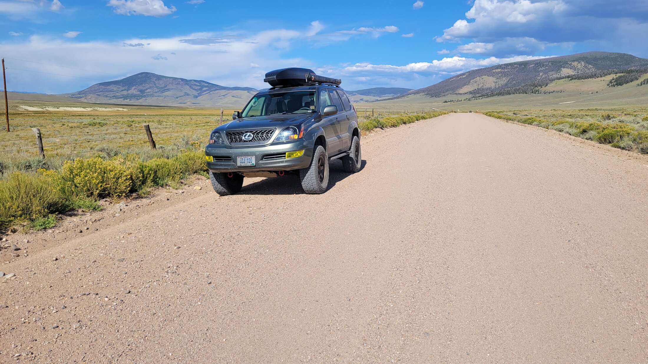

I usually run 87 at home and run 85 up there. Zero issues and the rig had plenty of power (way more than the Jeep!), but I also have an 87 tune on it. It got some pretty crazy MPG at altitude too, including 18 mpg on a run from Creede to Walsenburg where we ran Medano Pass. Overall that's a big drop in elevation, but we have at least 15 miles of wheeling in 4 low and some fun in the sand as well.
It was also interesting that the Jeep basically got the same MPG as my GX and had the same-sized fuel tank. We were usually within 1/8 of a tank of each other on gas, which made stopping to re-fuel easy.

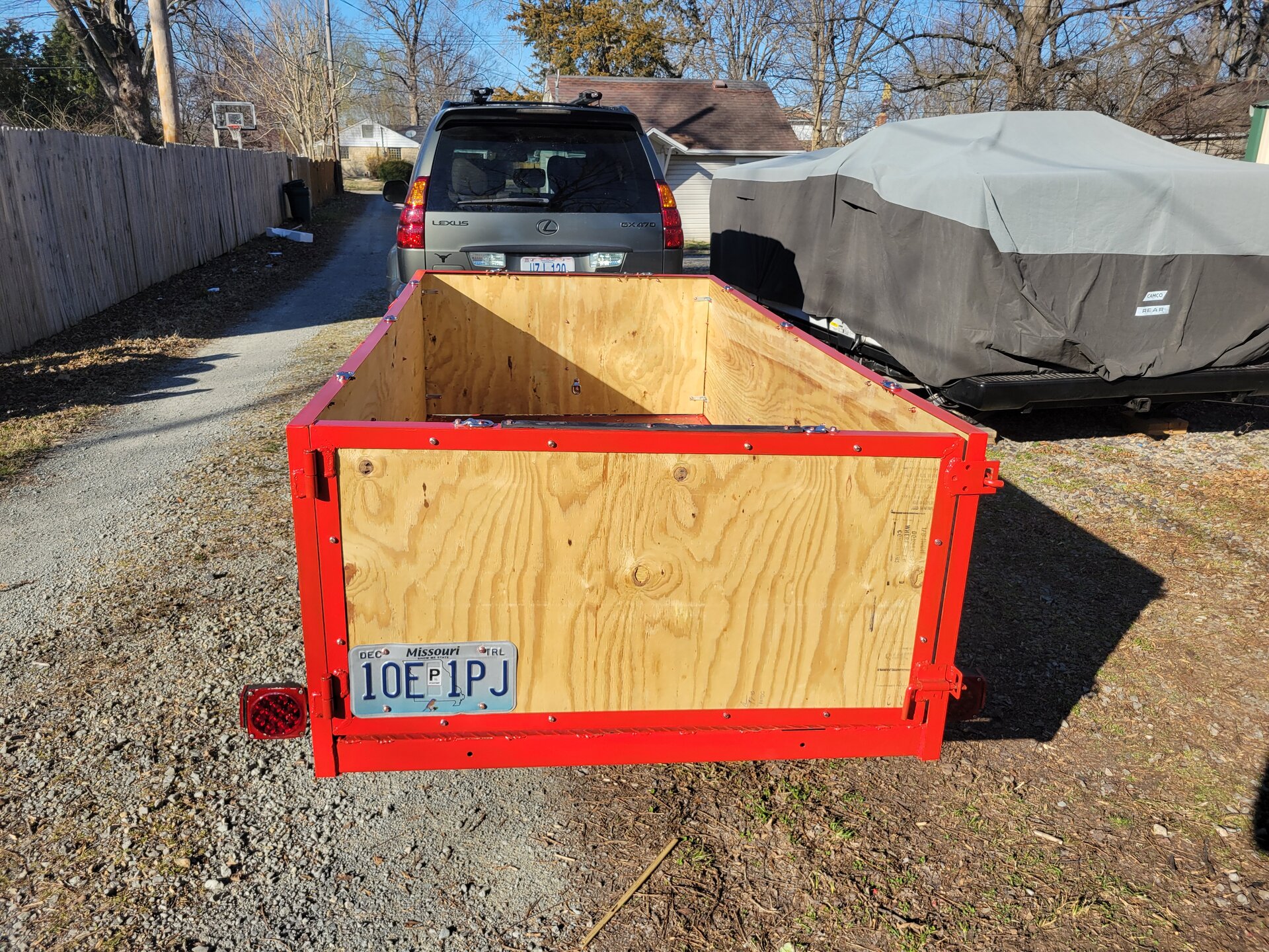

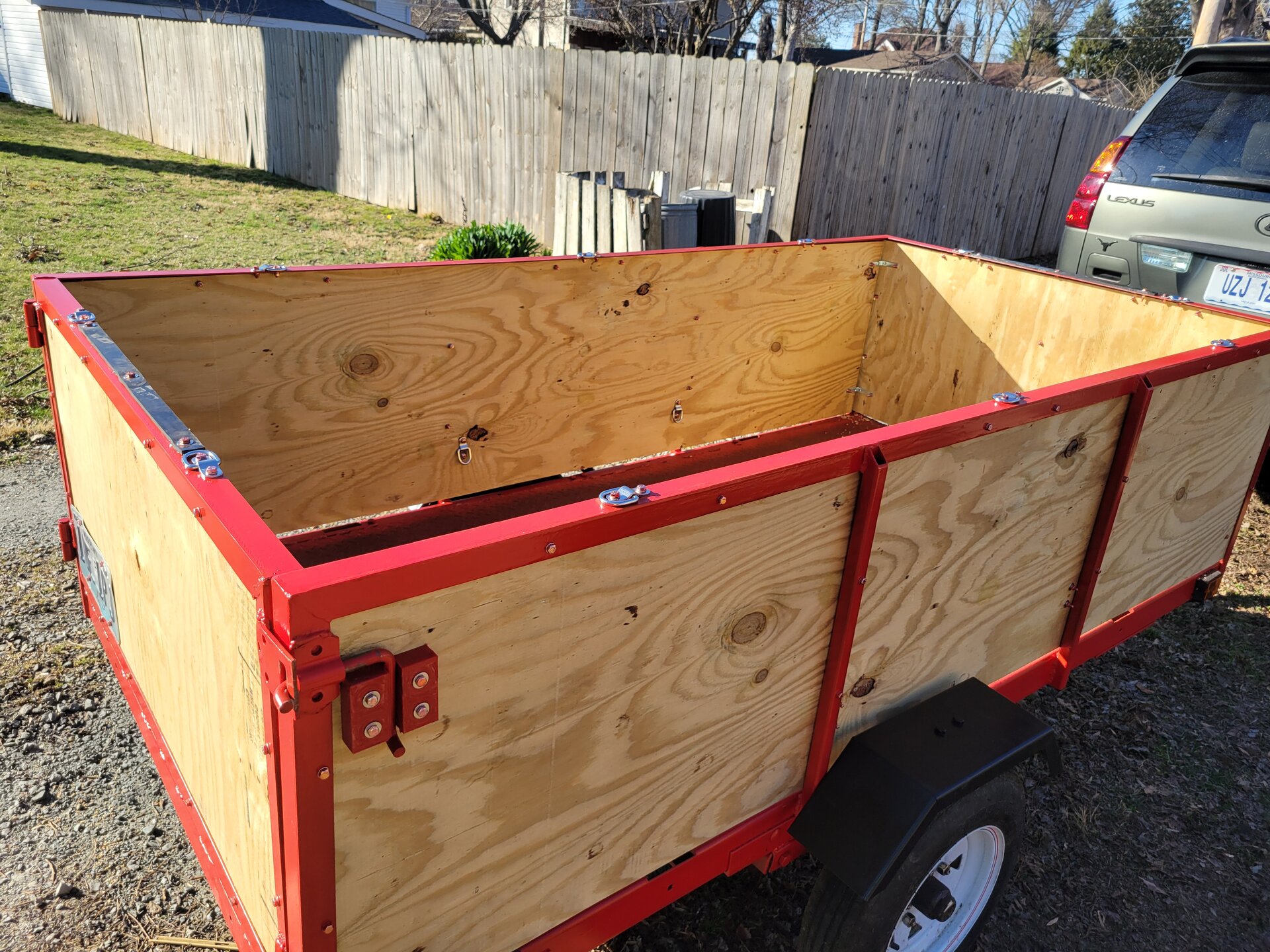

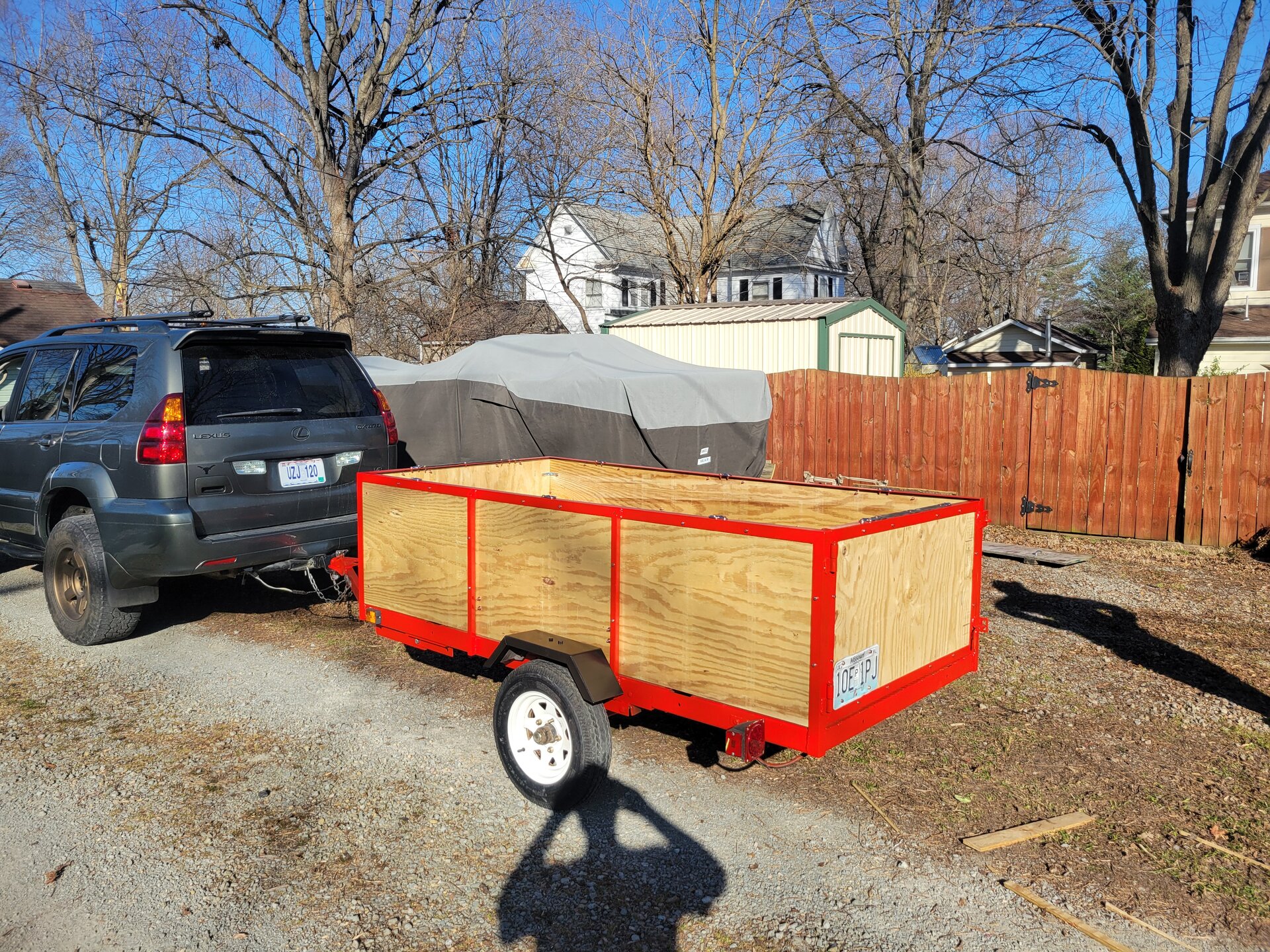

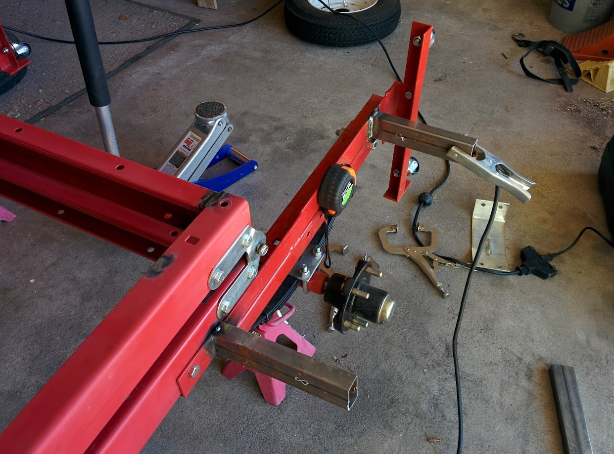

In other GX-adjacent news, the rebuild of my 2015 Harbor Freight utility trailer is complete. This had a DIY treated plywood floor and sides that rotted out over the past 8 years. I fixed it with 300# of steel that included a 14-ga diamond plate floor and a new and extended C-channel tongue (built from scratch, as the old one was twisted) that allows me to actually see the trailer while backing. I built the upper structure out of 1.5" angle iron so it'll be easy to replace the new plywood in the future. My welding and fabrication skills went from bad to novice during this job - glad to practice on a cheap old trailer instead of something nice. Running my Hobart 210 MVP on 120V did prove challenging - can't wait to be in the new shop with 220V so I can more easily weld thicker stuff.
I do have a few areas to touch-up with more Ford Red tractor paint, but otherwise she's already been used and is way more sturdy than the old iteration.

Weld up the seams?
and make supports for those floppy fenders so you can stand on 'em! ;)

Thanks man! I've been working on it too much if anything :). Ready for a break for a while! Love your fender mod on the HF trailer - will do the same on mine! The crappy bracket has broken before.

My best MPG ever was in CO, got 21 MPG cruising slowly downward in elevation, but like you had a few miles of slow going 4LO exploring on last dollar pass.
When I went in 2020, it was in my friend's preVVTI LX470 on 33s. That thing felt like a dog going up hill, was always gear hunting, and never returned over 15 MPG. Meanwhile the GX feels great in elevation. It doesn't feel all that much down on power versus home, and is happy to climb hills around 2.7-3k RPM. MPG on the highway is always above 16-17. Granted, between the weight, VVTi, and smaller baby 32s, I can't be that surprised.
