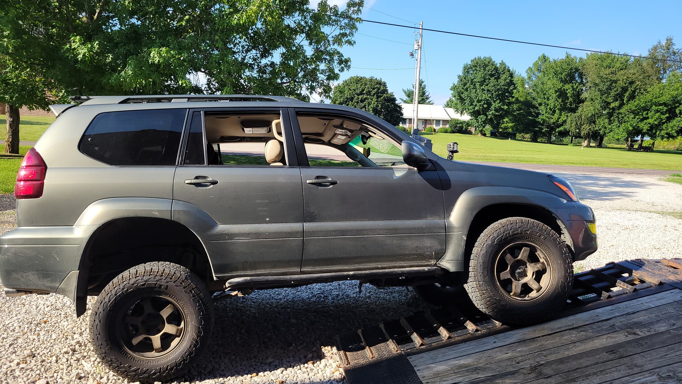

While we were there we flexed out the rig. Pretty impressed with how well it did for a non-KDSS GX with a front sway bar connected.
Tons of stuff in the back. With a stock rear bumper and control arms, I don't think there is much room for anything beyond a 34" tire in one of these unless you want zero-clearance or set the bump stops a bit higher. It's just about perfect with 33s. Pushing the axle back with adjustable LCAs and using an off-road bumper would probably clear 35s.

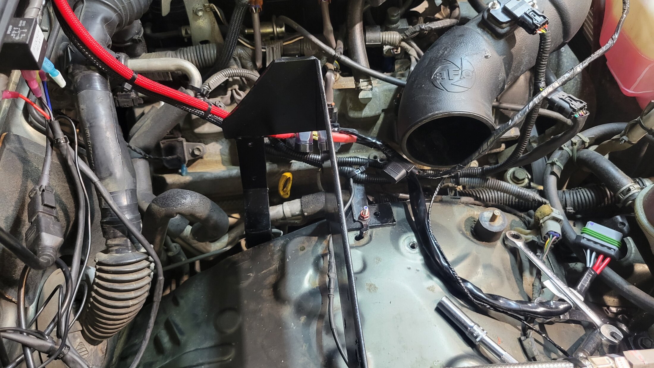

My good luck from Sunday appears to have ran out. Got the ARB, but FedEx must have dropped it during shipping! Will be filing a claim with Jegs in the AM (they had it the cheapest with a new customer discount). This compressor is beefy. It weighs nearly 20 pounds. Other than the shipping damage, I am confident it will last much longer than the Smittybilt junk as it's definitely a well-engineered and well-built little machine.
I'll also have to re-do my mount so the compressor is vertical. I could fit it as-is but it would require a 2" spacer and the fan would be blowing on the engine wiring harness and some of my aux harness as well. It'll be much better-ventilated going the other direction.
ARB twin install and bracket fab. First job in the new shop! Amazing how much room there is, even with half of it full of construction materials.

It’s amazing the stance difference with 285s,
Looks really stout! I will do the same once mine wear out. Congrats on the new shop. Looks like plenty of room for more toys!
Yeah 33s look great…
