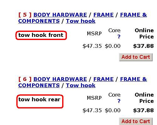

The factory loops aren't really "recovery points" either. They are shipping tie-down points.

They aren't tie down points, they're recovery loops. Early trucks only had one in the rear, on the LHS - this wouldn't be suitable for vehicle tie down purposes, they were meant for something else.
In the US these were equipped with leather seats & moon-roofs and primarily marketed to soccer moms. More likely to be shipping tie-downs.
