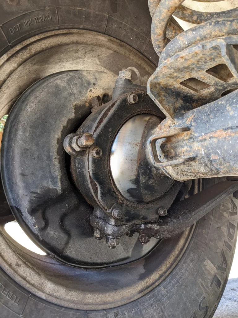

I've changed the oil from 5W-30 to 15W-40 Rotella since it's still pretty warm, and have some 285/75 AT4Ws ordered. I've got some minor coolant leak(s) at what I believe is the rear heater valve, front axle seals look suspect, but she's done great for the roughly 100 miles it took to get her home.

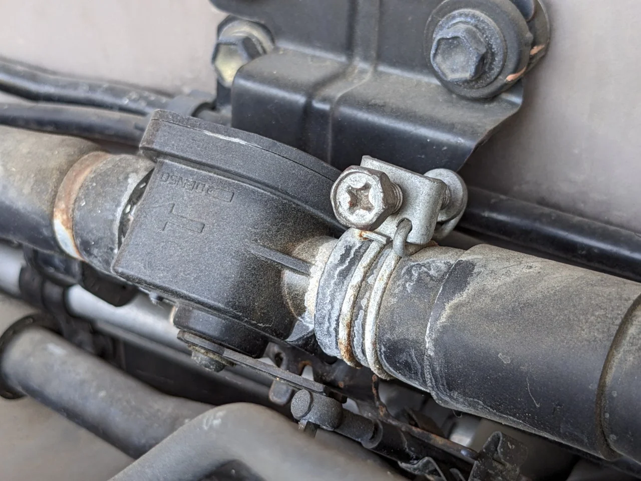

Not sure whether I need to replace this piece, or just need new hoses. Planning to dig into this and the axle seals once it's not 100+ degrees out.

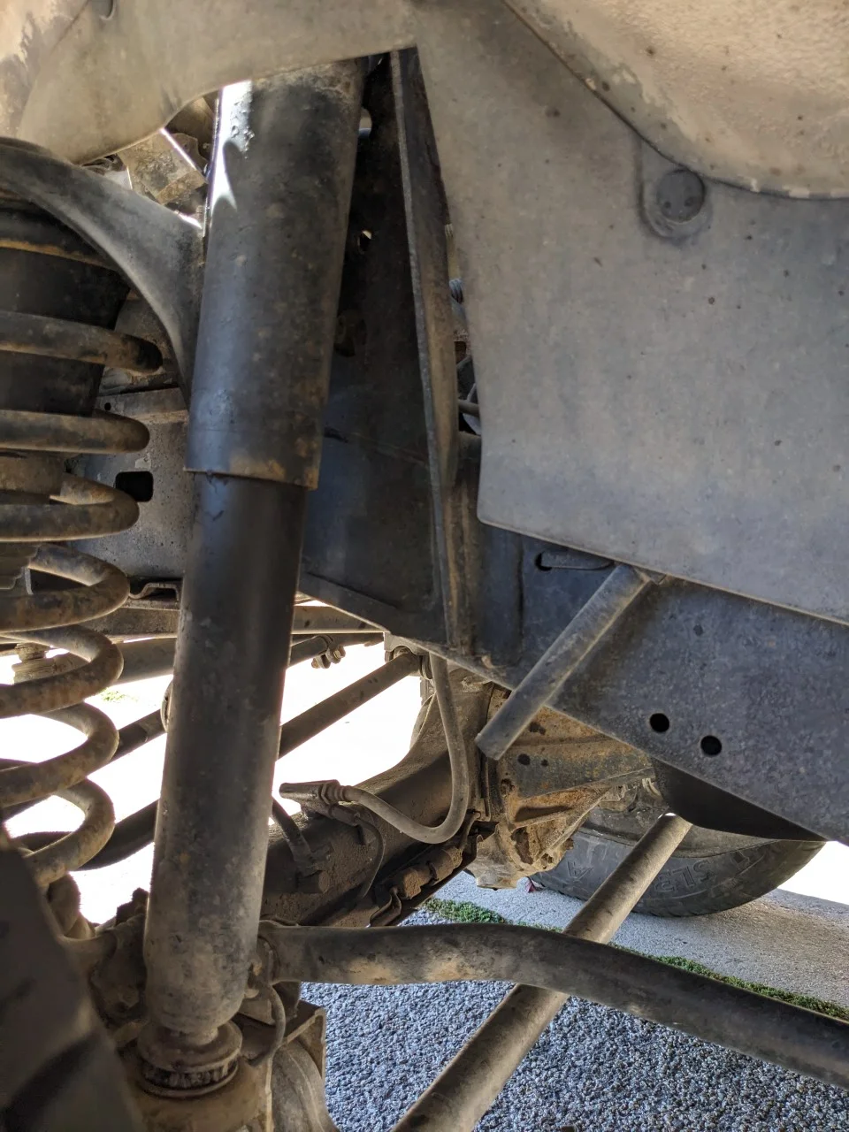

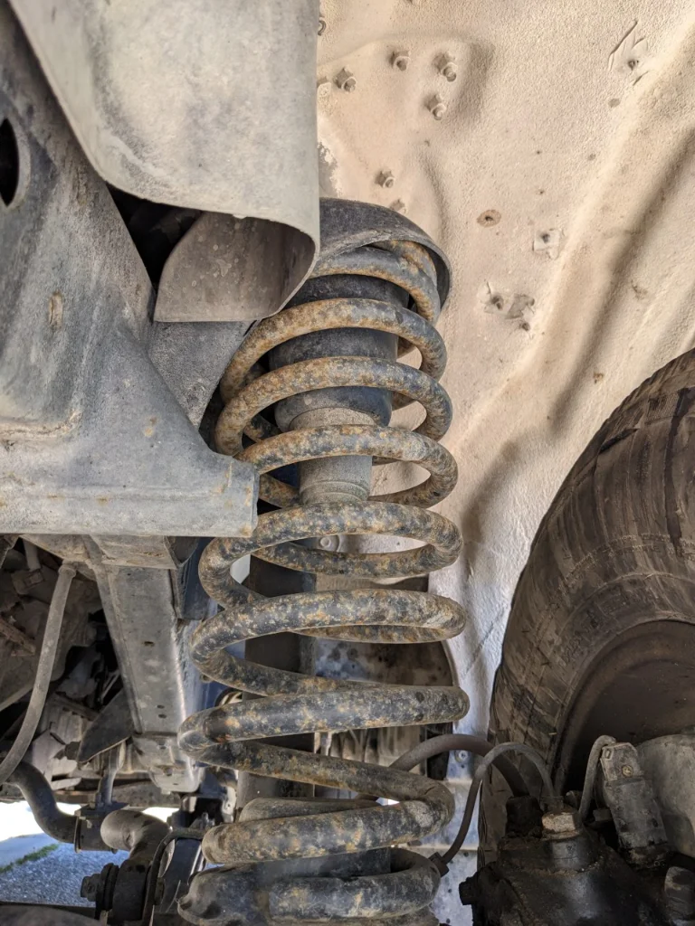

I'm a bit unsure of what's going on with the springs/shocks. This thing is way taller than most of the "stock" 80s I've seen online, but none of this looks like aftermarket stuff to me. Did some of these come with factory lifts? It's currently on 270/75s and they look a bit undersized to me. I went with 285/75 for the Wildpeaks since my research said this size fits stock; hopefully these fill the wheel wells a bit better.
Not sure whether I need to replace this piece, or just need new hoses.View attachment 3970898
Cool cruiser! I'd go ahead and buy a new heater control valve, usually if they are that far gone, when you try and change the heater hoses the plastic heater control valve will break apart. You can still buy both the hoses and valve from Toyota. Some dealerships are cheaper than others, Stevenson Toyota west here in Colorado offers pretty good deals for online orders. Shop around, but I wouldn't wait too long to replace it.
If the hose still has those odd factory worm gear/twist clamps, it probably needs replacing.
Don't skip the PHH (Pesky Heater Hose), it should be easier to get to on a RHD rig.
Good luck, and welcome to the family, go ahead and burn your wallet before it's too late also.
I just finished watching a video about the PHH and was thinking I may as well do 'em all in one shot. Thank you for the suggestions, I'll see if I can get those in hand before next week. Hoping to get this thing on some trails on Monday!

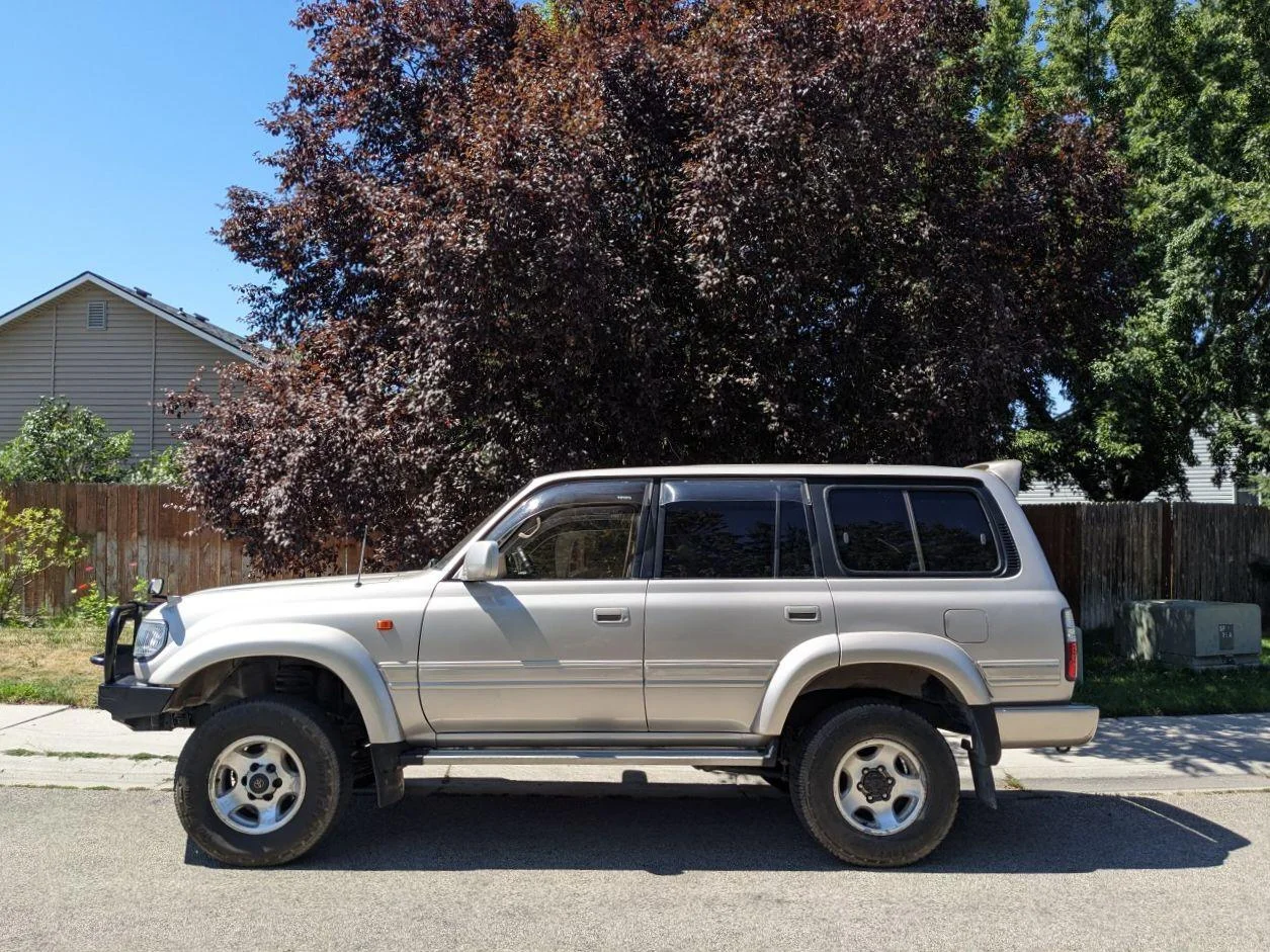

Preetty good looking rig! Rust and oil leaks are not so badA

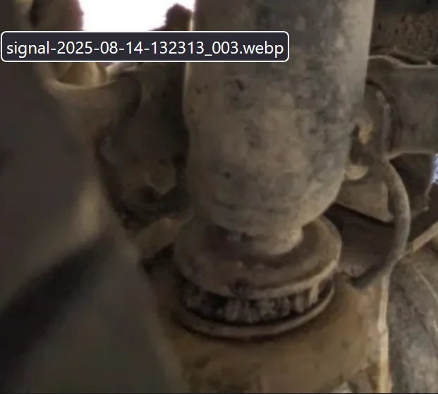

Shock bushings look to be toast. This can lead to more play in the suspension as the rubber collapsees and gets loose.
Oh yeah, most of the bushings are pretty shot. That’s actually the first big project on my list once it cools down a bit (and once I sell my CTS-V). It starts and runs great, and the oil leaks are all real small from what I can tell, so I’m going to tackle steering and suspension, then brakes, and finish the “restoration” with addressing the leaks. Hopefully I’ll have enough left in the budget to add some armor this year.

Shocks and springs may be aftermarket, just sprayed black.
You can get a gauge on its lift by measuring from centre of hubs to top of the fender arch. I think 20" is stock.
They're definitely not painted, unless someone did an incredible job. Possibly powdercoated, but I've never heard of anyone doing that with shocks. I suspect the springs are aftermarket. Not sure about the shocks, but I'll be swapping everything out w/ OME bits in the spring anyway.
