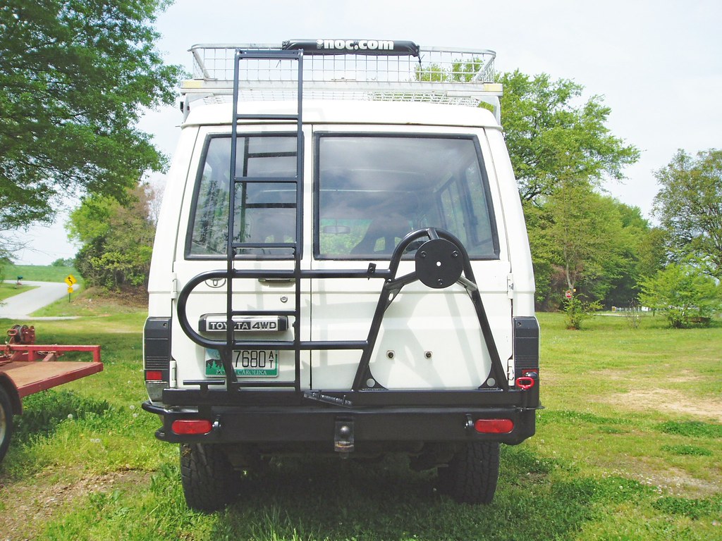

new rear bumper
Last month I dropped the Troopy off at the Toy Outfitter/Hardline Fabrication. Stan, NCFJ, fabricated a new rear bumper w tire swing out and reattached the basket after the repairs to the rain rail. The following pictures show the progress:
additional improvements
In midst of the fabrication, NCFJ thought of a great modification to the basket rack & side ladder...move the ladder from the passenger side to the swingout.
In addition, he fabricated new hinges for the driver side door. The OEM hinges were destroyed from the weight of the spare tire and bad design.
Pictures to show both additional fabricated modifications will be forth coming tomorrow and will include a description of the new hinge.
Nice work there. Very clean.
Thanks guys:) It was fun to build something different for a change. The Troopie's rear cross member made things interesting. It is actually an add on to the frame, I am only asuming to s stock 70 series frame. It has tabs that slide inside the stock fram rails and also adds angle bracing.
Very stout, just odd. Made for interesting frame attachment issues. Where usually there are straight flat inner frame rails with holes that only require drilling out larger, this was stepped and had few holes to use. I ended up welding a capture nut plate to the sides of the rear shackle mounts using the two only available holes.
I added a cross member to the frame to carry the inside end of the 2" receiver.
The rest is a pretty standard hybrid plate/tube bumper. The latch handle has a hood to keep water out. There is a 1" OD tube that the latch bolt runs through. The bolt has a hood with an ID of 1". When tight the hood covers the stub on the arm for about 3/8".
All it needs is a tire and a Hi-Lift
