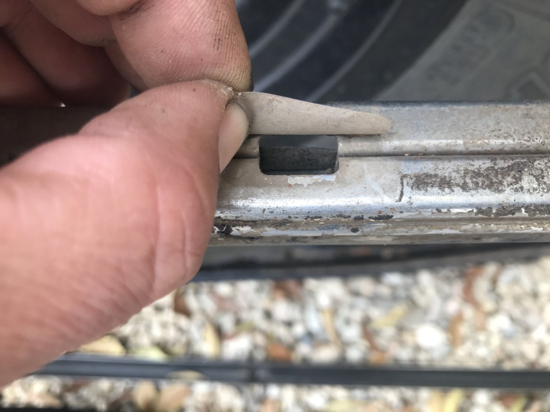

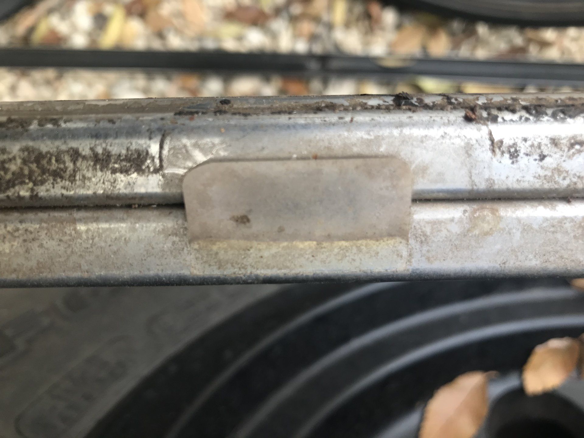

On a 70 it is not a sponge but a little piece of clear firm plastic.
Cheers
Oh Yeah I have those too! It looked like on the forward drain vents (towards the front of the car) there was clear plastic that covered them. I am planning on doing that. But the back 3 vents (the ones past the center wiper post) have no such plastic covers (or any evidence of it that I have ever seen) and that is where I was questioning the inclusion of the "sponges". Hmmm, the plot thickens.
Did you just do the plastic covers on all the drains?
Oh Yeah I have those too! It looked like on the forward drain vents (towards the front of the car) there was clean plastic that covered them. I am planning on doing that. But the back 3 vents (the ones past the center wiper post) have no such plastic covers (or any evidence of it that I have ever seen) and that is where I was questioning the inclusion of the "sponges". Hmmm, the plot thickens.
Yes I did.
There was no foam in them when I took them apart and none shown in the parts diagrams. So I think the foam is specific to 60-series. The Troopy and 73-series have a different style for the sliding windows. All the drains on my 70, six per side, had the little clear plastic strips over them. I bought new ones. The only part NLA for 70's was a little rubber pad at the top center divider in the steel frame, over the top of where the tiny screw goes. For those I carefully removed them from the old frames and siliconed them to the new ones.

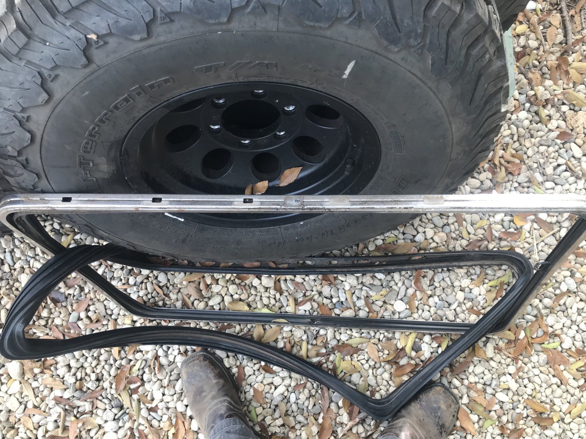

I was not able to find the rubber seal that adheres to the outside of the window frame.
Did you find a source for that piece, meant for FRP top?
You can check this thread, Post #38 BJ73 FRP windows
Hey FYI, I think the foam is what the FSM & parts books call a spacer. Mine didn’t have any in it and it was NLA so I went without.
Mine are in now.
No butyl tape used on a SWB 70.
Drains work well and no leaks on the new ones.

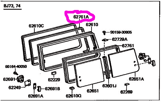

Maybe the side windows in my FRP top are different.
I am looking for these parts
62793-90K00 RH
62794-90K00 LH
