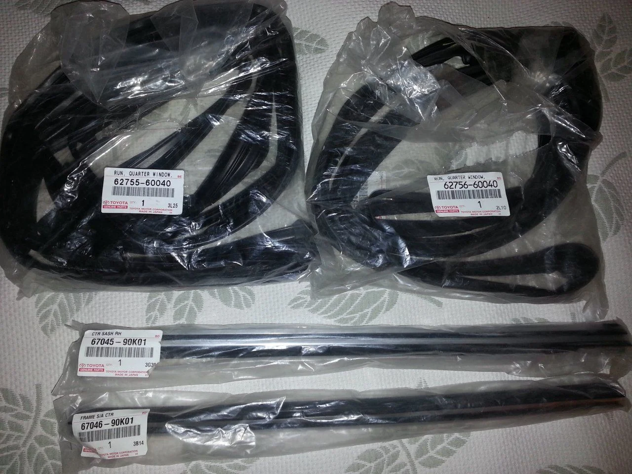

I got these from Yan about a year and a half ago. I haven't found the time to pull the windows and get the frames bead blasted and powder coated.
Hey Dan, do you have more pictures of those center wiper posts? How long are they? Are they discontinued? Just curious if they might work for the 60 series sliders as well.
They should still be live but not in this market. Beno, Yan or similar would be a possible source.
These are NOT the same as a 60. The sash and the weather strips are not integrated on a 60 like they are on a 73/4. The window height is also different.

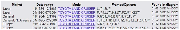

Interested in this inquiry; I just finished a complete paintjob and couldn't redo the FRP windows since the weatherstrip that goes between the FRP to and window frame is NLA.
I contacted Cruiserparts since one of the part numbers retrieved a result after a google search but answered this was NLA,too. However, they had a replacement that could be used:
Side Window Weatherstrip No. 1 for 85-99 70 Series Cruisers [D 62794-90K00] - $49.99 : CruiserParts.net, Toyota Landcruiser Parts

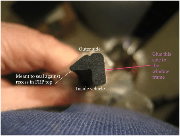

I bought the FRP window weatherstrip that CruiserParts sells. They only have the LH side.

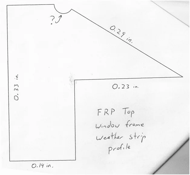

Here's a pic of the profile of the rubber and a measured diagram of it.
I looked on various sites that popped up when I googled auto weather strip: nothing matches.
