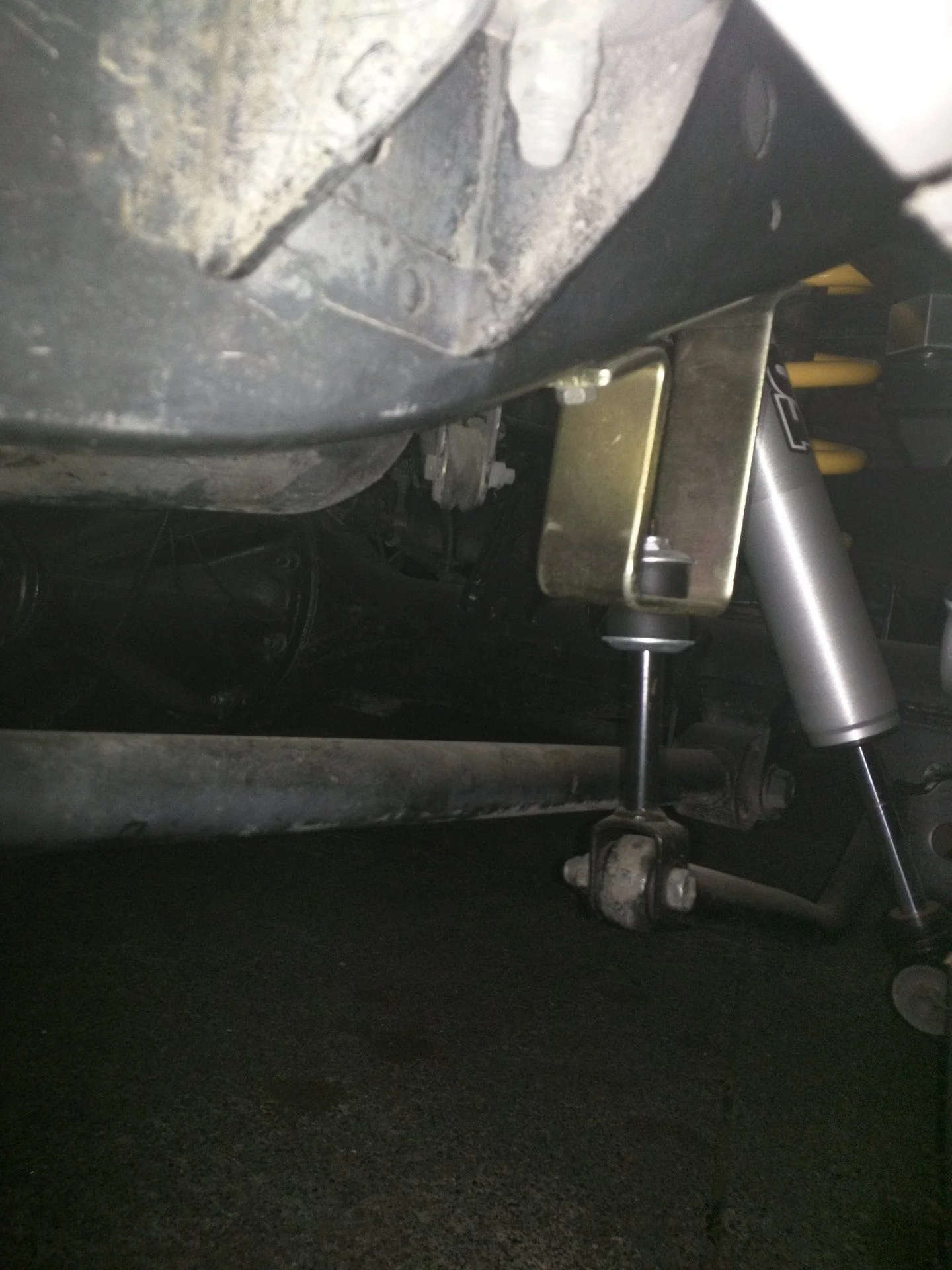

Bought these extended sway bar brackets when I did my 2" lift awhile back. I got them from Metal Tech and they were for 2-4" lifts. The problem is they seem too long? I don't like the way the bottom of the link is sitting just below the lower control arm. Seems like a natural catching point. What do you guys think? And are there any extended brackets out there are that are less extended, or extended links that are extended just a little bit (all the links I've seen seem made for 4+" lifts)?

I'm running about a 2" lift. And felt the need to extend the links I added about an 1.25 inches. Now I can drop out springs without removing sway bar. I kept the sway bar just above the lower control arm to keep it out of harms way.
