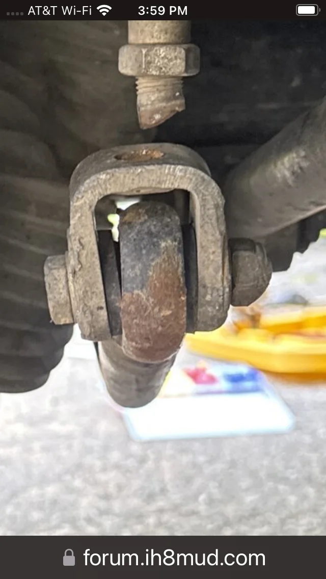

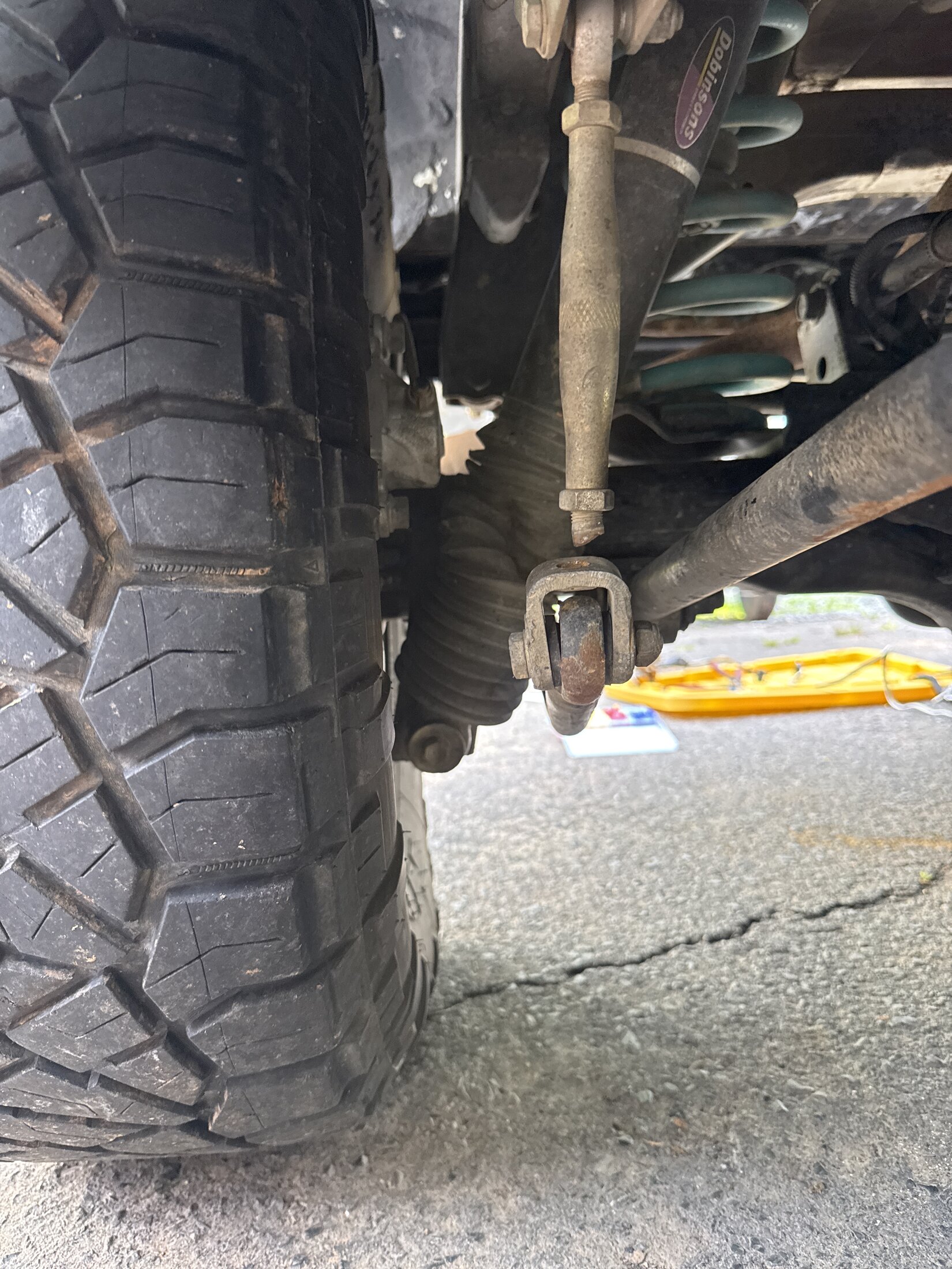

Was driving through town today, took a swift right turn at a stoplight and heard a loud pop. Got out to see what it was, after looking around for a bit, sure enough I’ve broken a link. Thought these things were supposed to be super heavy duty, they’re barely a year old. Does landcruiser phill stand behind his products ?
Looks like you do some rock crawling. Me too…. Bolt on products are not always the end all be all solution for knuckleheads like us. I’d weld that back together and go see how long it takes to break it again.

You know.. occasionally. And Yup that’s what I’m thinking man, these suckers were rather pricey tho , that’s why I was sorta hoping for a solution or at least a discount on a replacement. Gonna keep reaching out but will probably just weld it for now.

Looking at the scares on the end of the swaybar and your lower control arm you use our product for what it was designed for:grinpimp:
It does appear the lower bolt is bent also or is the pic?
Looks like the main bolt bent before it broke. How much should a 1/2" grade 8 bolt bend before it breaks?
Bottom line @ICY80 if you honestly feel that our manufacturing caused your failure I'll send you out a replacement FREE.
Otherwise a replacement part $25 shipped
