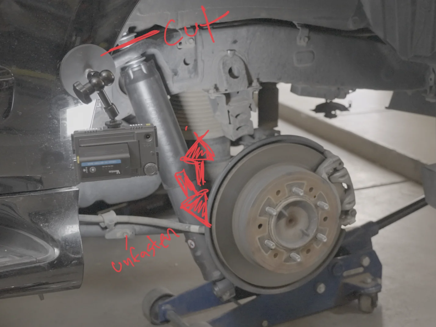

Ouch. If you can cut the top bolt off (or unbolt if it’s not as rusty as the rest of the rig) , you might try rotating the shock out away from the chasis using the leverage of the shock to crank it back and forth. The twisting might persuade it a bit more. Maybe twist it hard while your budy hits the lower mount with a hammer/pry bar. If not, you might be able to drill a bunch of holes in the lower bushing so you can twist/rip the shock off and then cut the remaining sleeve away from the mount post. It’s not much consolation but at least rear shocks are fairly cheap compared to the front struts : / Good luck.
Yeah I’ve been considering this.

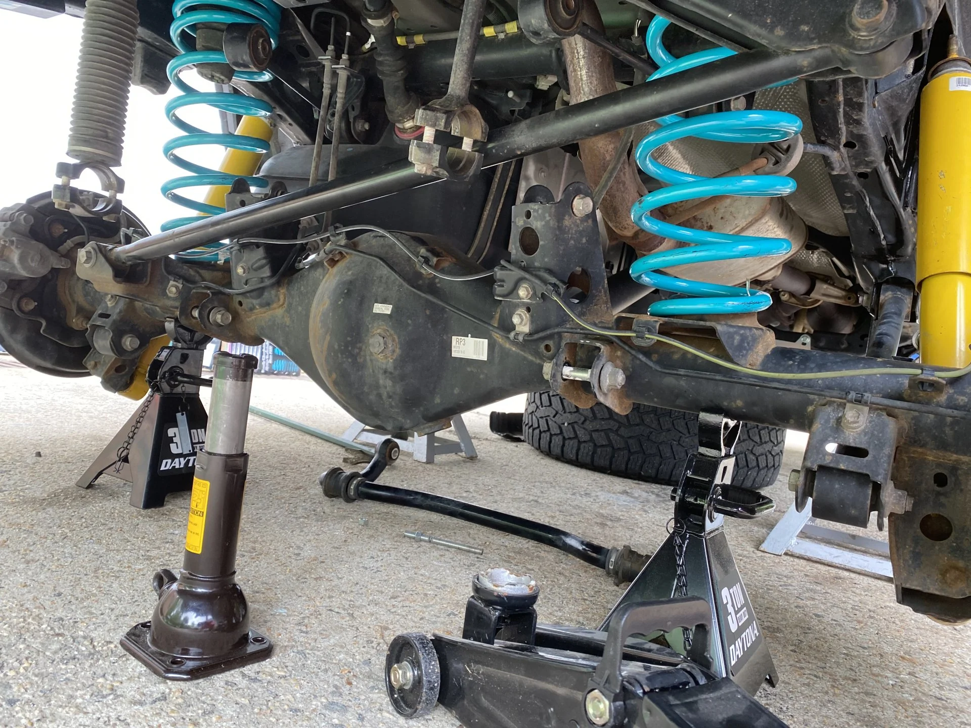

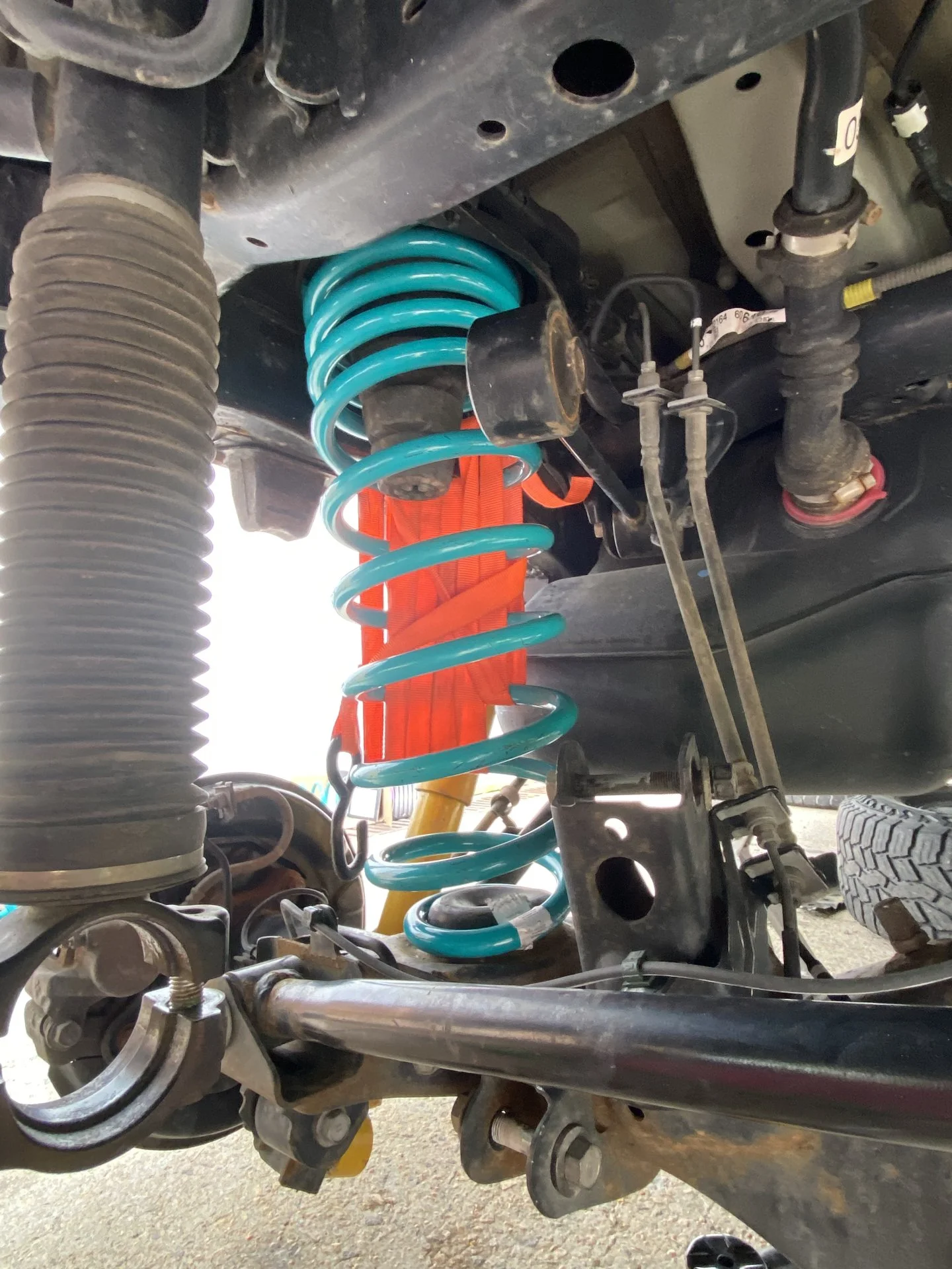

Getting the new rear coils in was another struggle. Had to remove the bolts on the links and break line mounting tab (lines were stretching a bit more than I’d like) to get the axle to drop, and even that wasn’t enough so I compressed the spring with a ratchet strap and finalllllly got the springs to go in. You can see the side by side comparison. New ones are definitly taller.
Now I’m struggling to get the axle up enough to attach the links, everytime I jack it up it starts to lift the truck before I get the links in. Going to try and jack at the outermost point I can so maybe the axle will pivot more that lift. Also considering trying to suck the axle up by using a ratchet strap on the frame…?

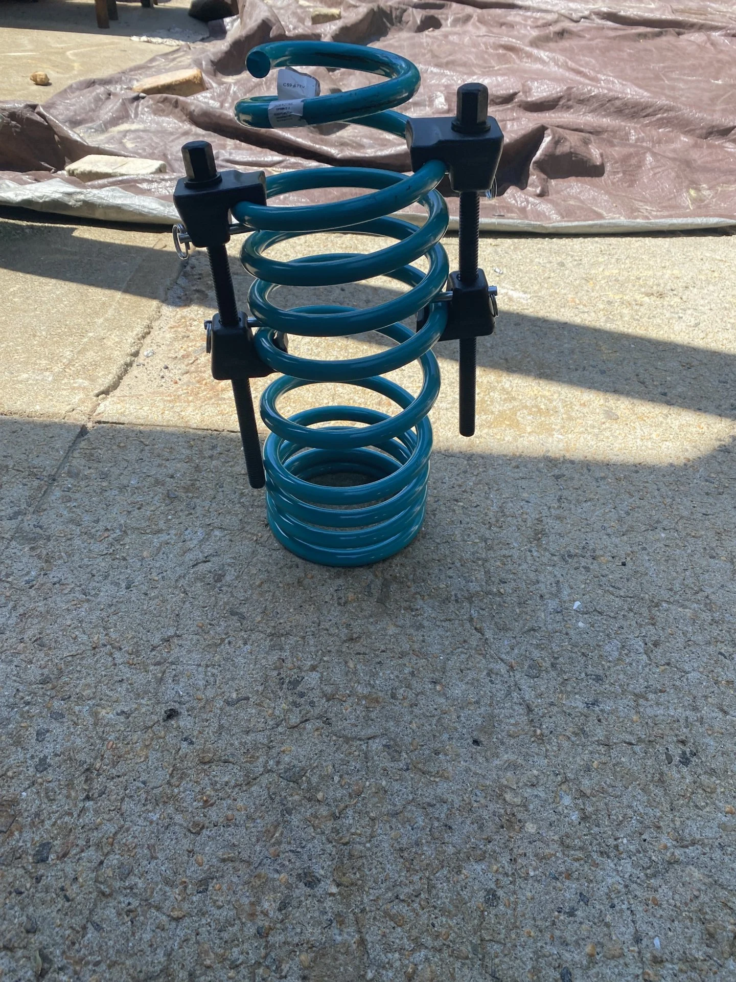

Got me a cheap coil compressor, just for the rears, makes it way easier to get them in and feels less sketchy than a ratchet strap, by just a little bit. I’m hoping they allow me to get the axle into position so I can button everything up. The new coils are so stiff I can’t get the axle up enough to re attach the links and struts without it lifting the rear end instead of compressing the axle up. But that will now have to wait, unless I can bribe my mechanic friend to make a house call..

Got the rear springs in and links attached. @fjc-man for the win. Used a big ratchet strap the get the axle to compress enough on the drivers side to get the link bolt back in!! So thanks for that! Passenger side went up better, no need for the strap, just a drift pin.

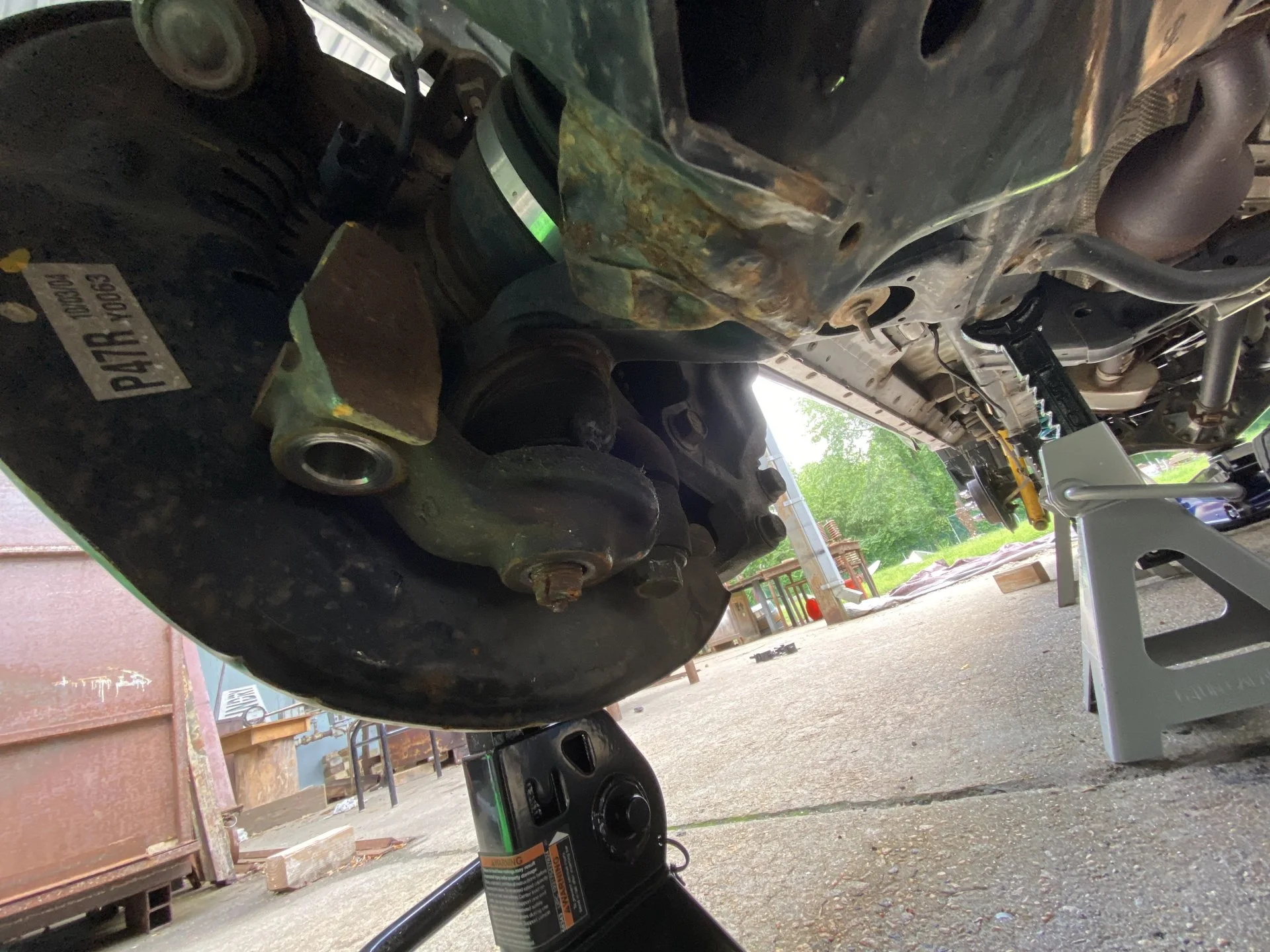

Pulled the lower control arm off the hub, via the ball joint mounting bolts(2). This allows for full drop of the LCA to fit the new coil overs in. Wish I had done this before detaching the actual ball joint up and fudging the threads a bit. But got a new dye in for that so I should be able to clean it up and get the front installed and back down on the wheels sooooon.
