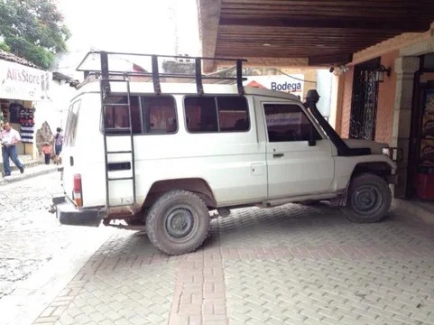

I'm really interested in this, specifically a side mount. Something like this:
I'm wondering what kind of support would be needed on the side to keep the body from flexing while using the ladder.

^^^ This particular one looks like it's mounted to the frame and the rack. Wouldn't this create to much flex in the ladder?

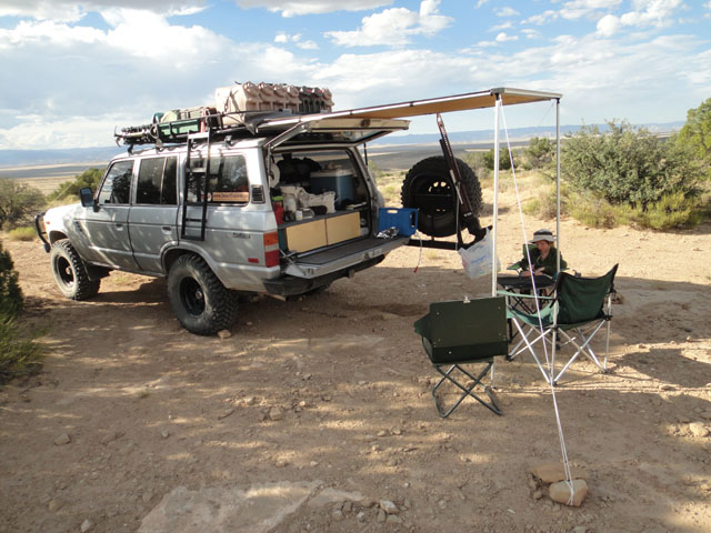

Roof rack to a ladder
Here is a couple of pictures of my roof rack to ladder design. I would encourage you for a side ladder system because you have to come up with some type of ladder on a swing out arm system. So a 4X4 labs or a Kaymar type bumper would be a good bumper with the swing out arms. Plus design it so it will not inter fear with the view out the back window.
On mine ladder to roof rack system the top of the ladder bolts into the roof rack and the bottom is weld to the C channel frame of the cruiser. I wished my welder/fabicactor at the time had made it bolt on At the top and the bottom. On the arc of the ladder or distance of the ladder from the fenders of the cruiser keep it about four to five inches from the fender. This will keep the ladder with the same distance as the side mirror. You have already learned how to drive/off road you cruiser. If your going to bang your mirror you will bang your ladder.

I would recommend avoiding a fixed side ladder. Rocks and trees will catch on it and bend it and whatever it's attached to. If you try to mount it close then you can only get your toes on the rungs.

Anther shot of the roof rack to ladder combo.
Great pics, thanks! Do you have any problems with flex since the frames moves separate from the body?
