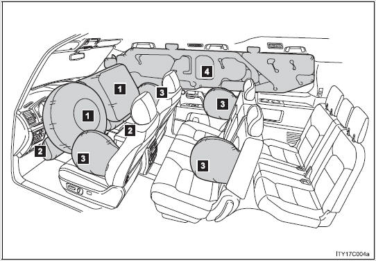

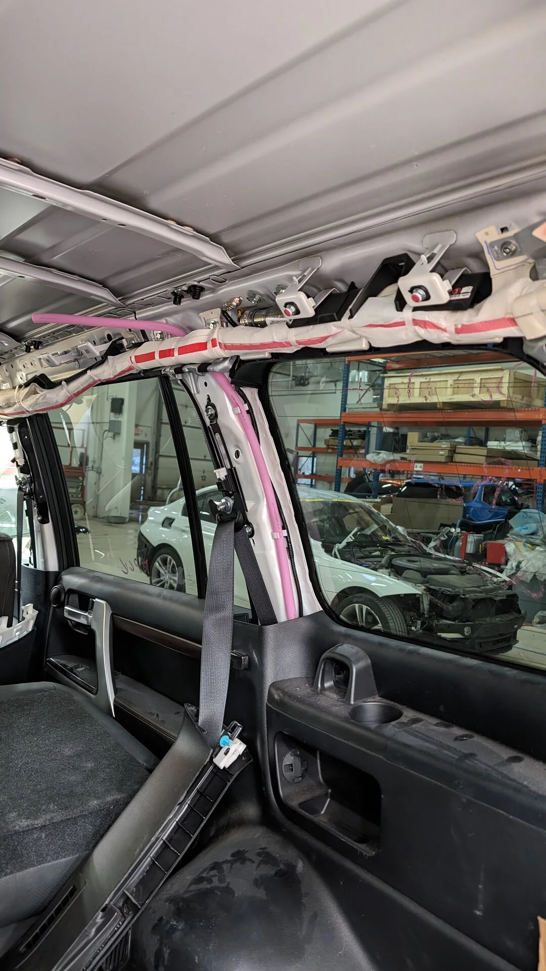

1. I removed the third row in my 2014 LX. I want to install the Victory 4x4 rear Molle panels. If I do, I feel a side impact would essential make a grenade out of this. Is there a way to disable the rear airbags semi-permanently? I say this because if I wanted to put the third row back in, I’d want them back.

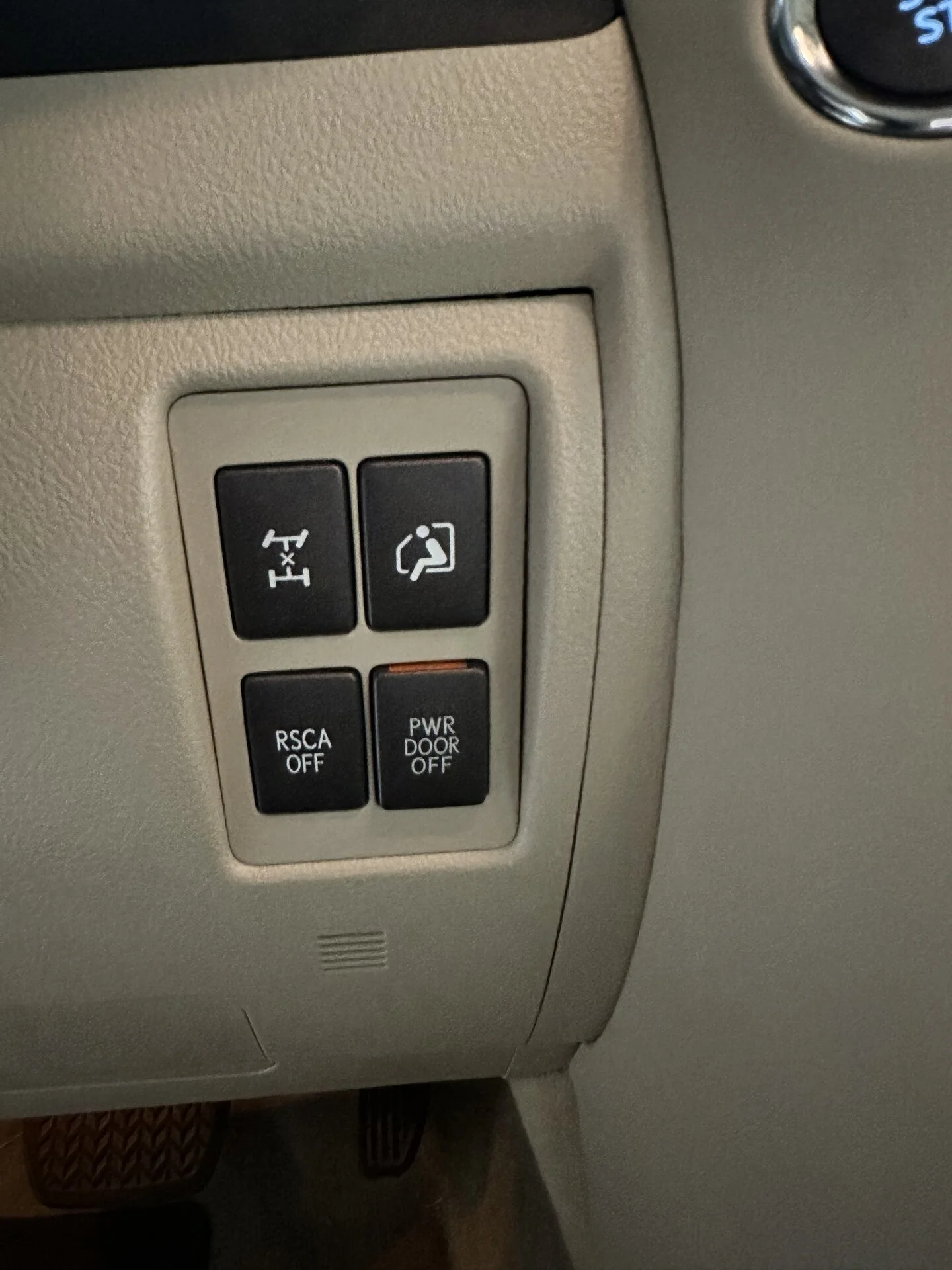

2. The vehicle has a button that says RSCA OFF. The manual says this is for the curtain airbags. I make it a practice to turn this off so that if I’m wheeling and bump a rock, it won’t explode an airbag and cause my cost that just a bump. Am I thinking of this wrong? Should I just leave it because it’s really speed that will set it off. Also which airbags does this apply to?
