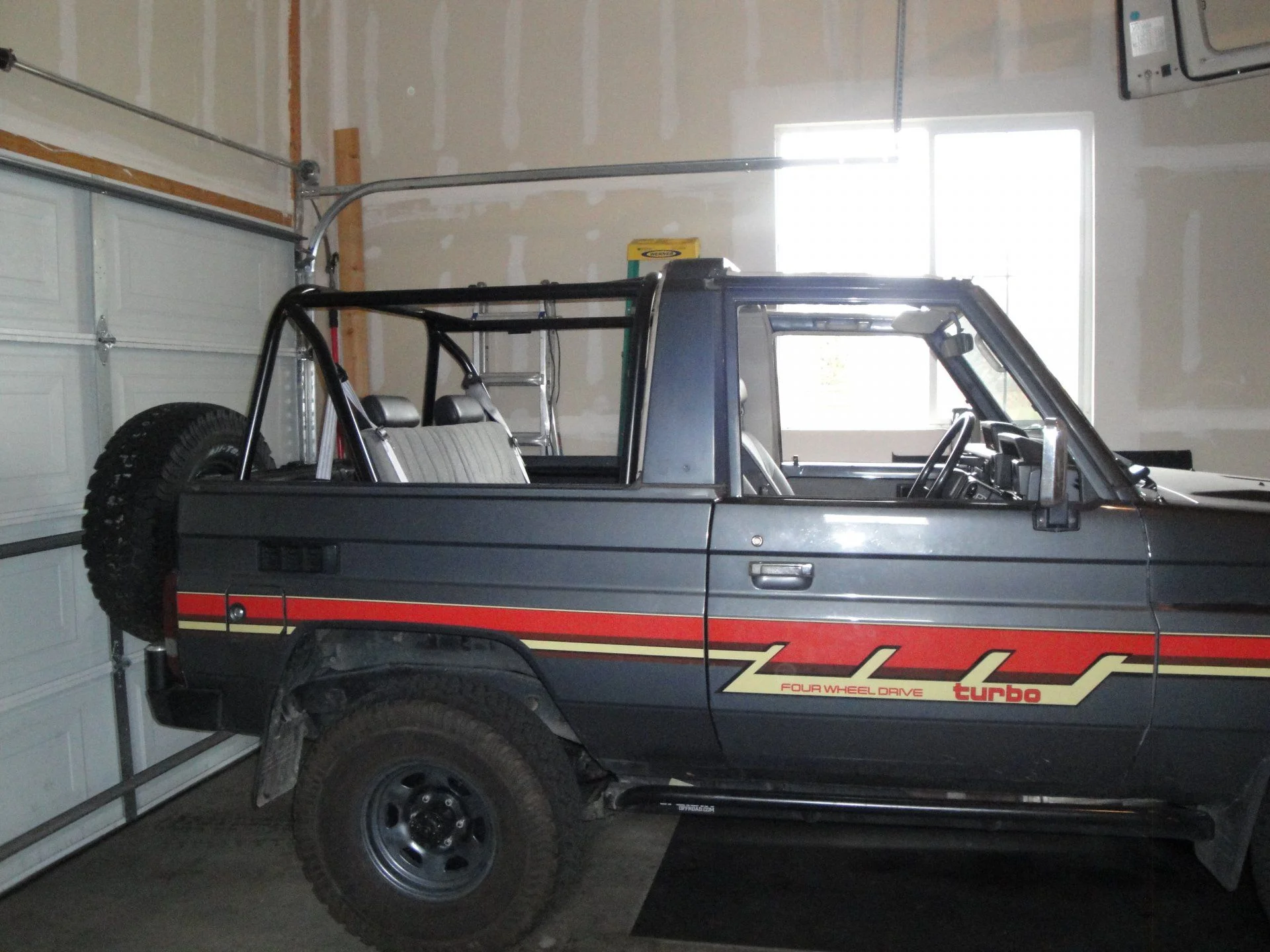

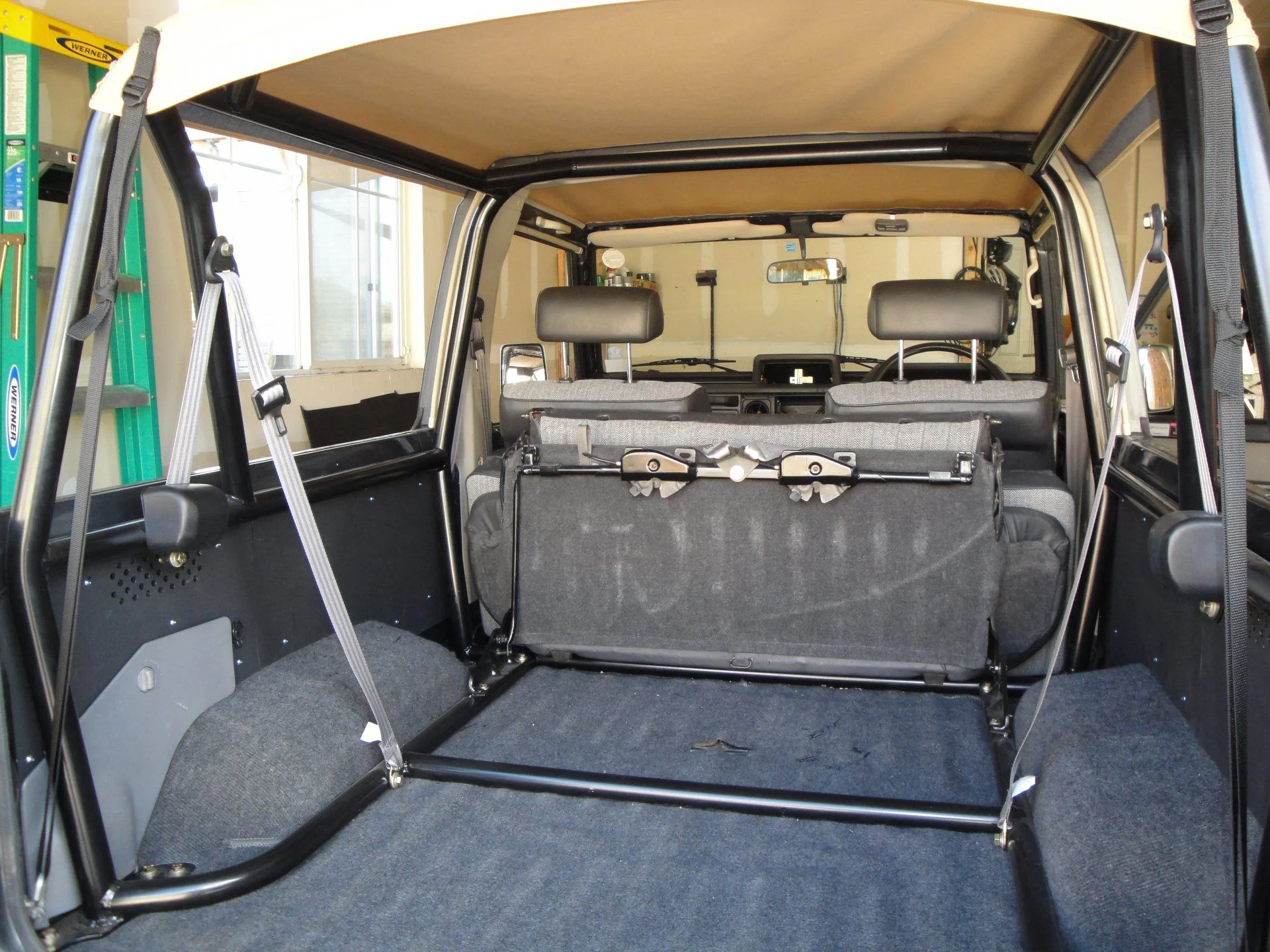

I had an aftermarket cage fab'ed up and installed which then allowed me to mount the OEM fold and tumble bench further back. It comfortably seats regular-sized adults back there now. The cage was necessary for the safety of my kids riding in back but the added benefit was increasing leg room significantly.
Funny part is that pretty much looks exactly like the cage I was looking at. Where did you get your cage done at?
@jfrench Are those your original JDM seat brackets? They look like my CDN BJ70 brackets, which, I think are the same as Euro BJ73 brackets and they are mounted in between the wheel wells. Supposedly, the Euro BJ73 has more rear seat legroom but I have not confirmed.

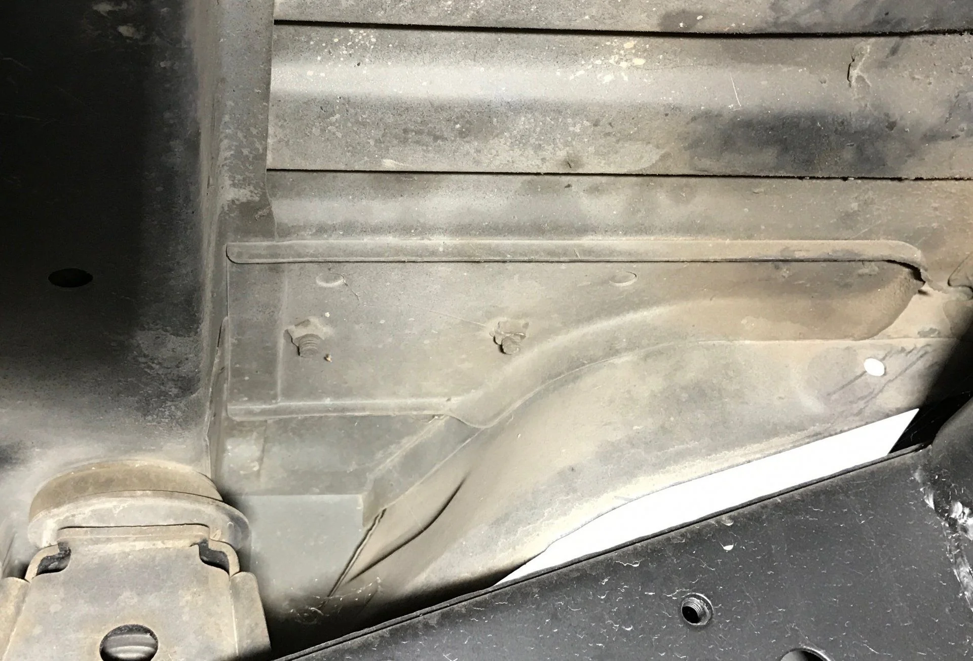

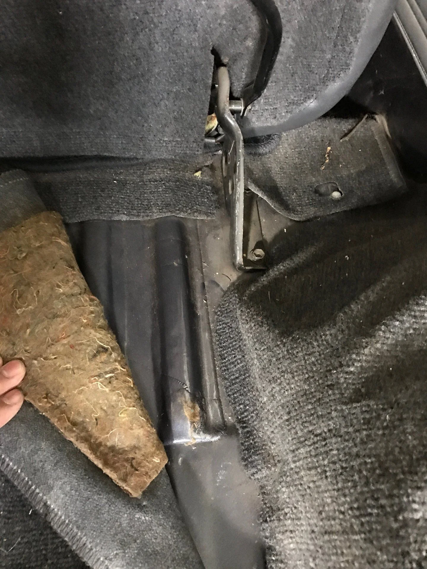

I ask because my JDM BJ74 brackets are smaller and were positioned in front of the wheel wells. The brackets cannot just be just moved rearward.
Looking underneath the BJ74, there is just one added plate for reinforcement.
If the OP has the same, smaller brackets, I'd imagine he could just modify the brackets so they bolt in between the wheel wells, then move the seat 2-3" back and remount. It even looks like the undercarriage reinforcement plate would accommodate such.
Local shop in Denver called Two Create Motorsports...quite a bit more expensive than some other local shops that I looked at but they could get me in quick and get it done on my timeline. I'm very happy with final product.
Good eye! I should have mentioned that I sourced a Euro spec fold and tumble as the shape of the bench allows it to sit further back over the wheel wells and the width between the brackets is narrower to accommodate moving it back. It could still be done with JDM spec bench seat, it would just need to sit a little bit higher. I was going to go that route if I couldn't find a Euro spec bench. So yes, Euro spec does sit further back than JDM, but not as far back as in my current configuration with the cage.
Well I'll be damned I just looked at my brackets.. they will either have to be in front of or in the rear of the wheel wells.

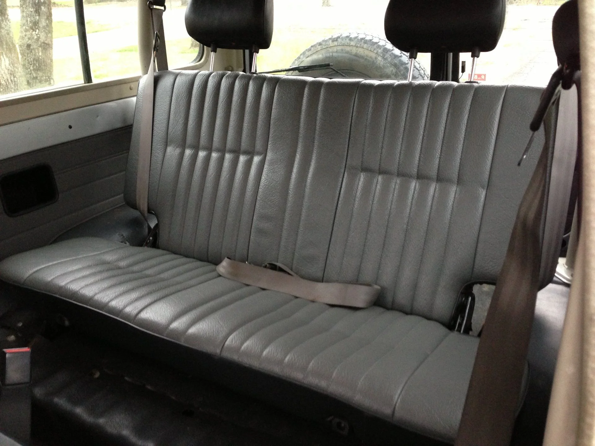

My BJ73 has the stock seat located farther back then the BJ74's They also came with stock roll bars and shoulder belts in the back.
I also thought the farther seat and roll bar might be related but it is not the case. There are JDM 73/74's with roll bars too.
