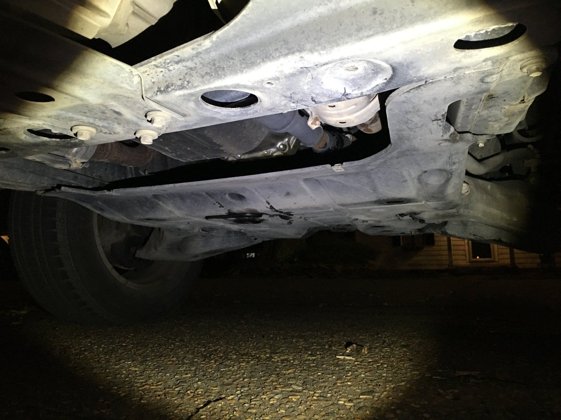

I pulled the skid plate today to grease the front driveshaft and came upon this. I’m going to look further tomorrow and I’m a little afraid to ask but does this look like RMS leak? It’s definitely visible on the skid plate and dripping off the bell housing. This is an 07 Lx470 at 182k.
Indeed that seems the likely explanation assuming that is engine oil and you can’t source the leak back elsewhere.

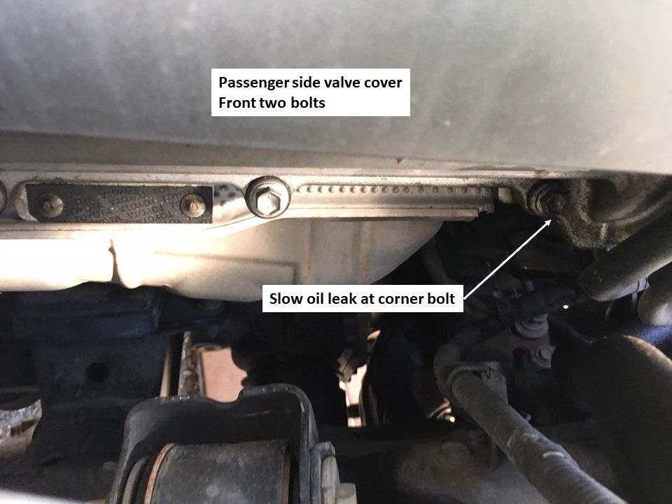

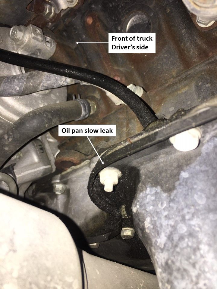

After more research, I can see that there is some minimal leakage from the valve cover gasket and from the oil pan gasket, but I can't see any clear signs that either are making their way down to the RMS area. Below are pics of the passenger side of the valve cover (DS looks similar with weeping at the corners), the front side of the oil pan (facing front of truck, not facing RMS area), and a picture of the bell housing unit.

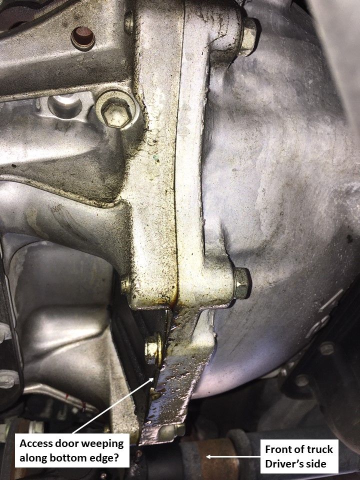

Question: See first picture. There is a thin black metal piece on the back of the bell housing that appears to be an access door to something. It's held in place by one bolt at its corner, so it seems like you'd loosen it and swing it open if necessary. After cleaning the area, I can push on this black metal piece and watch oil begin to wick down along the bottom edge of this interface. This seems to be clearly where the leak is originating from. What is this?
You can remove that access plate, and clean the area thoroughly. It's purpose is to allow access to the flexplate bolts in the event you have to pull the transmission or engine. I have a very similar leak, so I'll be doing the same investigation soon.
Upper oil pan gasket would likely mean pulling the front diff; which is better than pulling the transmission, but not that much better.
I'd definitely start with the valve cover gaskets, to start. And work your way down.

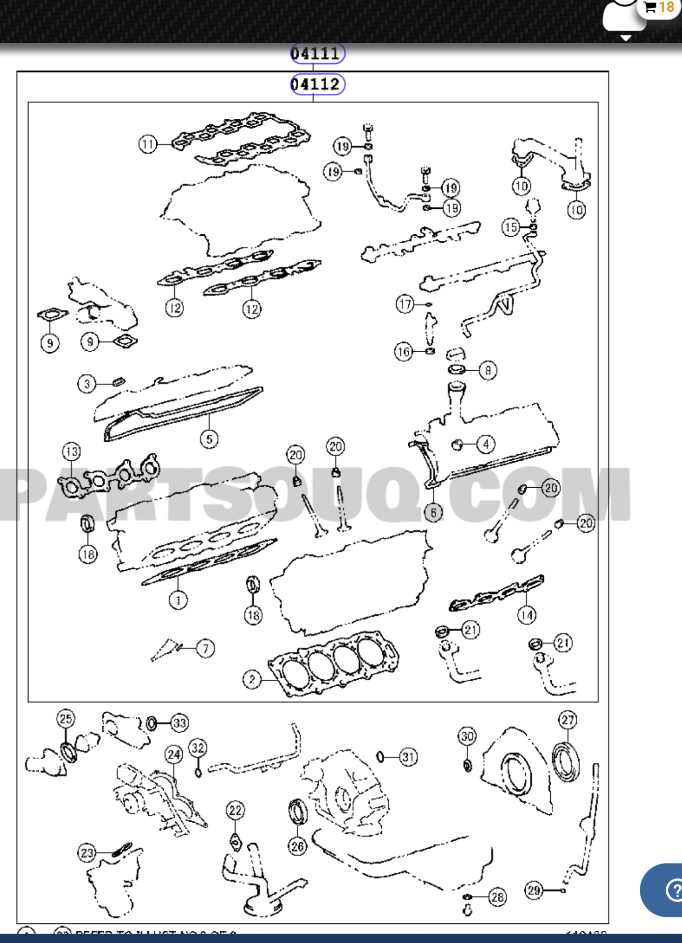

I did not order the 350$ reseal toyota kit. But everything is in there. I just looked to see if the o rings were there, they are.
