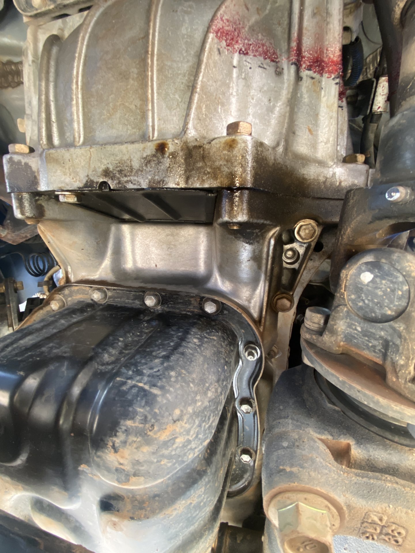

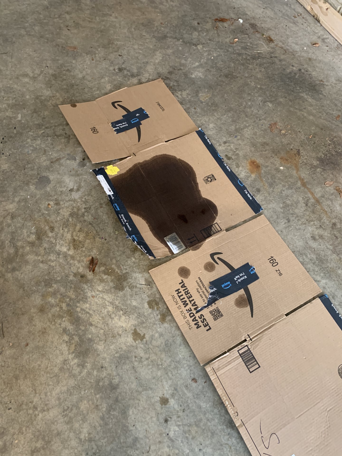

Noticed my started leaking pretty good recently.
After cleaning and inspecting this is what’s collected since Sunday. Plastic skid plate is off.
I haven’t noticed a meaningful change in oil level. How bad is this? It looks pretty bad to me.
Should I try a conventional and see if that helps before taking it in?
I’ve been using Mobil 1 (not HM) since buying the truck 30k miles ago. Not sure what the PO used.
What else should/can be done with RMS with the tranny dropped? I’m at 252k
If you proceed with seal swap be sure to check the pressure plate...mine was cracked significantly (known issue)...and plan parts buy accordingly. You might see a reduction in the leak volume by switching to conventional or as I did: 5-50w Amsoil (yes, I'm an Amsoil fan...been using it for 30+ years).
Are you referring to the flex plate? I have not heard of the pressure plate before.

Are you 100% sure it is RMS? I was once told by a shop that my RMS was leaking (around 250k at that point), only to discover that it was leaking from the valve cover gasket at the back of the engine, where the semi-moon peices are!
Yeah, sorry..."flex plate". Must be my old age memory, or lack of :rolleyes:
Definitely the lack of your old age.
Still trying to nail it down. I’d much prefer it be the valve covers. They look fine up front but I’ll check the rear.

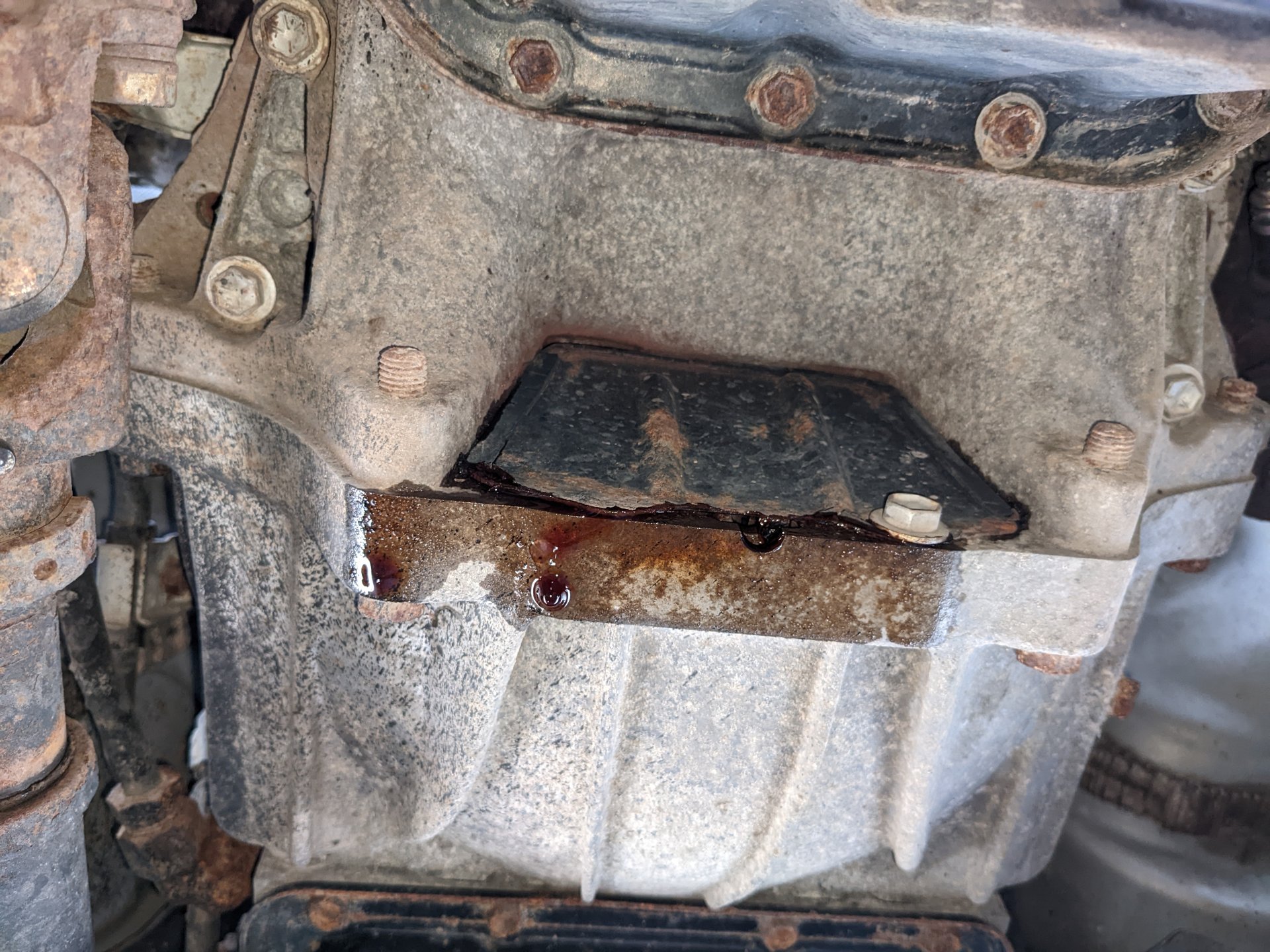

Think I'm in the same boat as the rest of the people here.... Just had the truck into the shop for an oil change and general checkup, wonder if they maybe changed up the oil from high mileage... It wasn't there before.
They found some leaks in the radiator and thermostat during that visit, so I drove it home, parked it, ordered all those parts and installed the new radiator, and hadn't moved it since. There's no reason why anything I did would cause this leak... right?
I don't believe it was anything you did. Rubber is old on these trucks and some places are prone to leak eventually, cam seals included. I think i ran mine like that for a year or so before I replaced the seal. You should be okay unless there is a puddle on the ground. Just keep an eye on the oil level.
that looks real dirty for freshly changed engine oil. and it looks reddish. Can you confirm it's not red? aka transmission fluid?
It was coolant, picking up a little bit of oil somewhere along the way. Sorry, responded in another thread that I forgot to set a spring clip. All leaking stopped after that.
