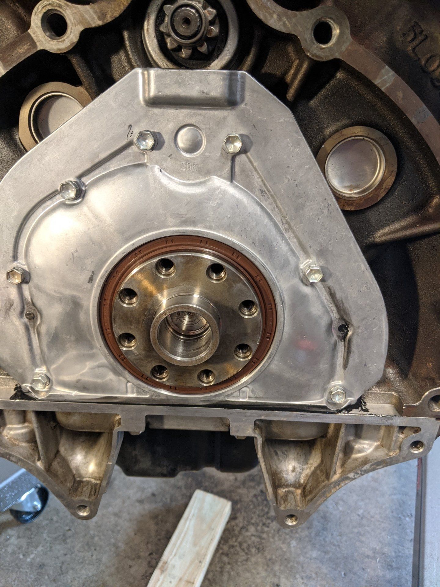

@ibrahim83 As I recall the pan can be resealed without pull rear seal plate. (see Unicorn) So seal plate can be pulled and resealed, without removing pan. But very likely you've the oil pump o-ring leaking also. You'd need to pull pans to get at the front (oil pump) o-ring.. Issue you'll have pulling pan engine in. Is keeping oil off FIPG seal area during assemble. If not kept dry and clean, FIPG will likely leak.

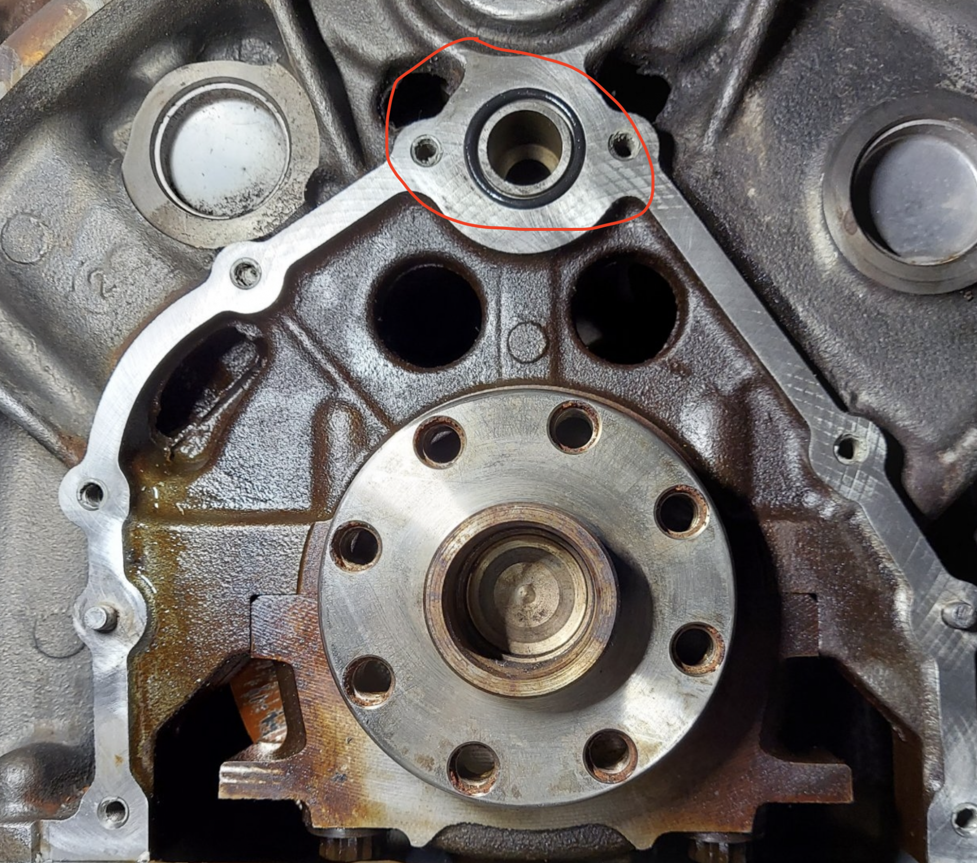

I've always had drips from the window looking at the flexplate. Not bad drips, but drips, and they were getting worse.
Also I had some leak at the front. From either the timing belt tensioner pulley bolt, the front main seal, or low oil pan. (not dipstick penetrator)
And this is why I'm posting it.

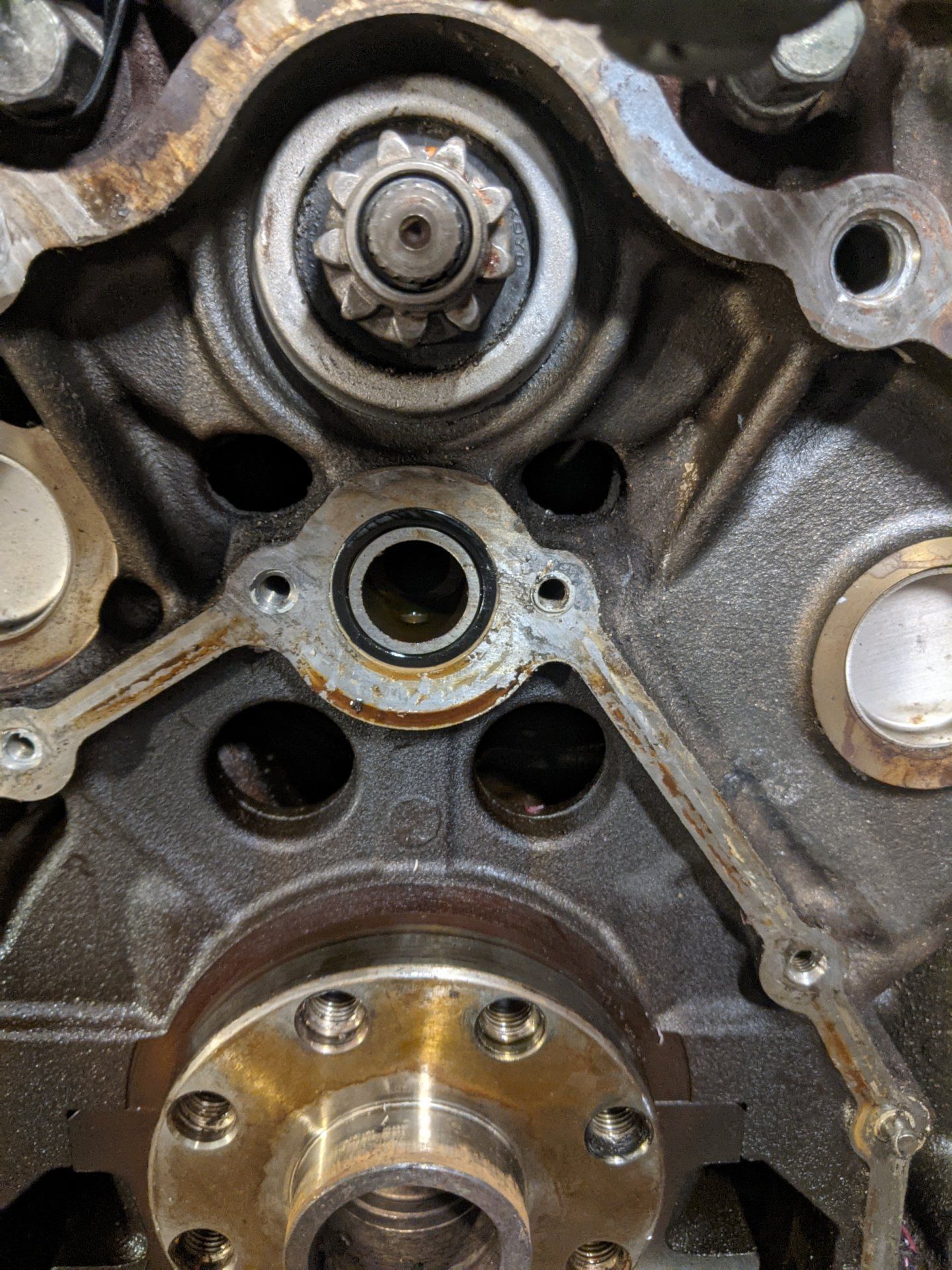

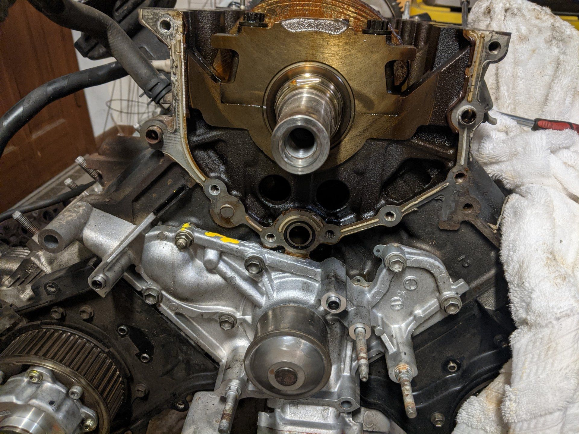

There is an oring behind the front oil pump plate and the rear main seal retainer. They are the same part number. I do believe my rear drip issue was from this o ring. I don't really know where my front leak was coming from but both these o rings were very hard and came out in chunks. I'm sure both were original. These are outside of the fipg seal area.
You can see it in the pics.
If you're replacing the front or rear seals, it would be a very good idea to replace these also. I'm my case I doubt either front or rear main seals were bad.
but- here's something weird, two of my flexplate bolts were very wet with oil, the other six were dry. In my mind, it would be very hard to just replace the rear main without taking the retainer off also and getting at the O ring. I do think you could do it with the tranny out and engine in place but it would be very awkward to clean it down on the floor and also verify that your sealing surface with the upper oil pan was spotless. Doing it that way isn't the book method but I imagine it's possible.

I just ended up removing the plate, cleaning everything 100% and fpig'ing everything back including the bottom of the metal plate that sits on the upper oil pan.
The o ring was plastic at this point. I'm pissed I missed the front one when I did the timing belt and cam and crank seals last month, oh well.
