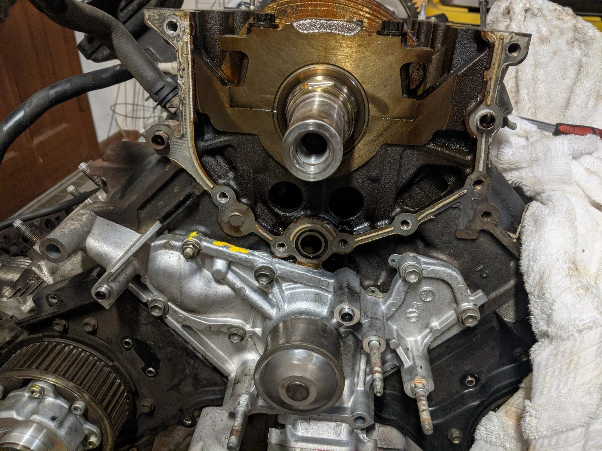

I replaced it and the front seals a few days ago.
I've always had drips from the window looking at the flexplate. Not bad drips, but drips, and they were getting worse.
Also I had some leak at the front. From either the timing belt tensioner pulley bolt, the front main seal, or low oil pan. (not dipstick penetrator)
And this is why I'm posting it.

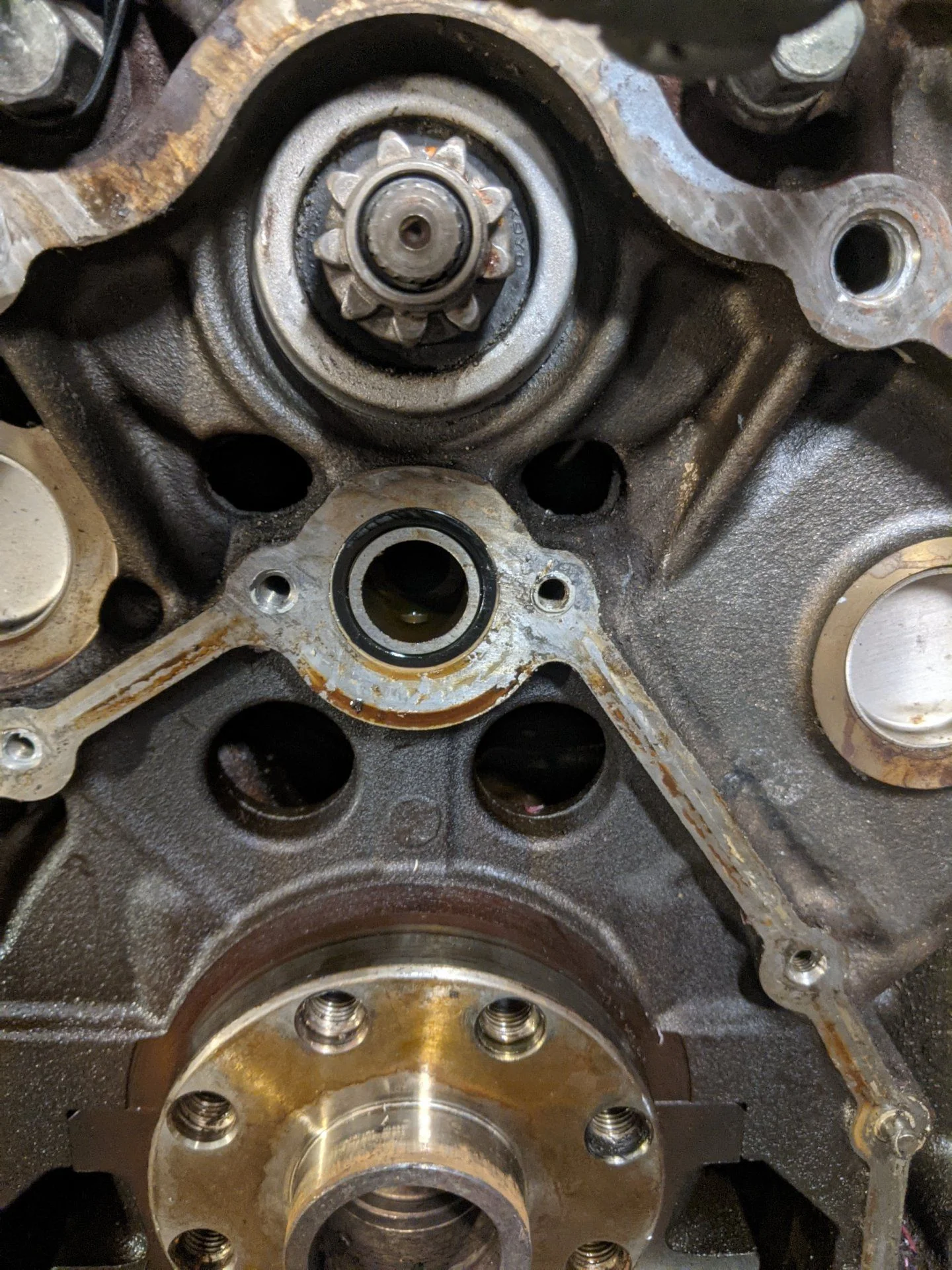

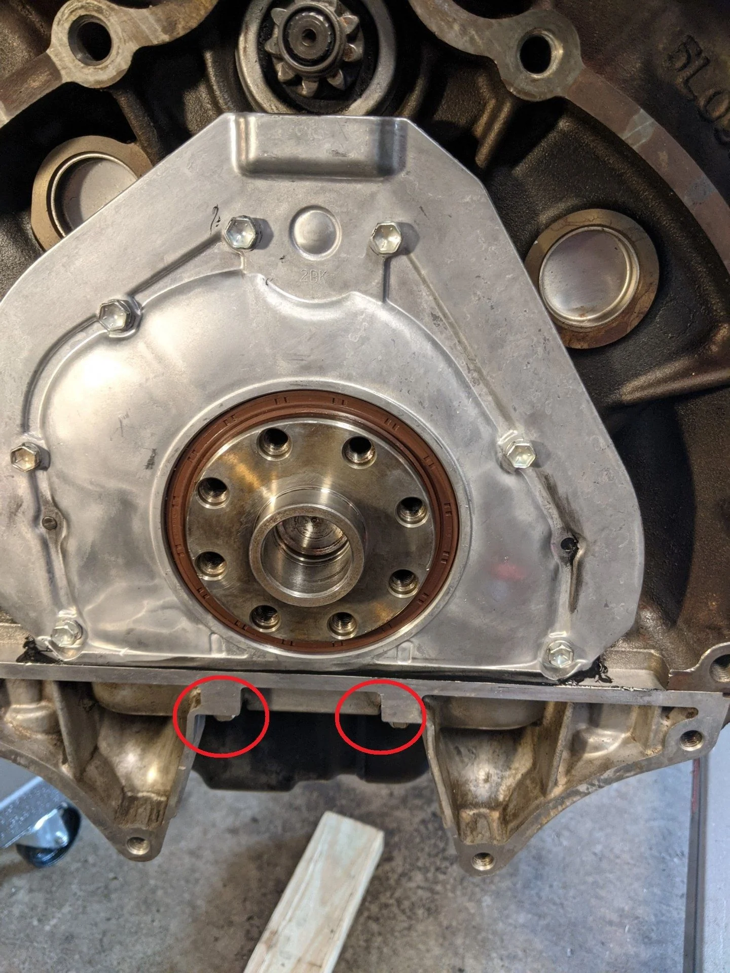

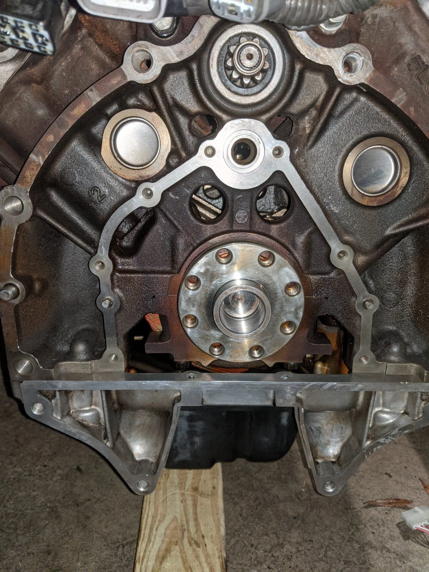

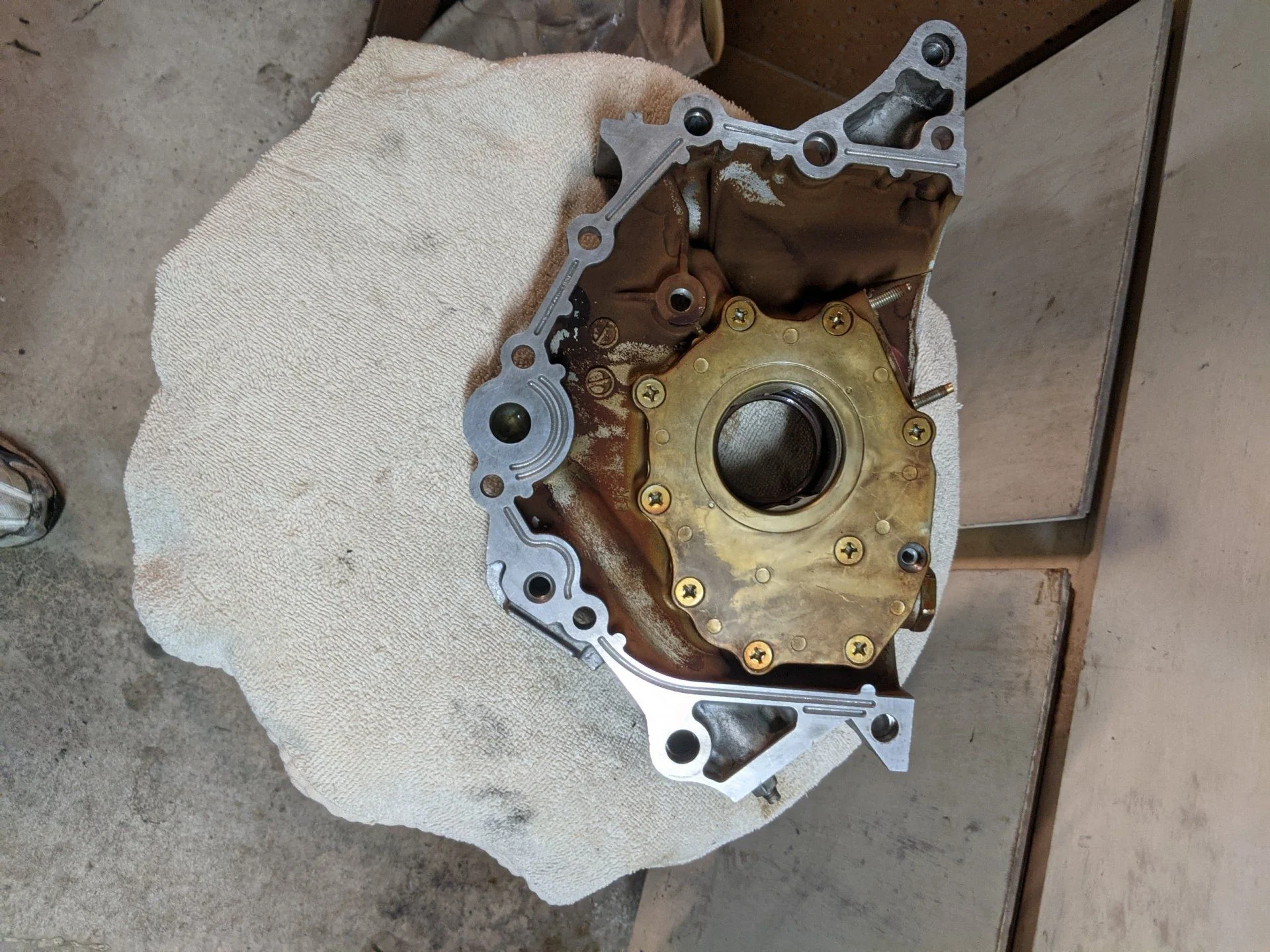

There is an oring behind the front oil pump plate and the rear main seal retainer. They are the same part number. I do believe my rear drip issue was from this o ring. I don't really know where my front leak was coming from but both these o rings were very hard and came out in chunks. I'm sure both were original. These are outside of the fipg seal area.
You can see it in the pics.
If you're replacing the front or rear seals, it would be a very good idea to replace these also. I'm my case I doubt either front or rear main seals were bad.
but- here's something weird, two of my flexplate bolts were very wet with oil, the other six were dry. In my mind, it would be very hard to just replace the rear main without taking the retainer off also and getting at the O ring. I do think you could do it with the tranny out and engine in place but it would be very awkward to clean it down on the floor and also verify that your sealing surface with the upper oil pan was spotless. Doing it that way isn't the book method but I imagine it's possible.
The mission creep is real, and dangerous. Oh, and if partsouq is selling fake parts, I'm totally F-ed. I think my toyota budget is blown for the year.

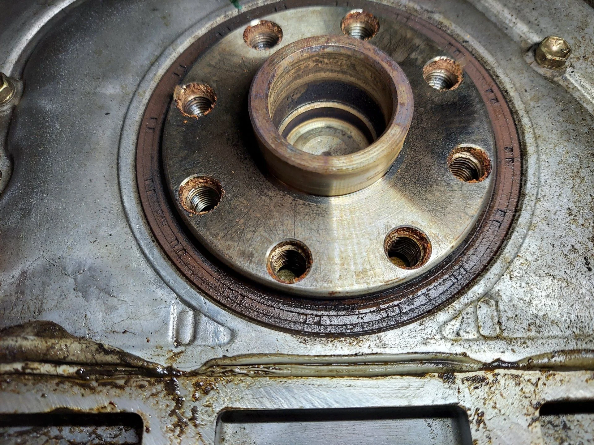

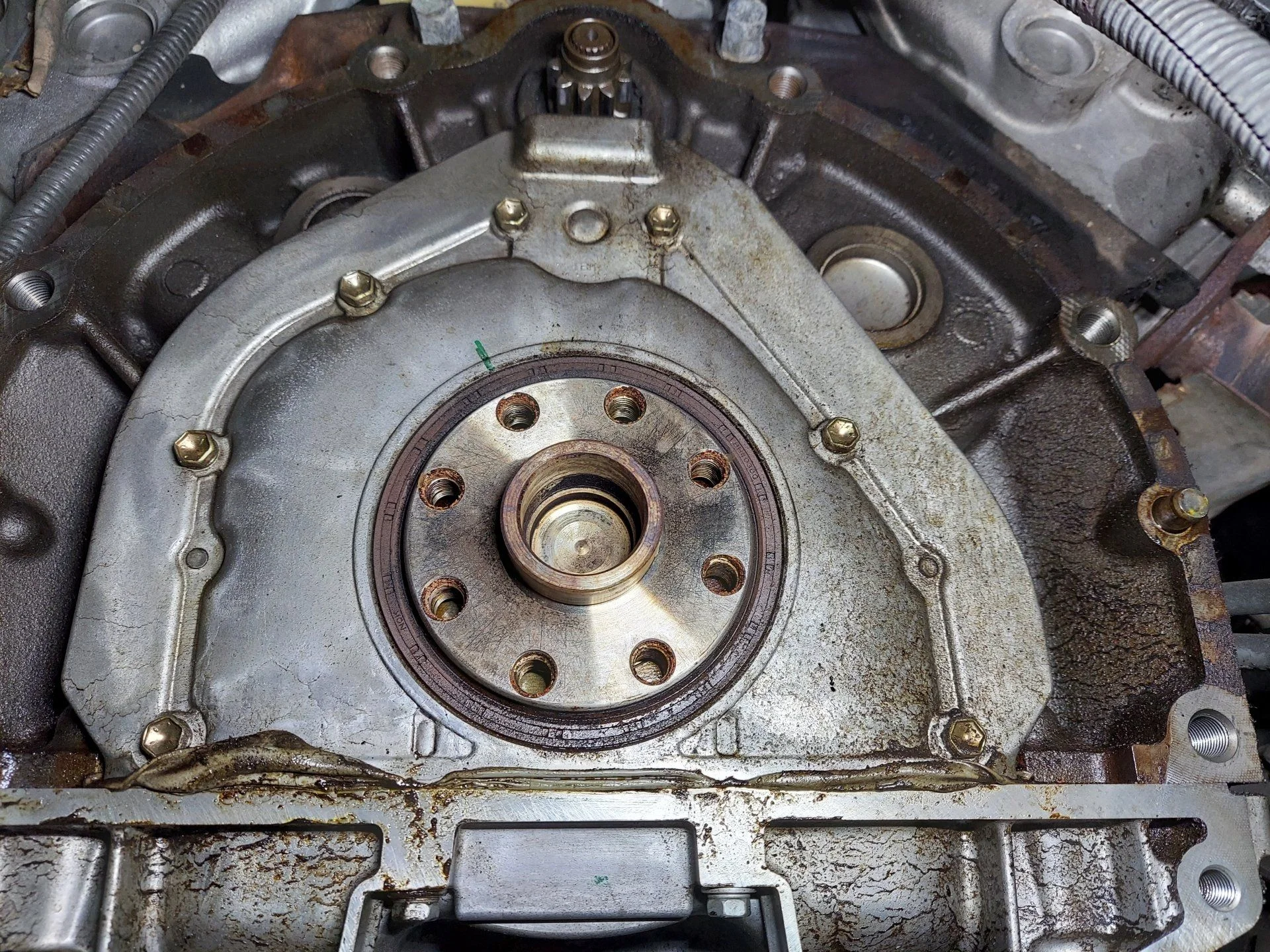

I'm currently doing the rear main seal, i unscrewed the plate covering the oil o-ring, but it isn't moving, is it RTV'd in place? and can i remove it with the oil pans still in place?
There's two verticle bolts coming in from the bottom.
you probably found it but here's a pic.
Yes you could without removing both pans. Maybe it would be fine for years and maybe it won't.

I got the bottom bolts, as I was lightly prying on it I realized it shared the same rtv as the upper oil pan and didn't want to rip it out and bandaid seal the area.
So the whole "face" of this piece of metal has rtv running between the mounting bolts on the vertical and horizontal surface?
If we assume the o ring up there leaks, wouldn't it leak back into the pan vs out the seal?

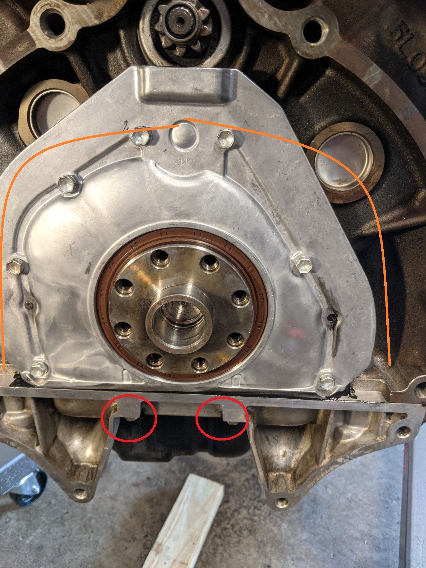

look in the book at the retainer 103b sealing surface around the top oring. Follow the trail of oil if it leaked up and over that or to the side, it would travel to the lower left and right nooks and crannies of the iron.

@abuck99 . I know I'm too fast and not complete. The rear main is part of the 100% sealing surface of the upper oil pan.
doing the rear seal independently without removing the upper pan is not the book way of doing it. but It's possible.
I di it by accident and going too fast. Honestly it was the last thing I did, because I didn't take it off the stand until the end to get the flexplate off and realize my mistake. It's an easy mistake to make. Unless you've done this block before. (I assume it is)
I wrongly thought it was an independent R&R. You can see in the picture the absence of 103b on the edges. IF it leaks there I'll know.

@ibrahim83 As I recall the pan can be resealed without pull rear seal plate. (see Unicorn) So seal plate can be pulled and resealed, without removing pan. But very likely you've the oil pump o-ring leaking also. You'd need to pull pans to get at the front (oil pump) o-ring.. Issue you'll have pulling pan engine in. Is keeping oil off FIPG seal area during assemble. If not kept dry and clean, FIPG will likely leak.
