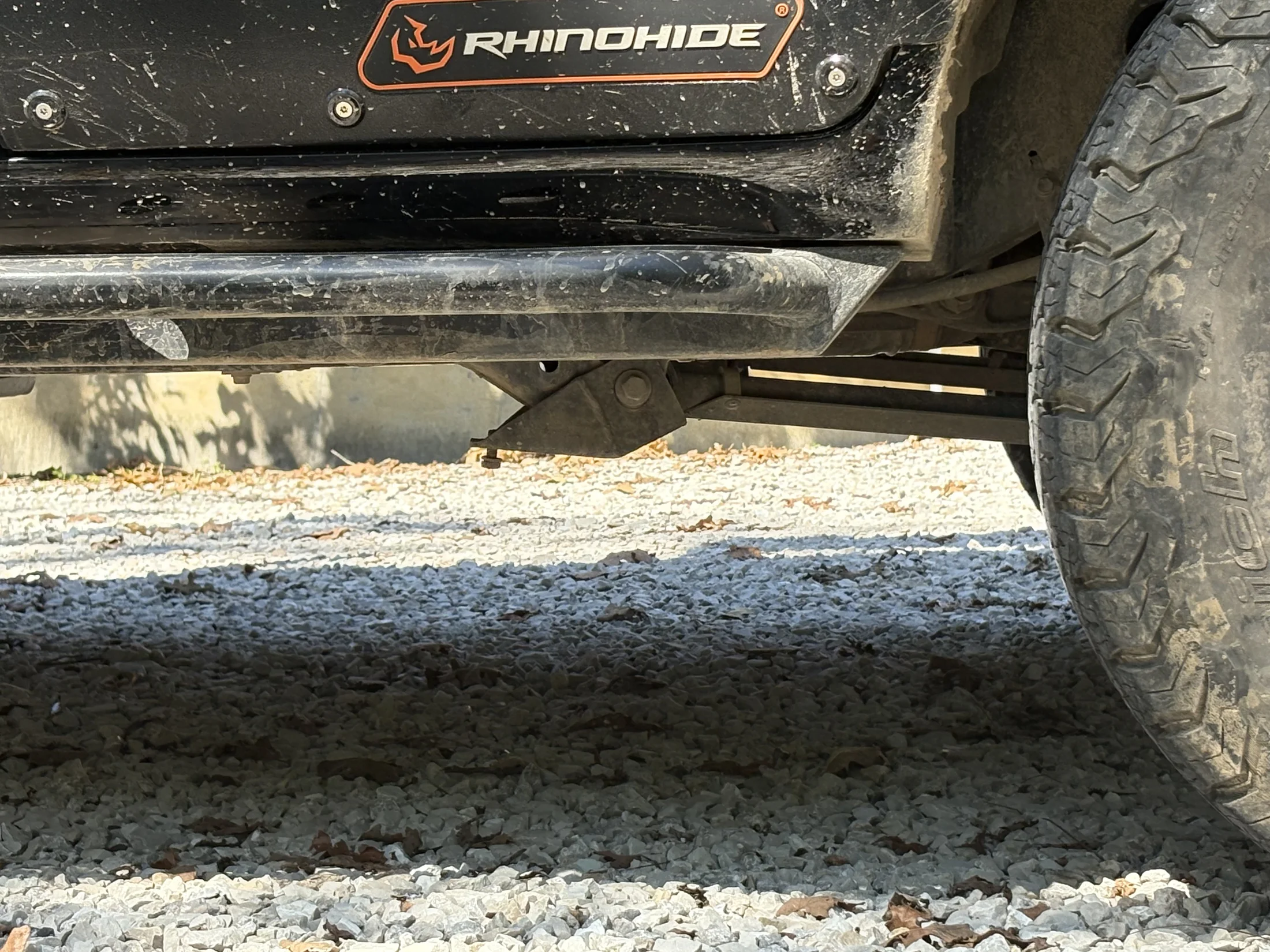

Unfortunately, I tagged my RLCA bracket on a narrow washed out trail in La Rumorosa, Mexico. I wanted to stack rocks, but there were signs of possible cartel activity close by and the sun was getting low.

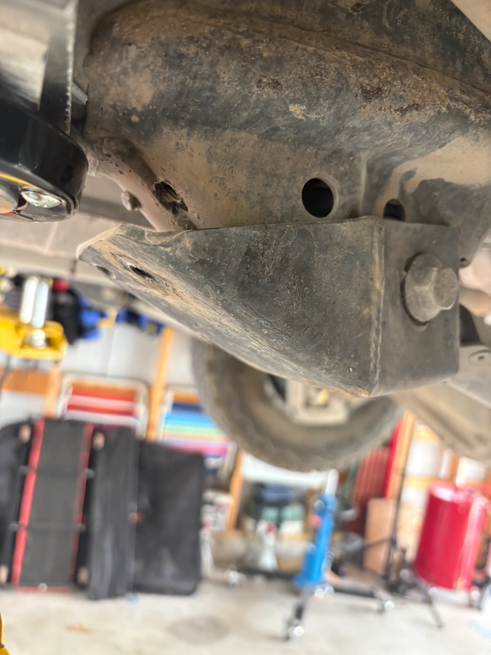

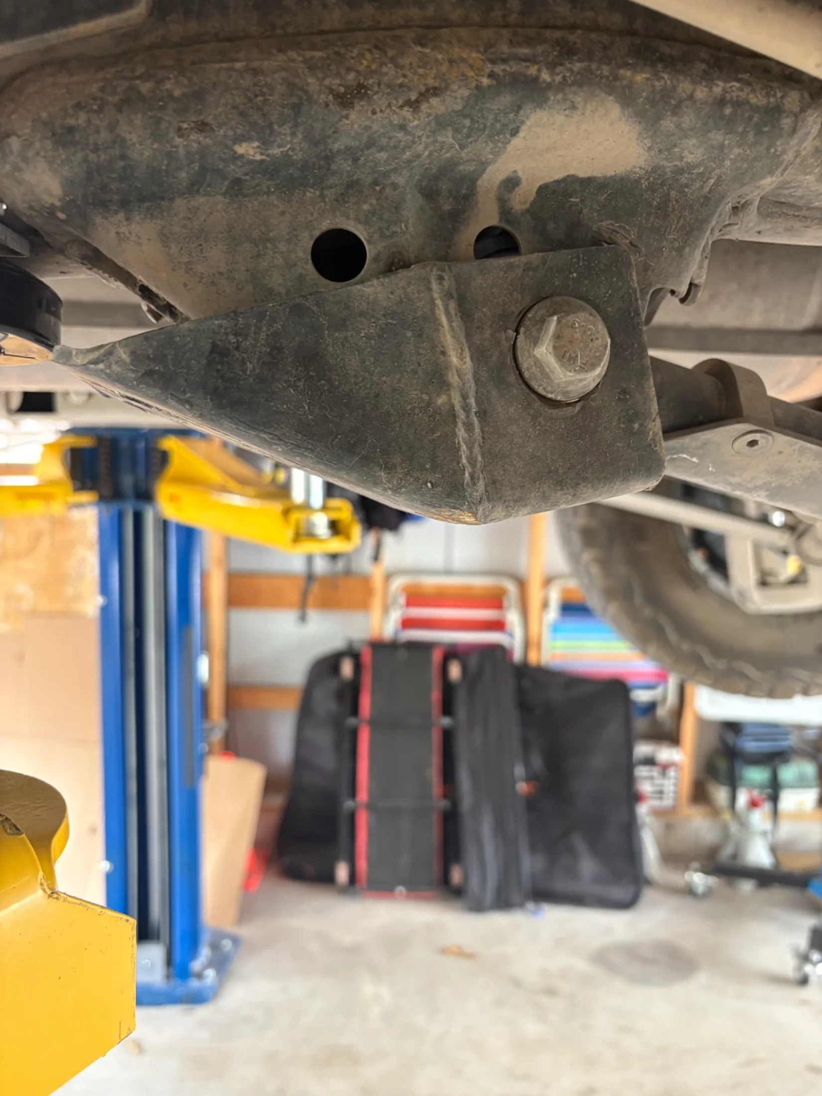

I tagged the brackets last April on Hell's Revenge, but this time, I'm more worried since the OEM radiused bend is becoming a 90 degree fold. The photos are after I had already pried the bracket out a bit.
I reached out to @Taco2Cruiser and Bud Built today, and don't think the Bud Built-style skids will be produced.
That having been said, I think I'm going to try making my own or getting a fabrication shop to make some. Could @Markuson or @JohnJB please take some photos of the skids on insides and outsides of their frame rails? I would like to see how the forward-most and highest fasteners attach.
