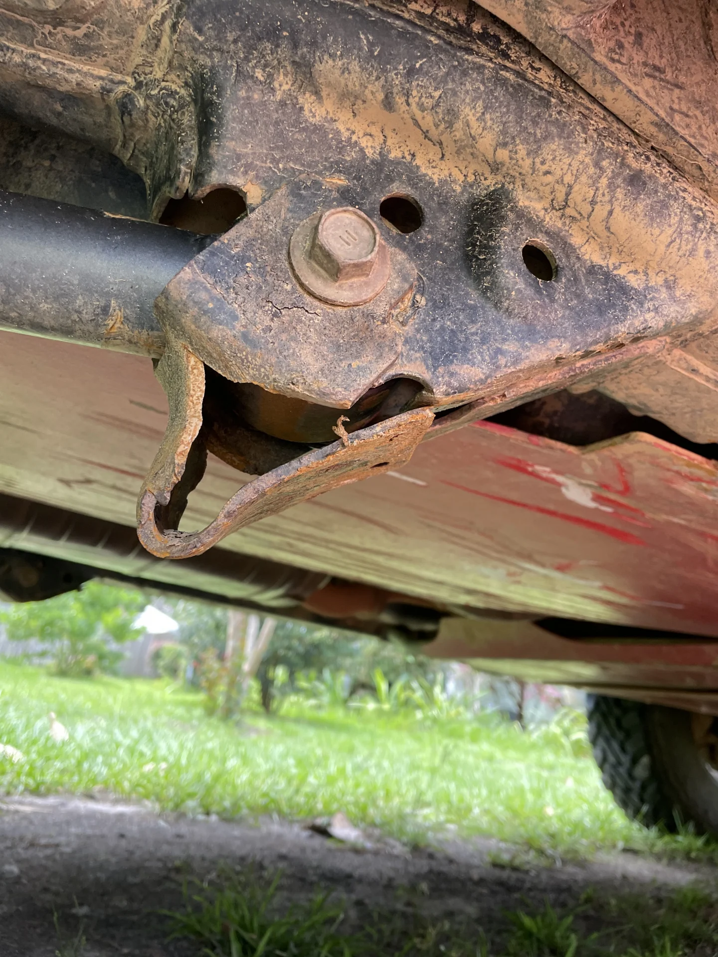

I've got the TT armor and sheared the bolt heads off at Windrock last time out. Im gonna beat everything back in place and then weld it. I would highly recommend throwing some weld on these instead of totally relying on the bolts if doing any serious wheeling.

Wow, that’s serious. Although it looks like it mangled the guard, it looks like it did it’s job of protecting the mount. My mount is all chewed up now.

With the amount you bash your RLCA, how are you going to replace the arms when they bend again if you weld the skid in?
I'll do a stitch weld so I could cut them off easily. I always keep an angle grinder and sawzall on the trail.👍
I've stitch welded my BB gas tank skid to the frame too. If I need to drop it ill just cut it loose.
IMO, I'd prefer the RLCA skids be sacrificial parts rather than potentially ripping the entire bracket off the frame.
Good call. I haven’t yet reached ripping armored factory mounts off the frame territory. That’s probably a place I don’t need to travel in a 200. 👍

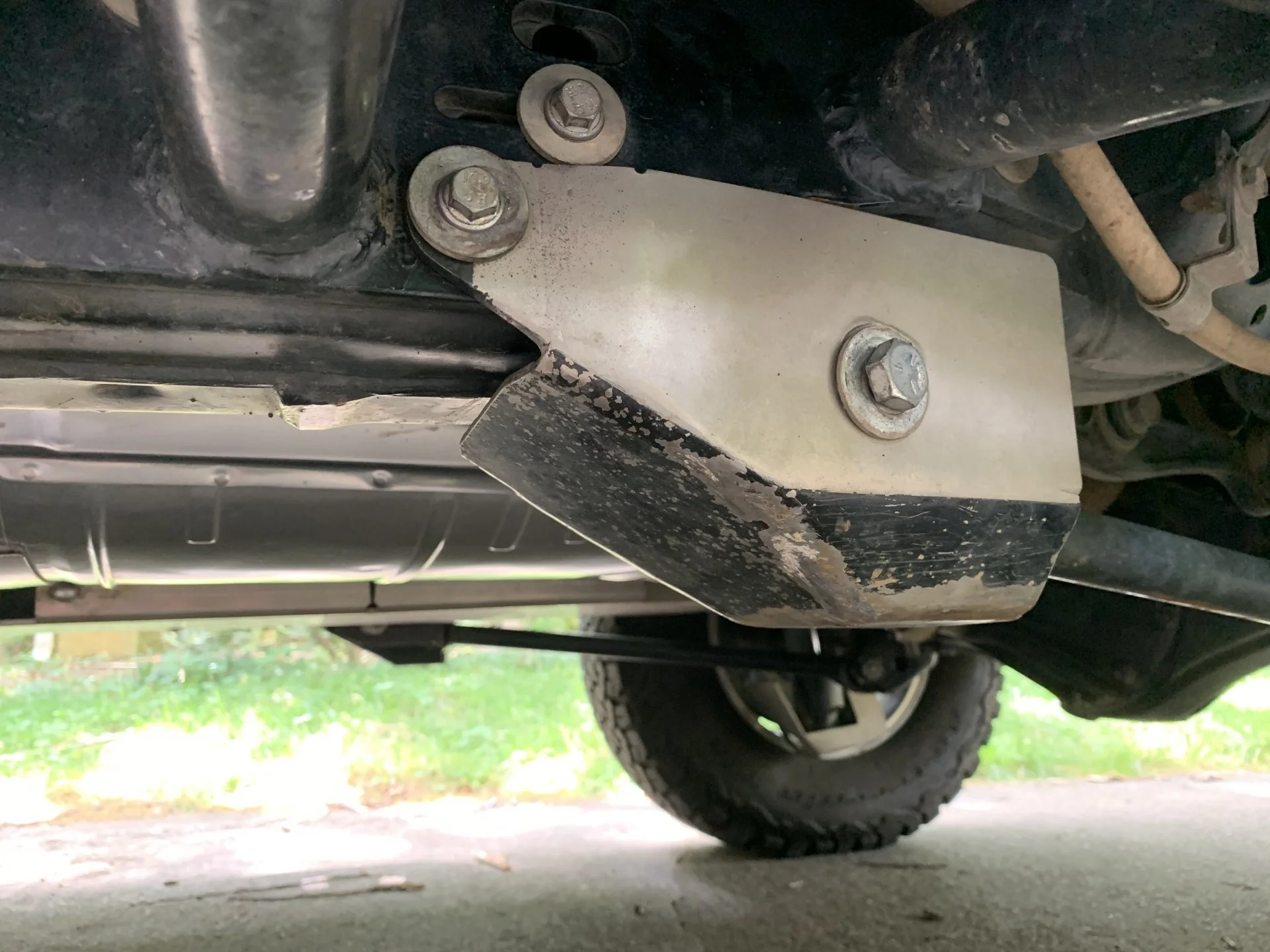

Here was a prototype being test fit on my truck back in October.
Doubt this is still the working version, but apparently 2020(?) on has a different mount/bolt hole configuration. It looks like it would be a simple thing, but it’s more complicated than just building a steel bucket.
