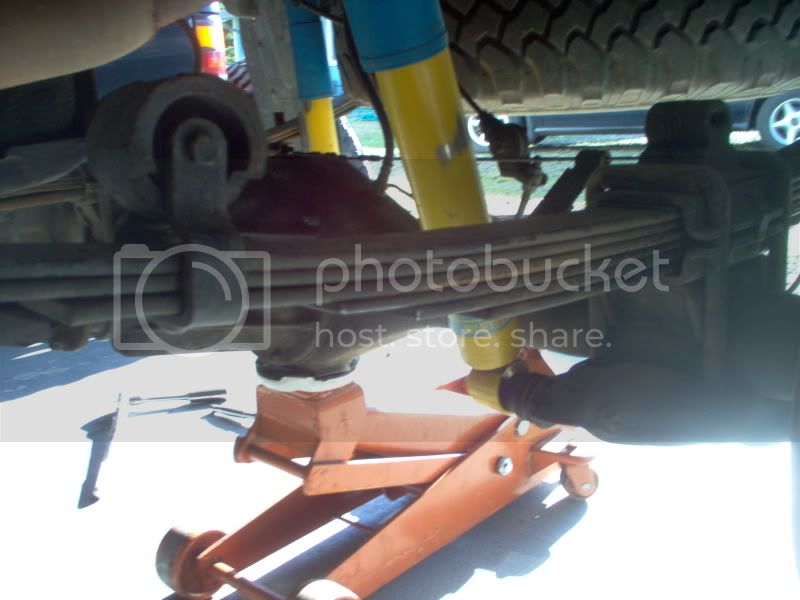

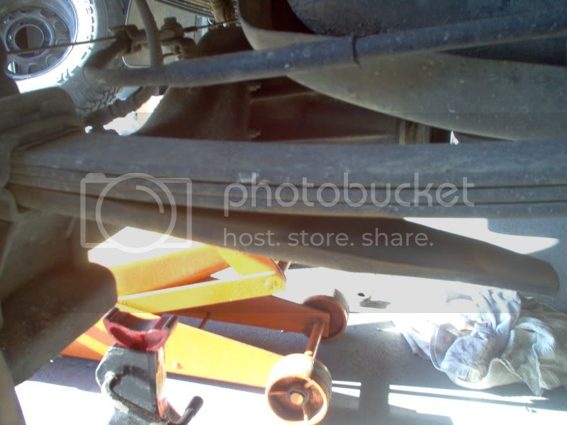

Here they are: Low pro bump stops and the the pictures below the one on the right is the stock bumpstop on the down limit. If you plan on putting a low pro there make sure you have no cv bind, it explains it on that link i gave you.

Thanks for all the info and pics, very helpful.
