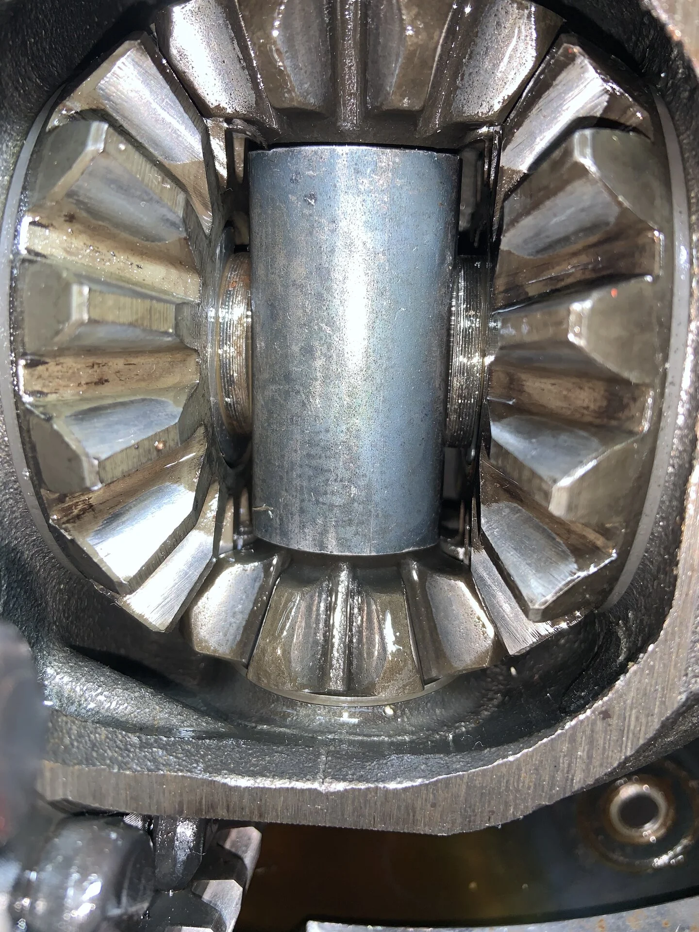

Hello, my pinon is spacer 29.8" and fits perfectly with no discernable space on either side. Unable to fit the minimum fuelers gauge .0024" on either side. I can remove it with my fingers and a dental pick so it does not appear to be binding anything. Is it ok to leave this way? The FSM min standard .060mm/.0024" seems very thin. I have a fuelers gauge at .002 and it's paper thin but im unable to insert it between the spacer on either side. So, I'm wondering if it really matters that mine is touching or could I get it milled. Also, is the FSM min standard measurement .060mm/.0024" just for one side? Or is it .060mm/.0024" for each side or axel end?
Just curious if less is better in this case and I shouldn't worry about it.
Lastly, does it hurt the temper of the steel to mill it again?
Thanks,
Dave

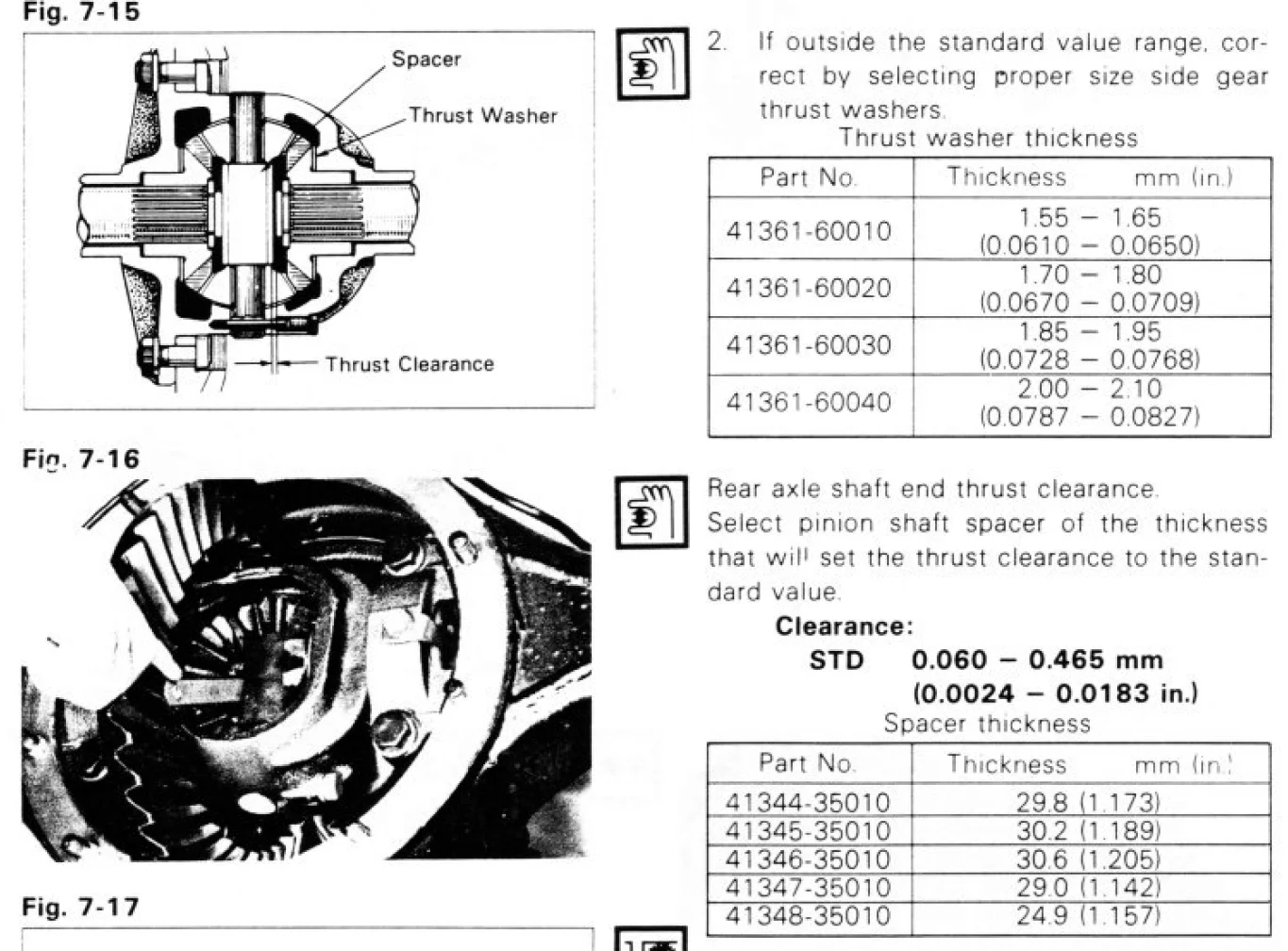

I assume this is a 1977 FJ40 with the standard semi float 4.11 rear end (from your other posts). Short answer: yes, the minimum clearance stated is per side.
So the way the spacer works is to set the distance between the side (aka differential) gears by moving the pinion (aka spider) gears closer together or farther apart. There has to be clearance between the ends of the driveshafts and the pinion spacer. The amount of clearance is determined largely by the tolerance stackup between all the parts (carrier housing, driveshaft flange-to-C-lip groove distance, etc); strictly from the differential perspective, it doesn't really matter what it is, as long as it's there, the shaft ends won't wear against the spacer body.
However, from a fit-up perspective, it does matter, and that's why there's a tolerance for the spacer length. If it's too long, the gears won't mesh when you clip the side gears onto the driveshafts, and if it's too short, the spider gears won't have any support. I doubt it's hard; if you need it shorter, cut it. Even if it was hard, cut it cool and it'll be OK.
The best way to find out what length you need is to assemble the differential without the spacer, but with the C-clips on the driveshafts. Pull the spiders together, as best you can, and measure the distance between the faces. A snap gauge is ideal for this.
Unless someone has been in there swapping out parts, you should have the correct length; as I said, it's set by the dimensions of all the parts bolted together from the hub to the diff centerline.

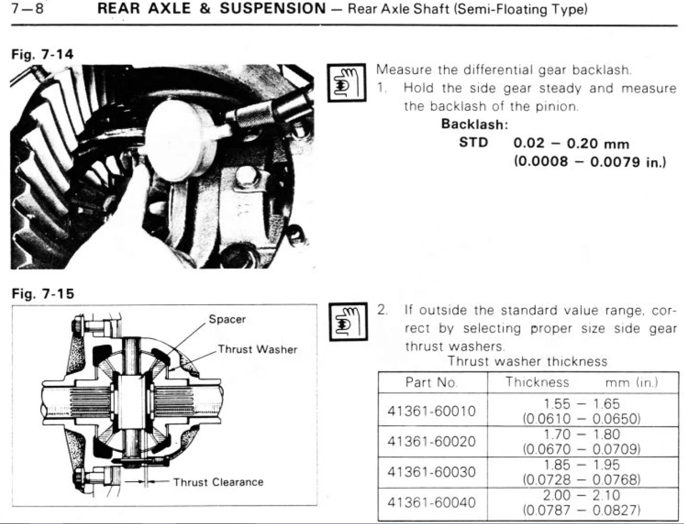

The image below is from the 1980 Chassis and Body manual (36044E) (but the dimensions and procedure are the same for the 1977 model year; I checked them against my paper copy):
I should also note that is is important that you not use the thrust washers to get the thrust clearance. The thrust washers are used to set the gear backlash between the side gears and the single pinion gear (the one that's meshes with the ring gear). Once that backlash is set, then, and only then, do you worry about the spider gear clearance.
