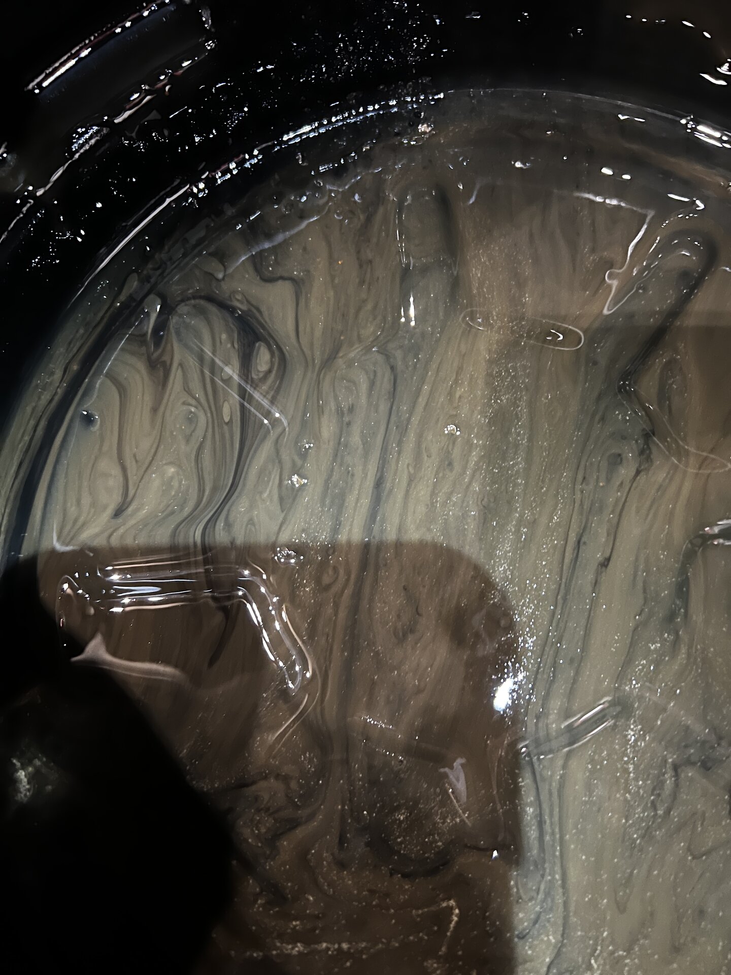

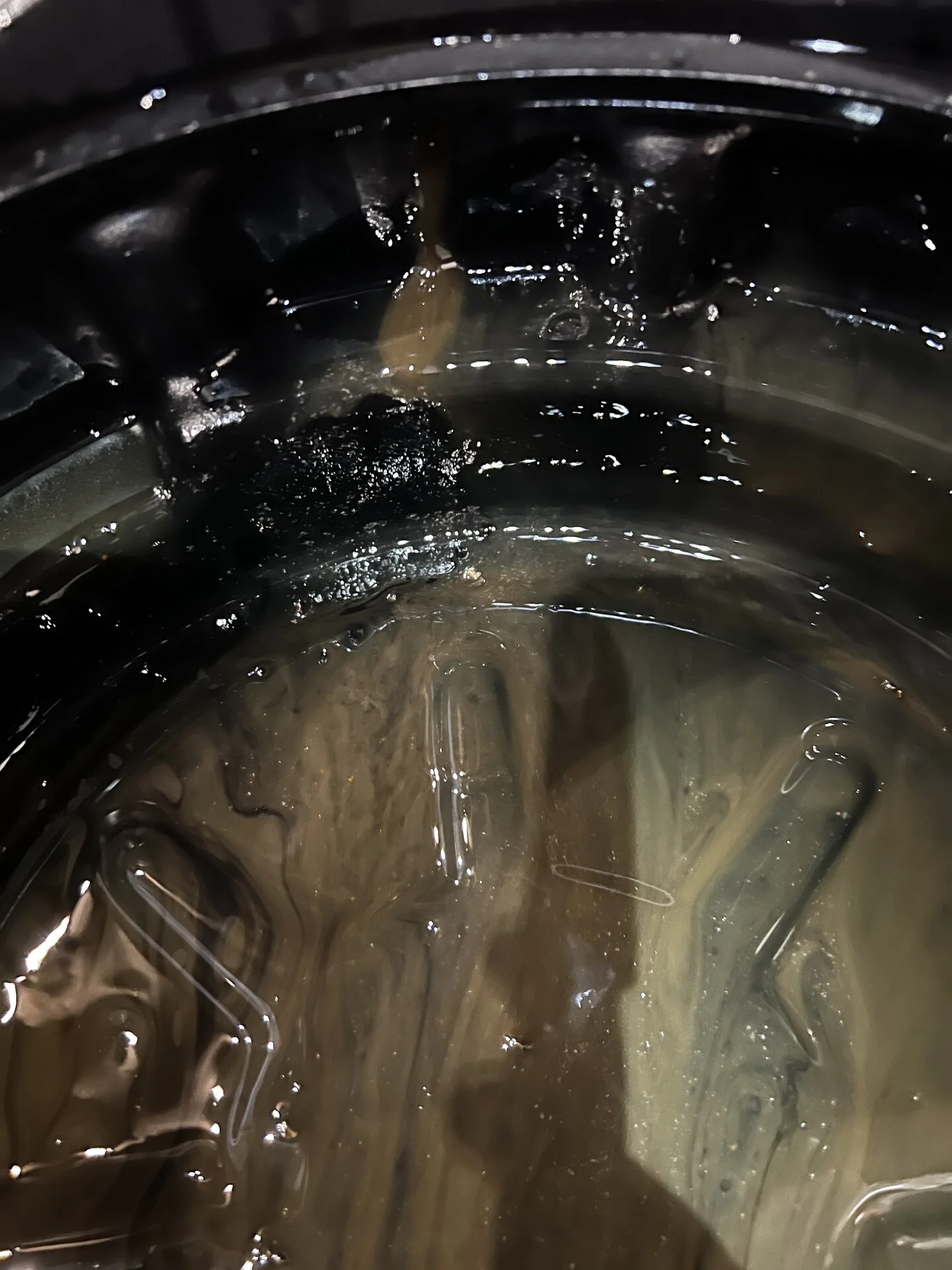

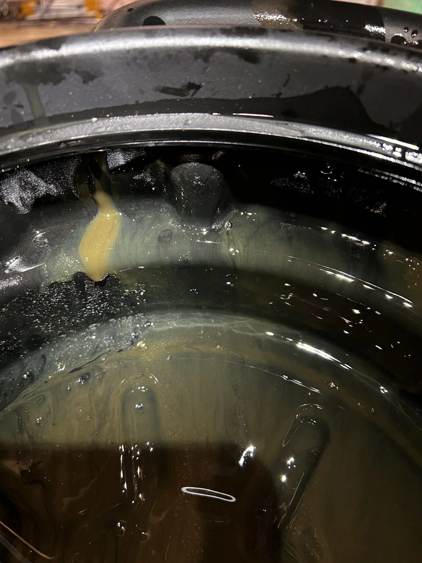

Changing the rear differential fluid and pulled the magnet to inspect and found some pretty gnarly chunks… I don’t audibly hear anything wrong (no grinding/vibrating/groaning/etc) with the diff itself, but I’m assuming this is maybe an early sign of failure occurring?

From the look of THE oil in your differential clearly you have a water contamination.
THE chunks of metal that you found are a sign of heavy or improper use .
Best world be to have a deeper look in to it .
Looks like damaged teeth. Something probably broke inside and got caught in a gear. A serious off-roading event was the most likely cause. Time to pull the third member and have a look.
I would say not to lose hope, it is hard to tell with the gear oil mess. Give it a good cleaning and post up some clearer photos before you start throwing money at it.
