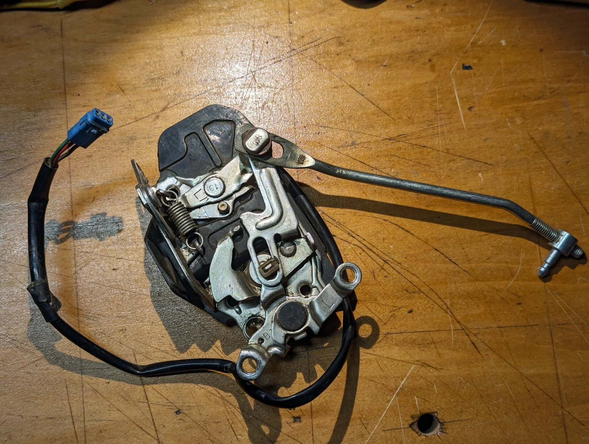

Does the electric rear door lock in 70 series (mine is an HZJ75 troopy) have a solenoid like the front door locks?

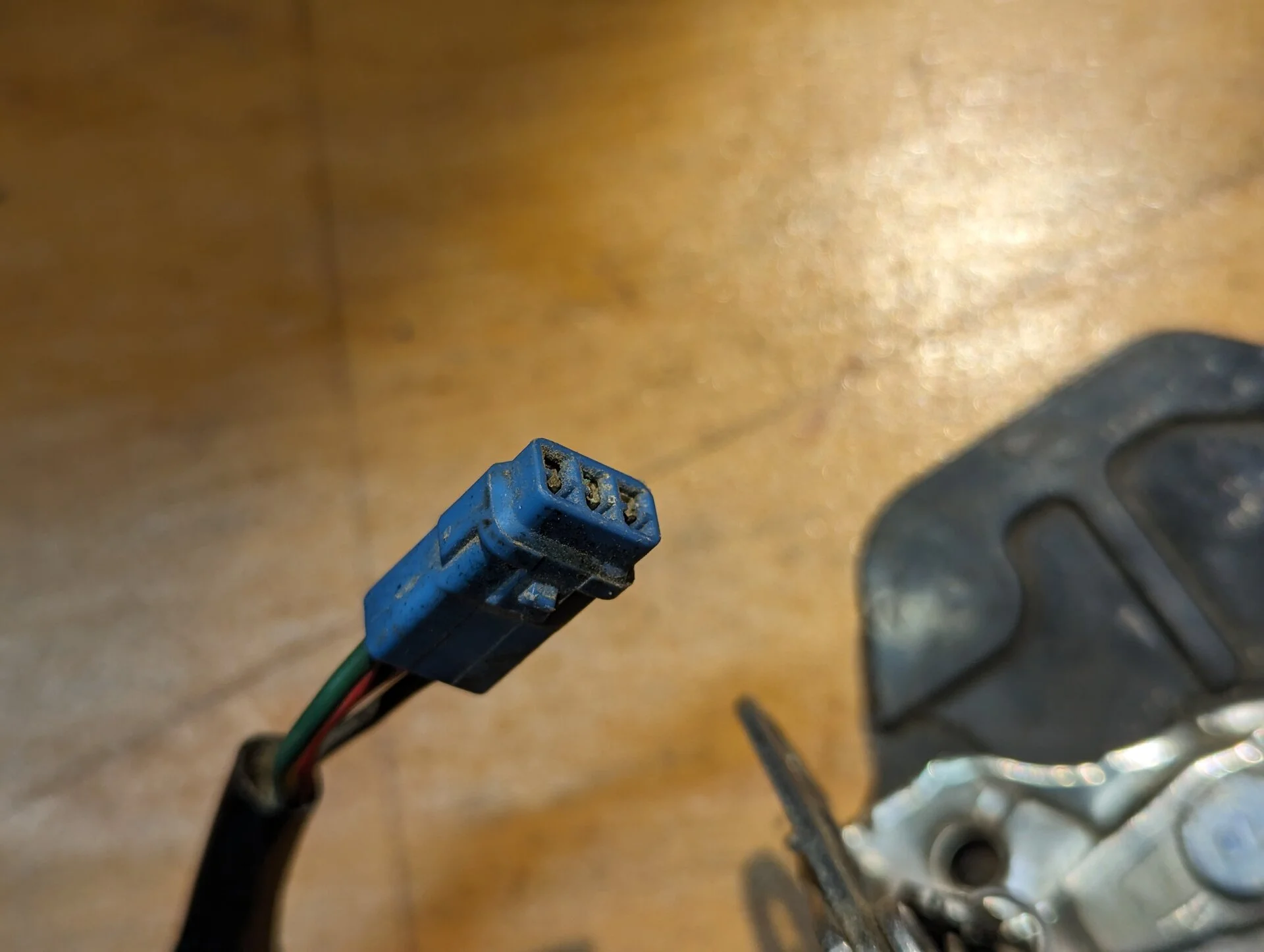

This pic is what I was sent for that rear door lock.
Question #2: What is the 3 pin wire coming off of it?
LJ71 owner here. I am not 100% sure if the troopy is the same but the front door locks on my LJ71 and previous LJ78 all have a small motor inside to operate the door lock. There are few threads about it here - you can replace just the motor itself with the same size one (it's considered a hobby motor, easily found on Amazon and eBay). I have had to replace multiple side door lock motors and the rear motors in both my LJs, they all use the same motor and same process to replace - it's inside the plastic cover on the other side of the actuator assembly that you pictured.
The 3 wire harness powers the motor itself. Here's a thread I used that hopefully helps you sort it out: Driver Door Lock Actuator Tear Down - https://forum.ih8mud.com/threads/driver-door-lock-actuator-tear-down.1278071/

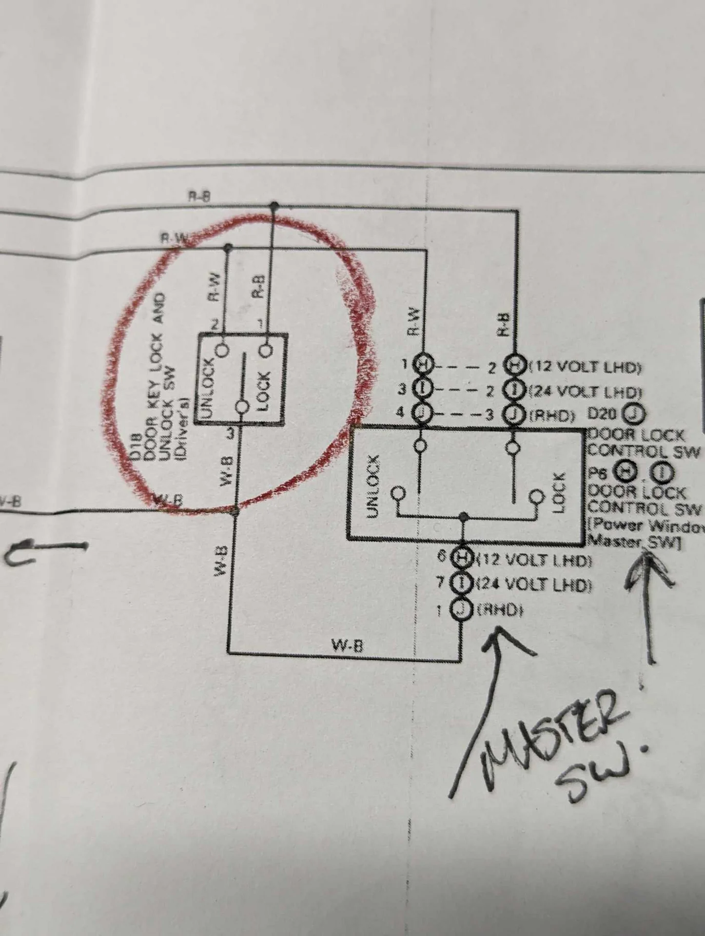

Do you know what the 3 wires to the driver door mechanism are... red, black and green. I just attempted to test mine to see if I could get it to "move" and no combo resulted in any movement or noise from the mechanism :-(
My diagram, which might be wrong, shows different colors.
If I remember correctly, black goes to ground and applying 12V (or 24V in your case I believe) will move the motor.
Here's my guess as to why applying power to your pins isn't working - the motor inside the unit may be burnt out causing you to second guess your work. It's been a year since I've repaired my door locks and installed an alarm, but I do remember bench testing prior to re-installation and applying 12V to one wire or the other while grounding the third caused actuation.
I've replaced 4 of these little motors so far and each time they went out, they were completely dead without any intermittent functionality. It's possible the actuator you are working with is also dead considering its age. Good luck!

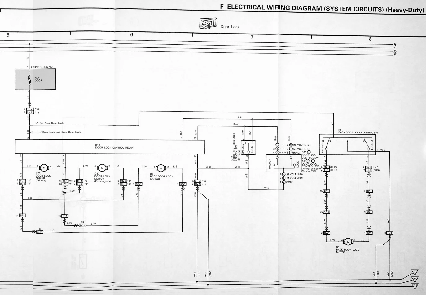

From the EWD manual:
You have "D19 - Door lock control relay" and "B4 - Back door lock control switch" in this circuit. "B5 - Back door lock motor" is what you have pictured. This is from EWD168f. Looks like the wires to B5 are L-B & L-W, which mean Blue-Black & Blue-White, respectively.
The BW1 connectors are:
And the motor connectors show:

"Looks like the wires to B5 are L-B & L-W, which mean Blue-Black & Blue-White, respectively"
Not what my rear door motor/mechanism has. Mine are red, black and green :bang:
