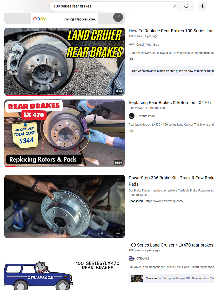

Several tutorial vid's on Youtube.
I know. They don’t really specify though for land cruisers and I don’t know if it’s different the ones I have watched also don’t really say top or bottom they just say put it in the same one, which I can’t since I don’t remember

The pin with the rubber bushing is the lower one.
Car Care Nut did a great video on brakes. The style he changed in the video mimic our rear brake calipers. Good pin talk:
