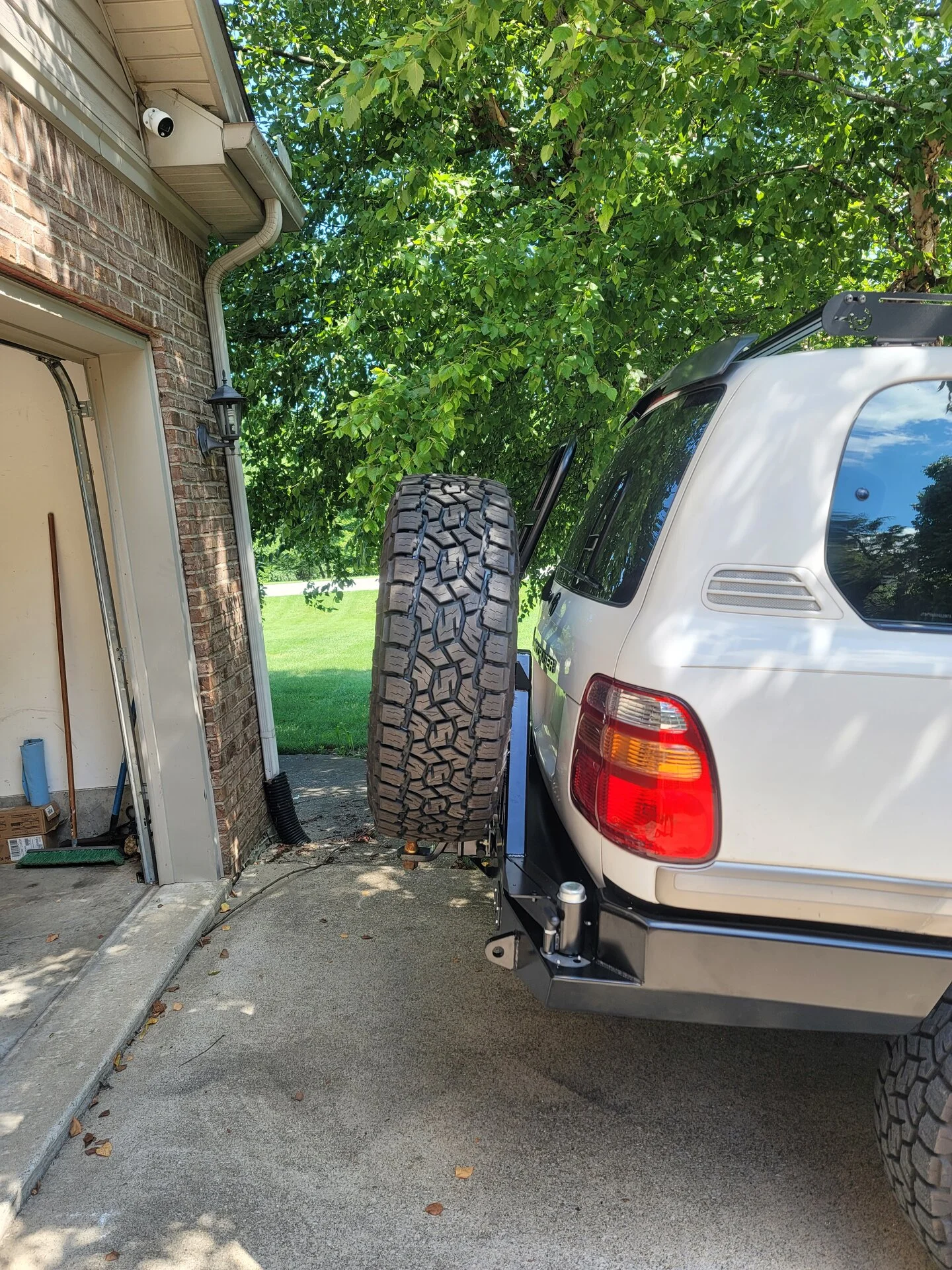

13. Trail Tailor. Does require cutting the factory cross member. Is of fantastic great quality. It comes with Sylvania reverse lights and Road Vision combination lights. The spindle for the swing arms are very beefy (1.375” diameter) and uses Timken bearings and seals. I run the driver side spare + hi-lift jack mount, passenger side 3 Jerry Can carrier with accessory hitch, and dual latches. No squeaks or rattles after +2 years. I just cleaned and regressed the locking pins. Mine is steel bumper and steel swing arms. But I believe Jason does offer aluminum arms and other customization like a ladder, rear side hoops.
View attachment 3232164View attachment 3232163
Damn, that is super clean. Looks like a mix between the Valley Tech, and Slee. Ill have to take a look. Thanks!
Here is some more info and pictures back when I got mine through a group buy TRAIL TAILOR - REAR BUMPER - 100 Series Land Cruiser/LX470 - https://forum.ih8mud.com/threads/trail-tailor-rear-bumper-100-series-land-cruiser-lx470.1230102/
My only regret, is I wish the ladder option with the 3 jerry can carrier would have been available back when I ordered. Just for some more external storage mounting options.
I am just glad more options are now available for our trucks. So folks can find that perfect bumper option!

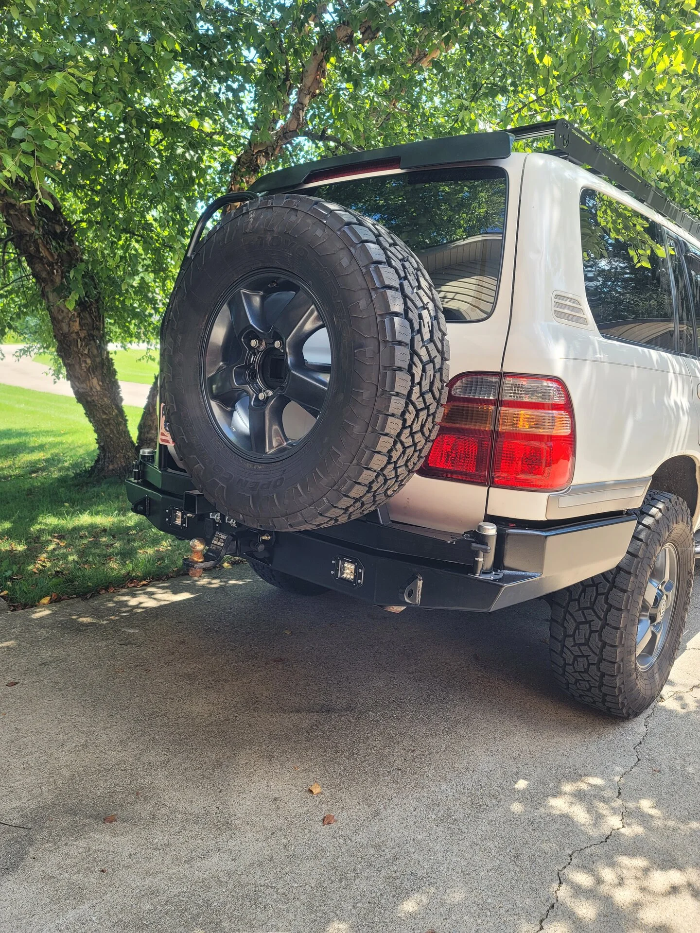

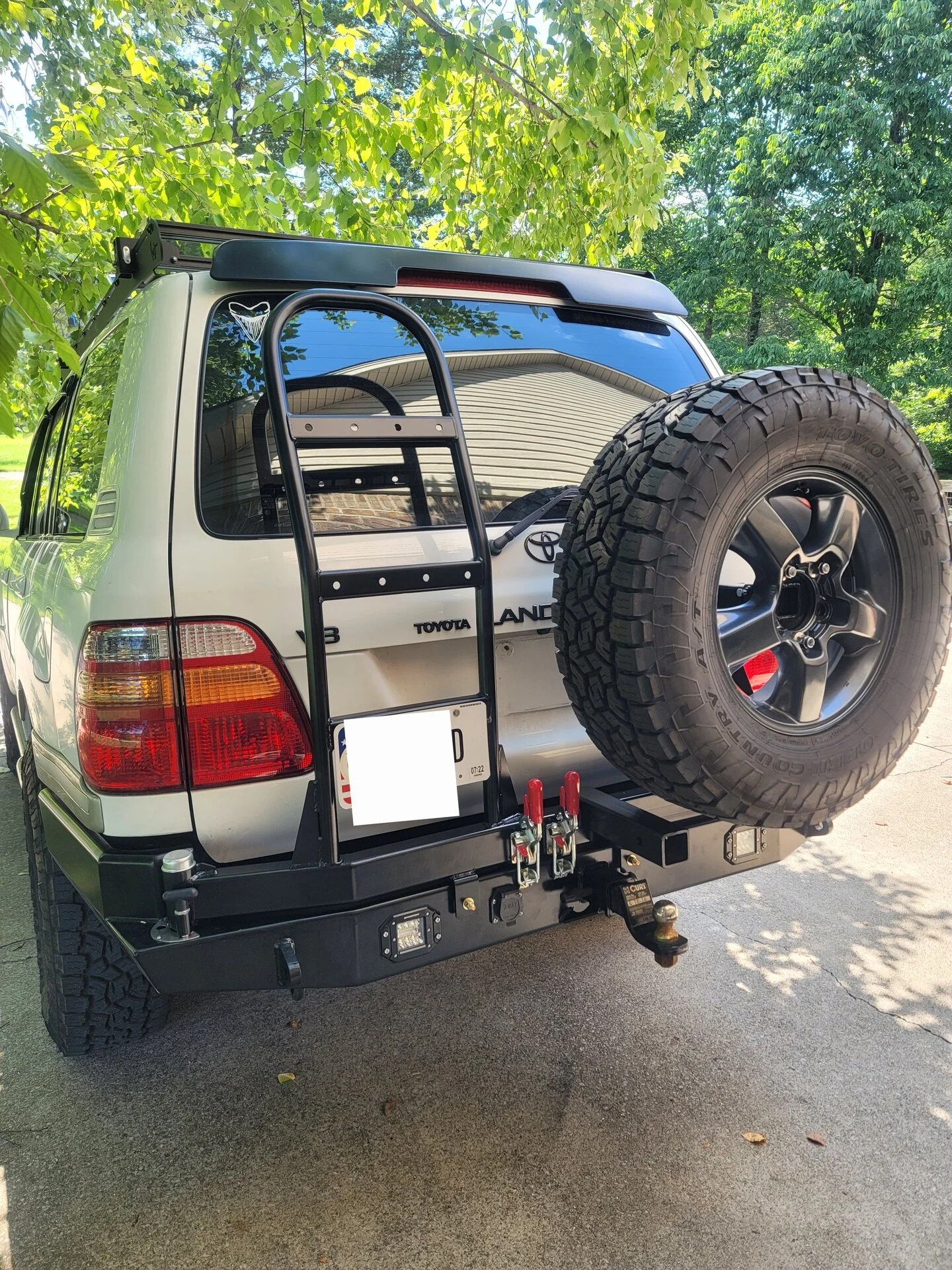

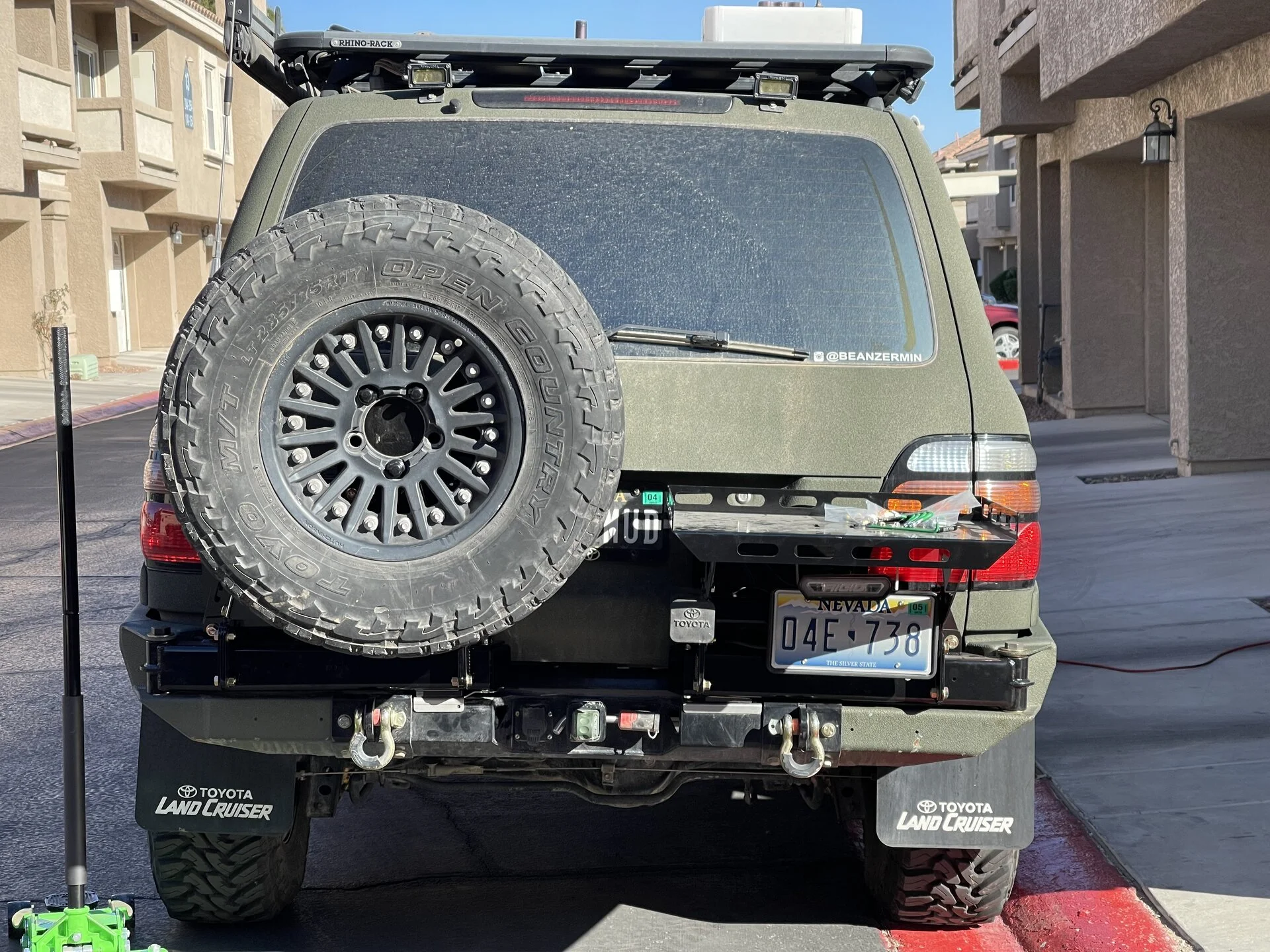

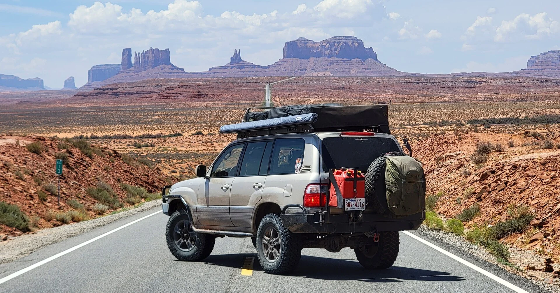

You got a heck of a list there. I went with a Valley Tech on the rear, had custom made to my specifications, pretty easy process, took about the same amount of time as most of them do. however I do have a slee in the front, was originally going to get that for the rear, but opted for the Valley Tech because I can customize it to my liking, saved about $1k, great customer service from a small business as well. If remember correctly I only had to drill two holes to get the bumper mounted.

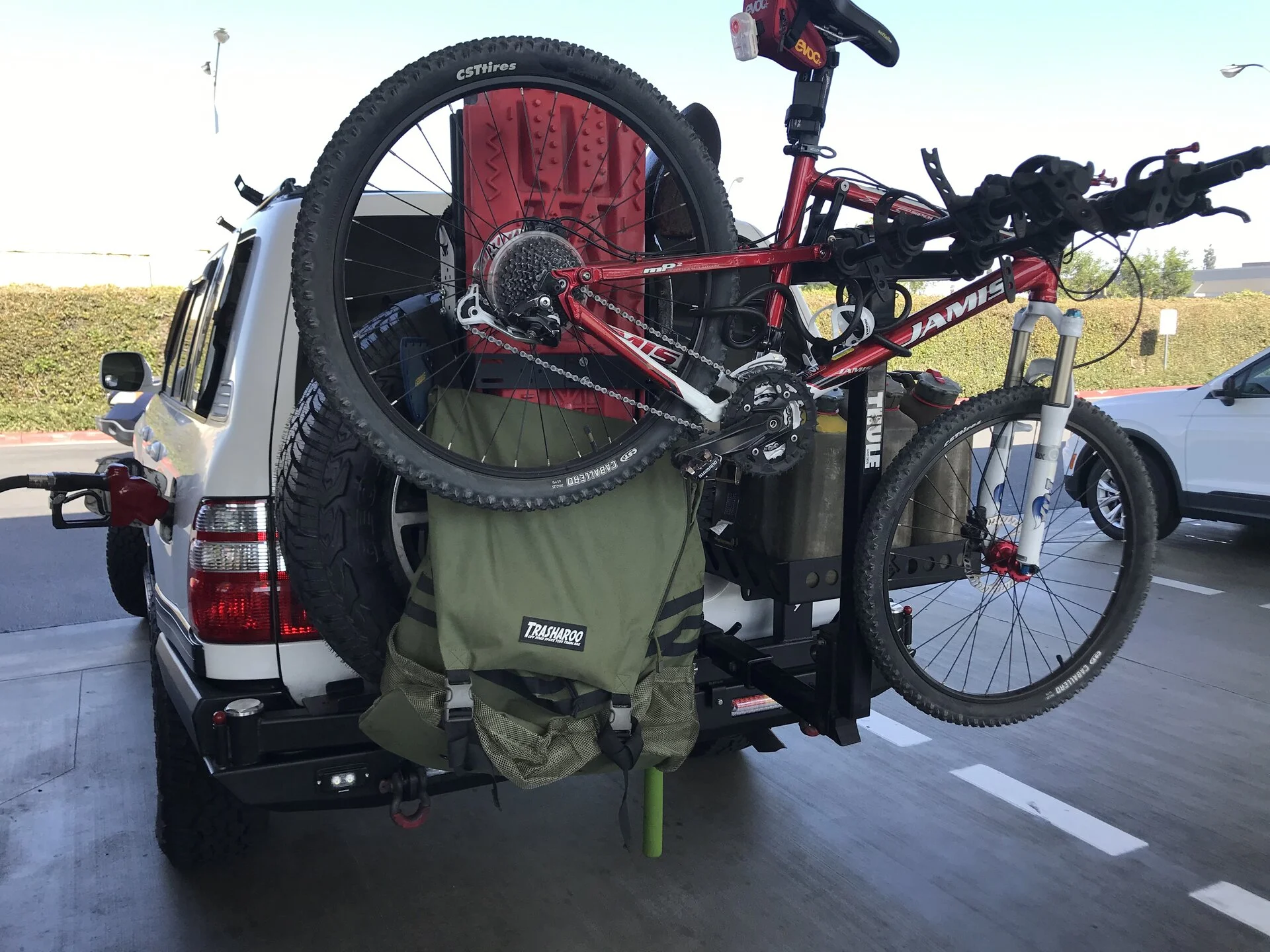

I added an extra receiver for a bike mount as well as a receiver to tow did a double swing out with a ladder and the tire that's on it is 34 in 18-in rim.

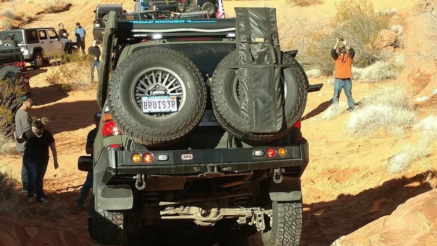

1) ARB - There is a ton of pieces to put together! Honestly out of the 2 bumpers I had it was the most solid and strongest bumper I’ve had on any vehicle! The biggest issue for me was it’s huge! I drug that bumper on every obstacle I ever took. It’s very heavy!

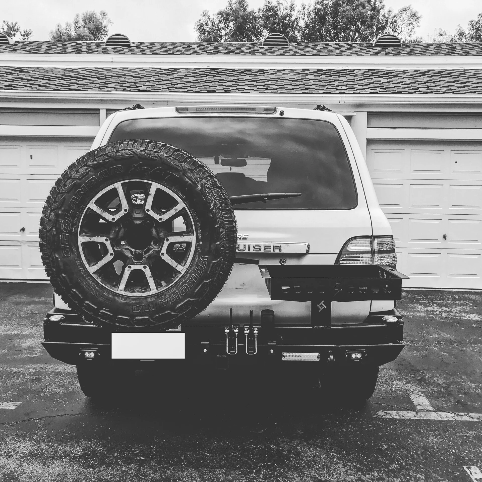

3) Dissent - He was one of the first people to start making bumpers for our rigs. He is also a 100 series & 200 series owner. He makes the best looking bumper in my opinion. When I had bought my truck that was the bumper I knew I wanted. Just couldn’t afford it at the time. So I bought the ARB’s. Which is dumb because 2 years later I turn around and buy the Dissent and remove the ARB’s. Cost me more in the long run. I’m not sure what other options you need from them. Comes with it all! Tire carrier has a table, a Hi-Lift Jack, License plate mounting and wire running. Easily paintable or to get powdercoated. Cargo tray has a spare receiver for mounting a bike rack or another tray. High clearance. Very rarely do I drag this bumper on anything. When I do it’s normally just the factor 55 drag link. The couple times I have dragged the side of the rear bumper on obstacles has taken it very well. Couple little gouges in the steel and nothing else. If there’s ever an issue Ben will take care of you! Good luck getting ahold of ARB for any reason!

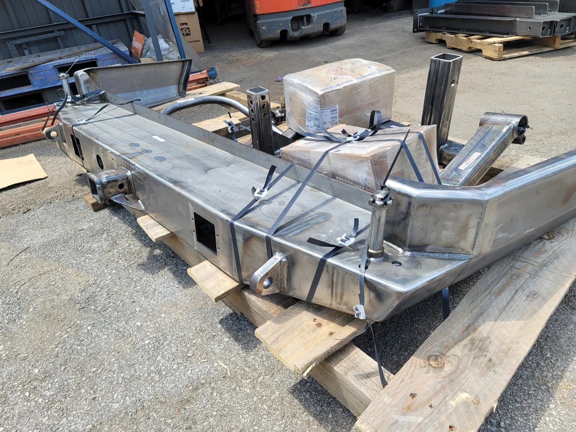

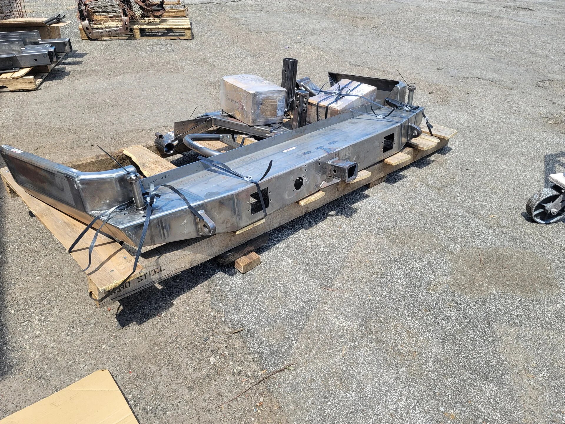

I paid a local welder to put together a Coastal rear bumper and powder coat it. It Turned out fantastic and I have zero complains about it.
It was still cheaper than all the other options and the quality is great.

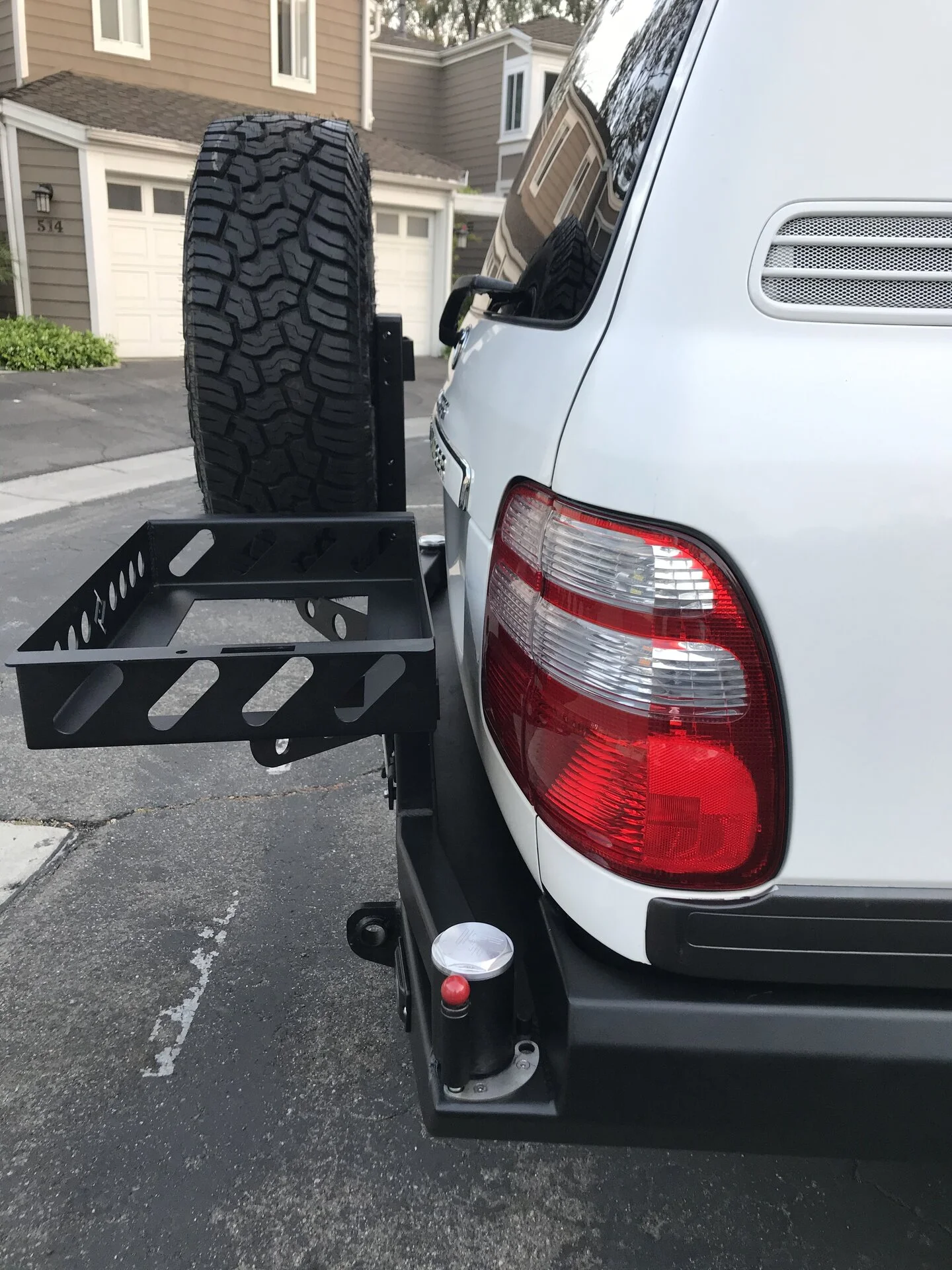

I really like Dissent's latching mechanism. I can just lean on my spare, and open the swingout with one hand while holding groceries/bags etc. Lots of good bumpers to choose from really.
