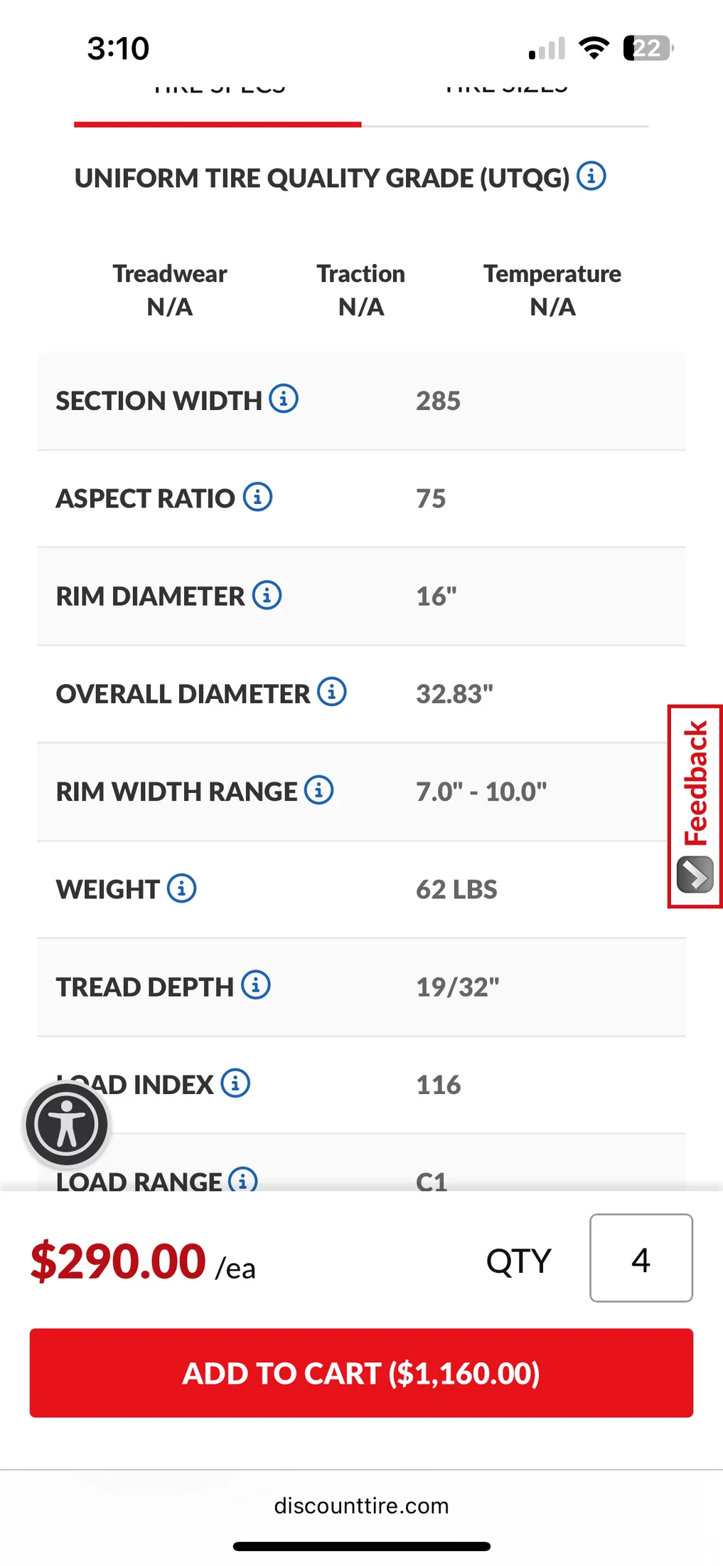

Toyo 285/75R16 load range C:
Pick your poison. Wheels/offset/tires/weight, but I’m using simple old school math.
